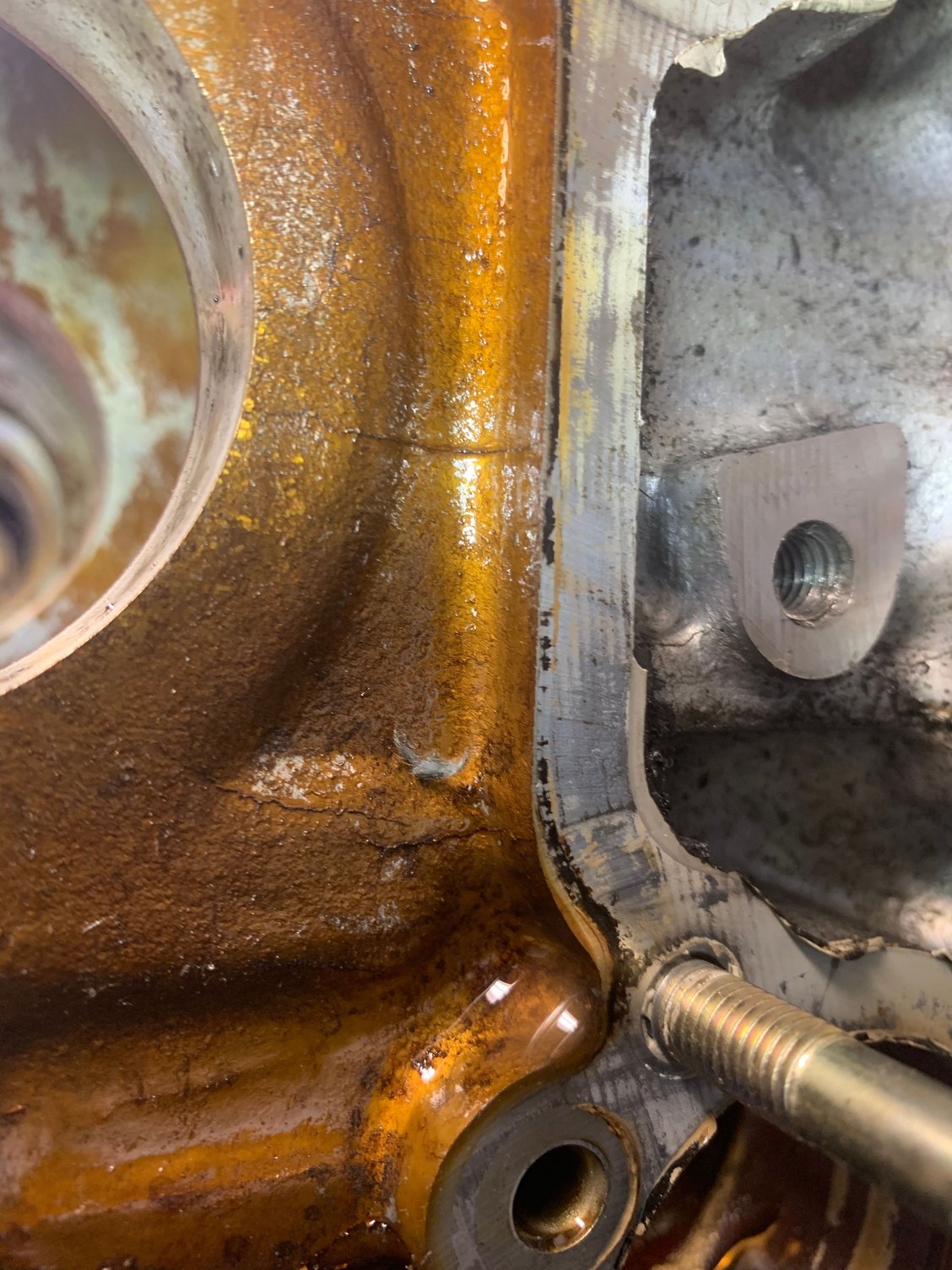

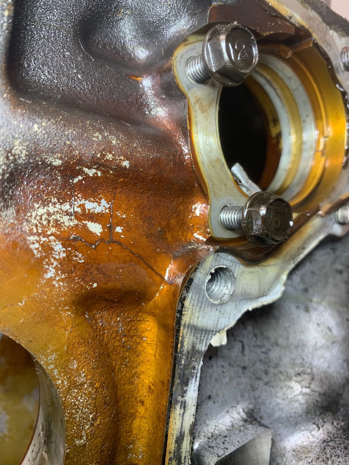

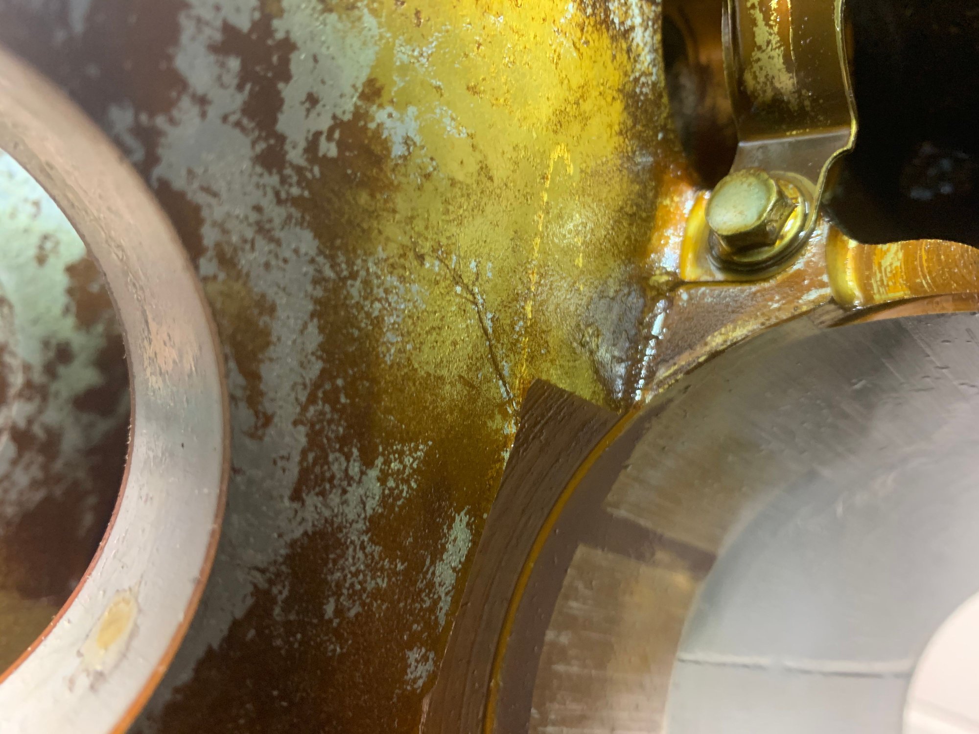

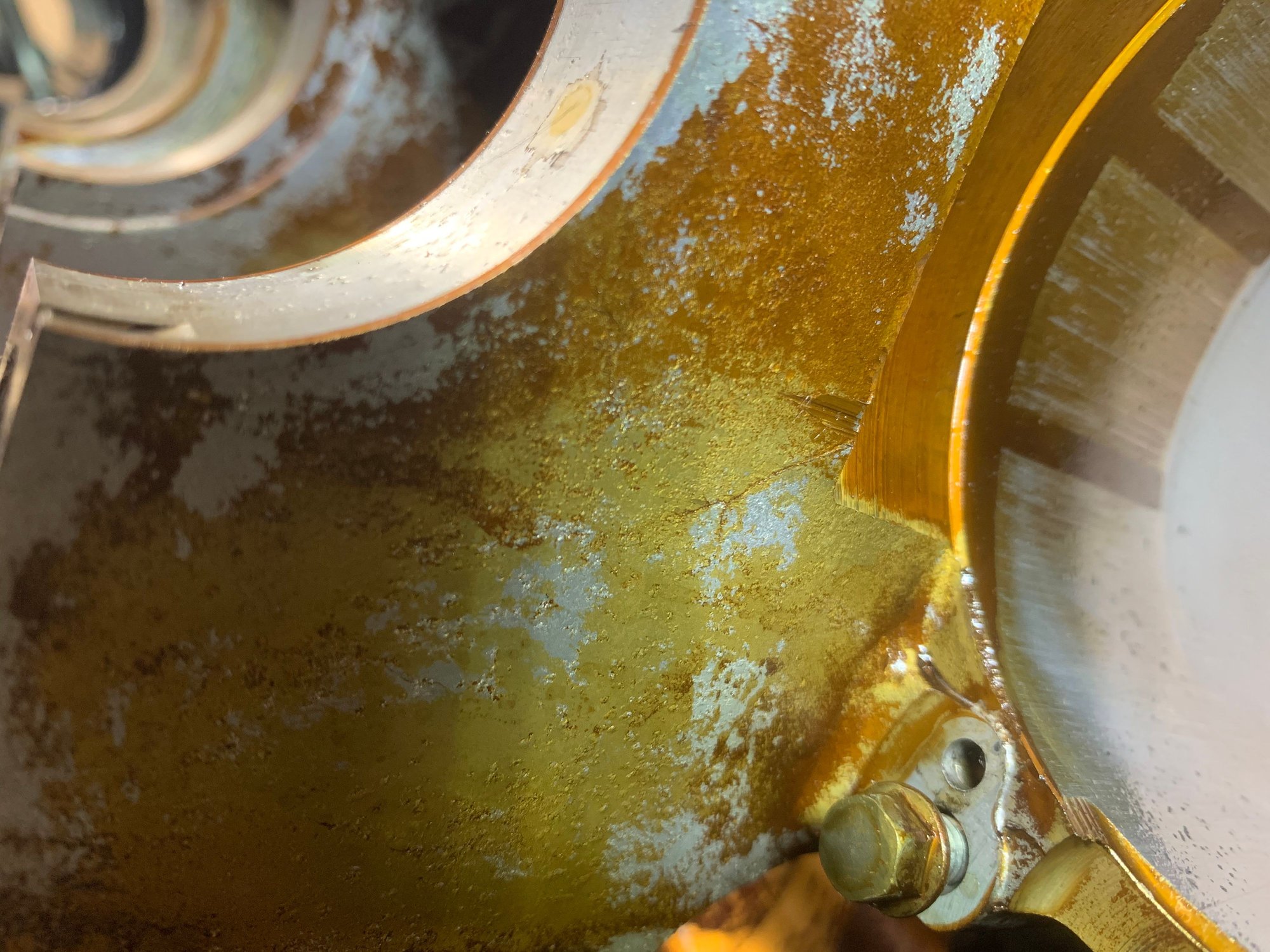

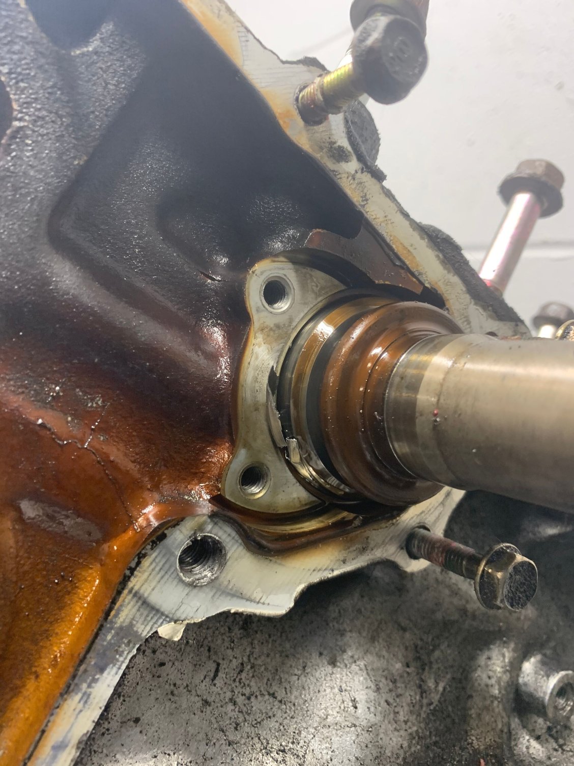

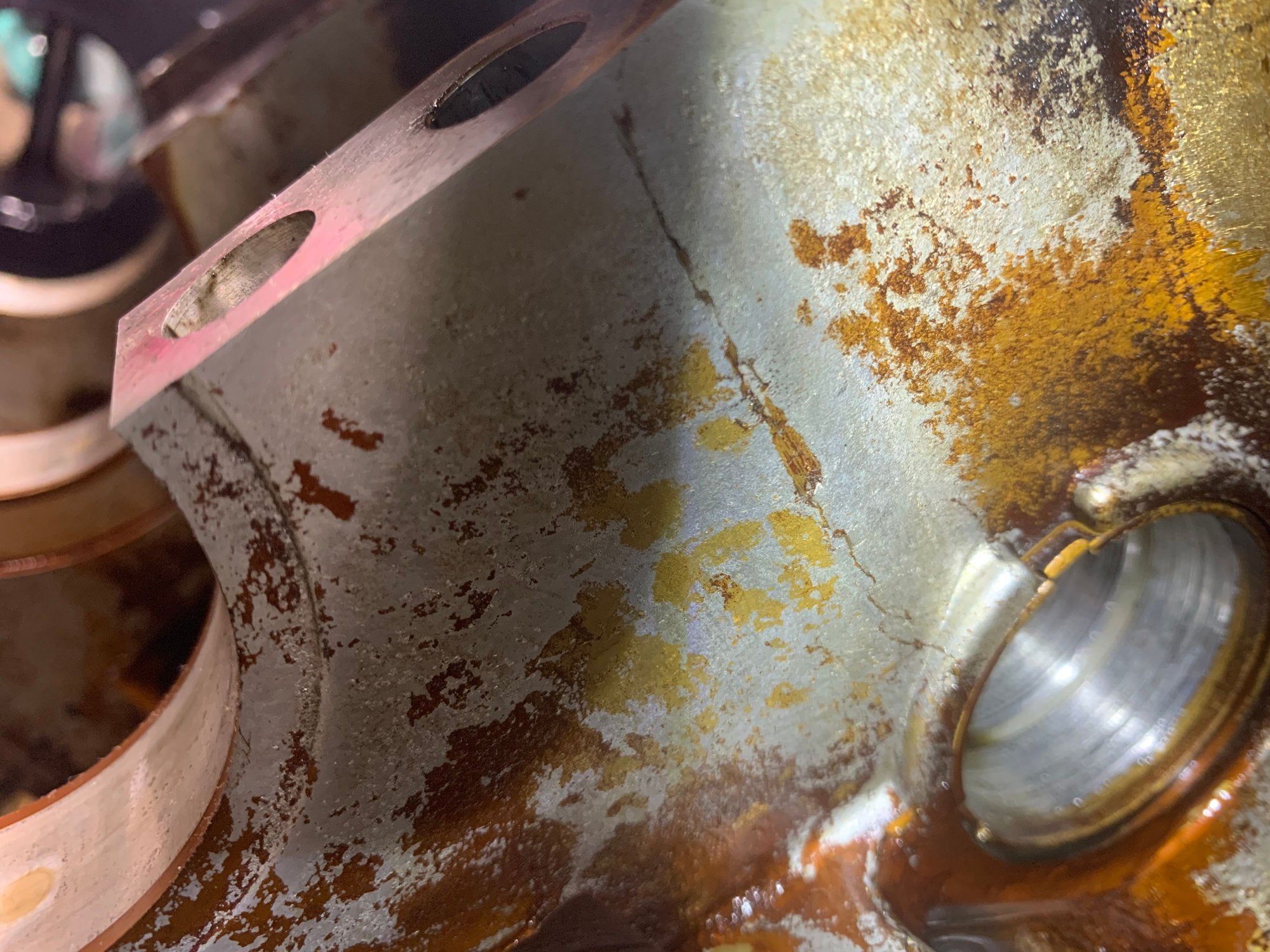

Hey guys. Let me know what you guys think
What would cause this to happen?

The cracks look like normal casting imperfections... but it is hard to tell. The damaged balance shaft bearing looks bad and MAY have caused some cracking directly around that opening. The balance shaft belt being too tight causes that bearing damage.

yeah all the cracks look normal. Just surface imperfections from casting.
The balance shaft bearing looks pretty destroyed. If you're gonna get the block sleeved, just get a balance shaft delete kit installed at the same time and you'll have nothing to worry about with that either

Agreed that a Balance shaft delete is a good idea on that block, but the rest should just be casting imperfections.
