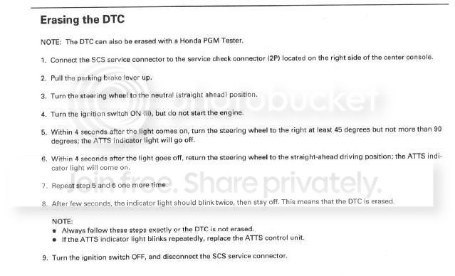

Has anyone done this successfully without the Honda data-link device only the dealer has?
Here's the manual way to do it, listed in the Helms. The light doesn't go out when I trun the steering to the right though .
