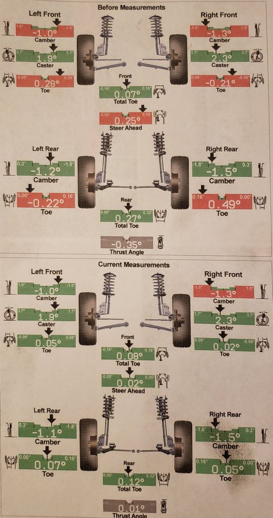

I had my 95 Prelude aligned today because it was pulling right, see attached alignment info before and after. The mechanic indicated camber is not adjustable on my car. The car is still pulling right a bit even after the alignment. Any suggestions on what could be going on? No accidents or harsh impacts and the UCAs are fairly new, ~20k miles on them.

you can get camber adjustable upper ball joints for prelude
