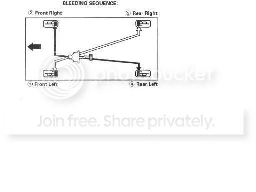

I thought you always start from the caliper furthest away from the master cylinder. The helms sequence is very different.
5g Helms:

yes i noticed that also. in the helms for a 5th gen it says lf, rf, rr, lr for a 4th gen it says rr, lf, lr, rf hehe i just follow the manuel when i do my diffent cars.

abs changes things up significantly as you can see.
turns out the abs unit makes the front lines significantly longer than the rears, just because they don't go thru the abs unit first.
the 5g is changed again because the abs unit is in a different spot

i figured following helms would be a solid idea thanks fellas
