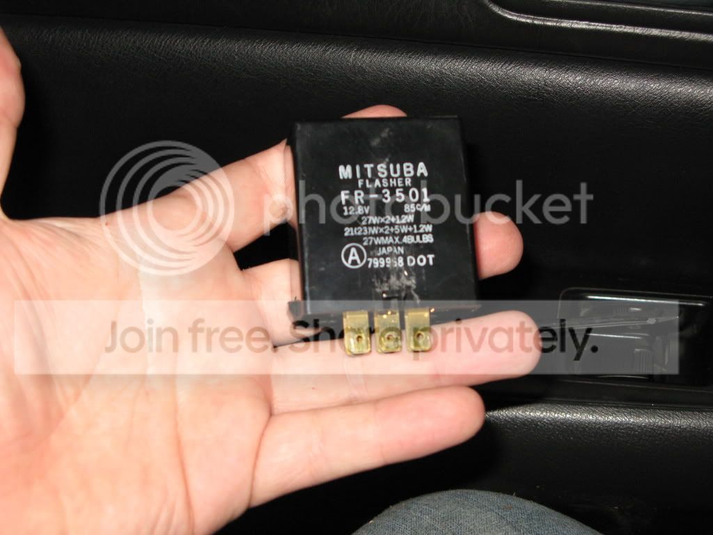

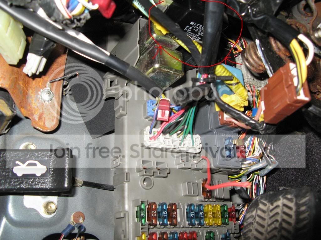

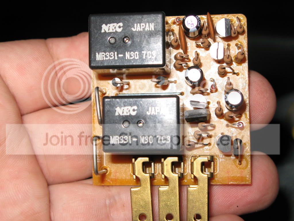

Ok i pulled the flasher unit shown in the picture.
Then i took it apart to see if i could see and visible damage.
I didnt see any damage but it did have that burnt electronics smell to it.
Being as its christmas eve no stores are open but i found it online here http://www.slhondaparts.com/br...0-013, which is $50 not $5. The only thing though now is that the hazards dont work with this out, so if this was broken would the hazards still work?

There may be two different circuits built into that flasher. I'm putting my money on it's just a bad flasher. And yea 50 bucks is crazy. I would pay no more than $12
