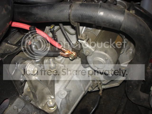

Old Nov 8, 2006 | 08:33 PM
lude98SH's Avatar
Posts: 2,801
From: Drexel Hill, Pa, 19026
Default Re: Battery Relocation (98vtec)
What gauge wire is that ? How did you run it to the fuse box ?
