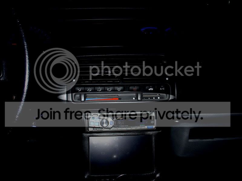

For some reason part of my AC lights quit working. Its the ones that light up the temp slide bar and setting slide bar.
I checked to make sure the connectors were still plugged in and they are. The weird thing is that the other AC buttons light up just not the 2 slide bars. Is it just the bulb or something wrong with the unit?
