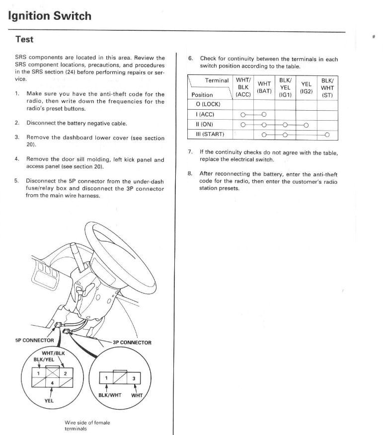

Old Oct 7, 2022 | 04:02 PM
1992BB2's Avatar
Joined: Mar 2017
Posts: 62
Default Re: 98 prelude wont start none of lights on dash turns on??? help
Originally Posted by Trxrc
I have the exact issue, windows stopped working and dash lights also turned off and my windows dont work but the rest if the car does it wont start however.
Did the ignition switch fix that?
It sounds like it could be a bad ignition switch. But test your ignition switch first to be sure:
