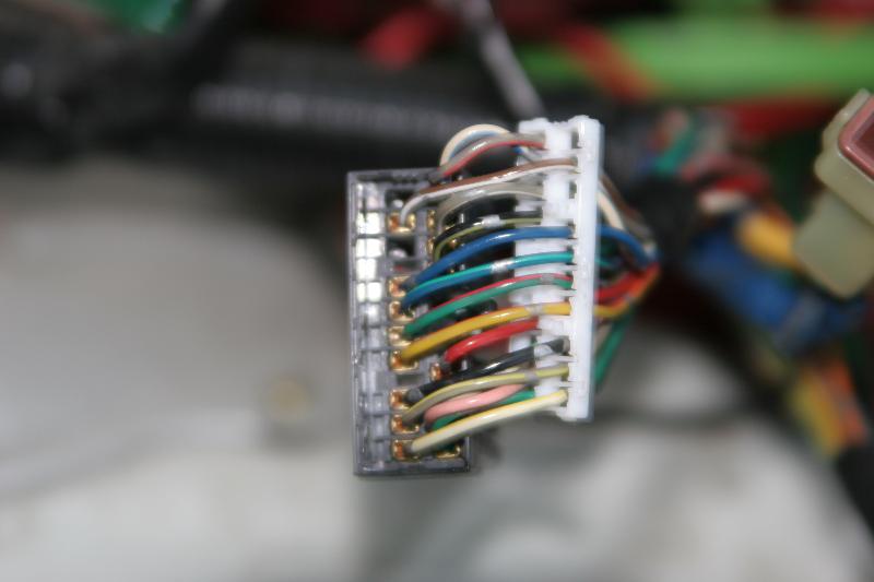

Hi guys, heres my problem:
DTC: 74
Driving the car with the parking brake ON. ON 5 minutes
after detection
I can drive for 5mins with the 4ws light off and as soon as it detects the 74 error the light comes on. I am not driving with the parking brake on.
I have pulled the 4ws computer plugs and found the green/red wire which goes to the park brake switch and tested it with a multimeter. It is functioning properly.
The park brake wire is grounded when the park brake lever is in UP position, and the circuit is broken when the brake lever is DOWN.
I then pulled out the pin on the plug for green/red effectively making the 4ws computer think that the park brake is never on. (why does the 4ws system care if you're driving with the park brake on anyway?)
I then took it for a test drive, and same result, after 5mins of driving I got error 74.
I am assuming something is wrong inside the 4ws computer?
I did the "4ws solder dry joints" fix about 2 years ago and have had no troubles with 4ws until now.
Any thoughts?

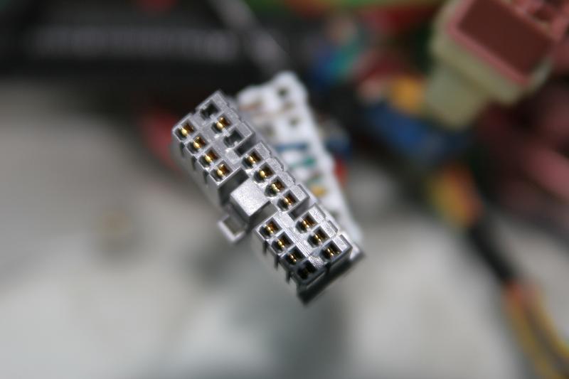

This is the 4ws plug and what you need to do to pull it apart.
