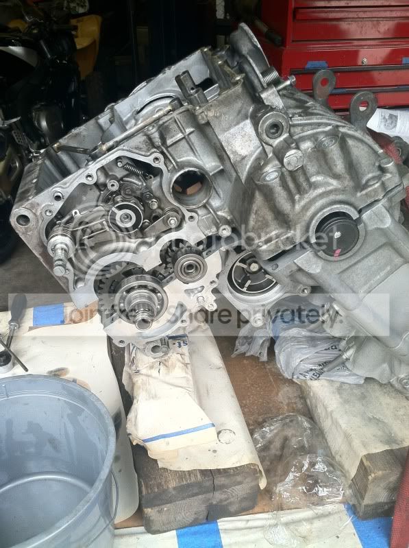

i have everything apart down to where the problem in the shaft off the alternator that clutch sort of thing when i lwly turn it it binds up and jams fully at sum points, so i imagine when the starter tryed spinning it it just wasnt engaging. it would cause the bike to make a wicked loud grinding kindof clunking noise
im pointing at the bearing or whatever holds the starter gear it self in how is this removed??
this bearing seems to be no good or no ? compared to the on pic before^^^^^

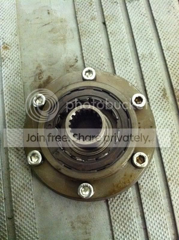

here u can see the clutch assembly thats connected to the alternator this seems to be binding up and has to be whats causing the starter grabbing / clunking noise how any clue on what this part is

as far as the problem goes ive narrowed it down to the generator shaft one way clutch initialy it would grabb and hold and cause the crazy clunking grinding noise

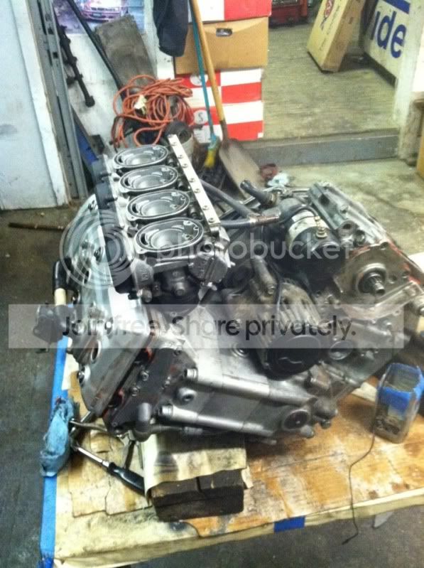

heres an update for everyone hopefully ppl can throw some thoughts out any input is helpful
so i started the day off right witha smoke a a coffee lol
after a busy week gf problems and the holiday weekend it really slowed me down but i got a bit more done and figured to share..

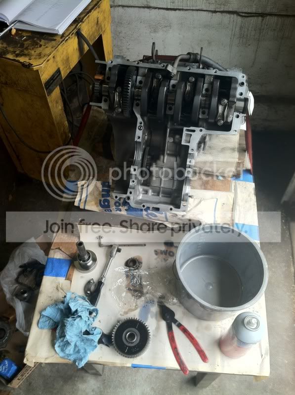

i got the generator shaft removed from the case a little tricky since the pins and washer come off the internal part then unbolt from the outside part
of the case where the alternator would go
then everything easily pulls right out ,,,
after i removed the one way clutch assembly i noticed its gear teeth seemed pretty worn ? or maybe this is intentional im not quite sure and figured you guys could help me out please:smile:headscratch:smile
Also the shaft that the clutch slid back and forth on had slight marks on the teeth but only in one small spot i tried getting a photo but it may be hard too see
few of the boss' toys and a shop shot lol a bit of a mess nbd though
heres the whole generator shaft together outside the case THE PROBLEM is someting to do with this one way clutch anyone kno how it operates ?
had the motor on a tire and carboard for the first day or two removing stuff but once the caes were opened it had to be in kept up and out of the way so i made myself a little operating table secured it down with a ratchet strap to avoid any accident when im not there god forbid (prior experience when building my civic) also put it up there and started cleaning the grime off and old gaskets
removed the valve cover after cleaning and noticed the new cover gasket and the internals seem really new

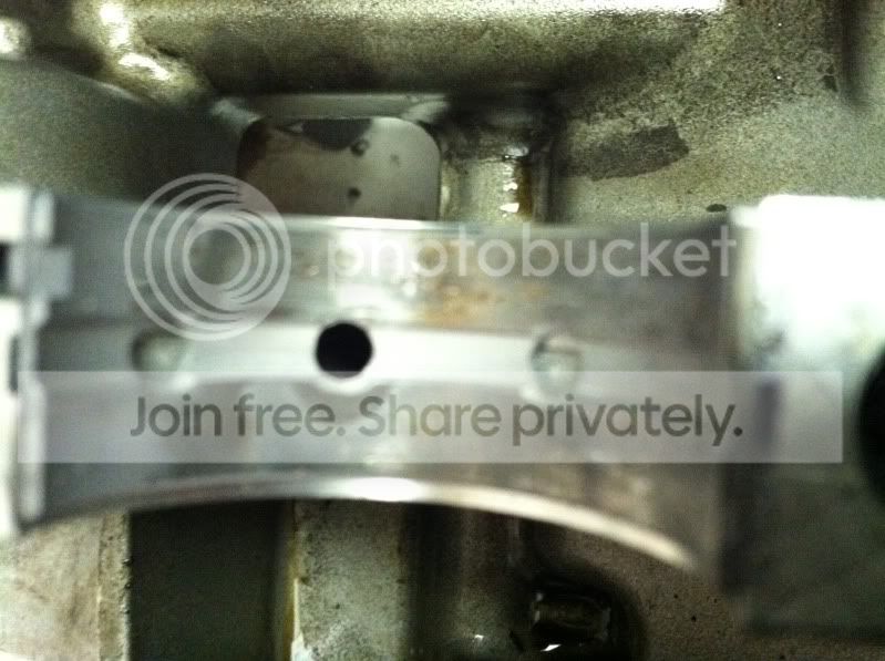

POSSIBLE PROBLEM

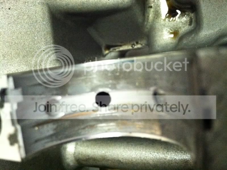

i noticed today a bearing journal is in different compared toall the others can this cause major problems? what should i do about it

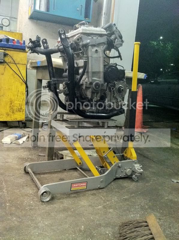

bump this got all the parts this week 400 later off bike bandit i
will hopefully have motor in bike by sunday

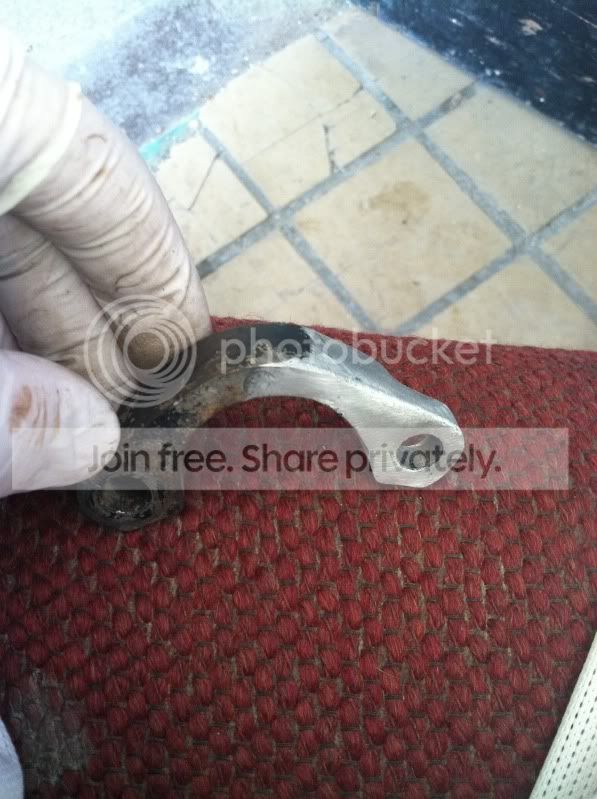

i also decided id give welding a shot and i think i did alright the thing worked and didnt dbreak albeit my weld look like a rape scene

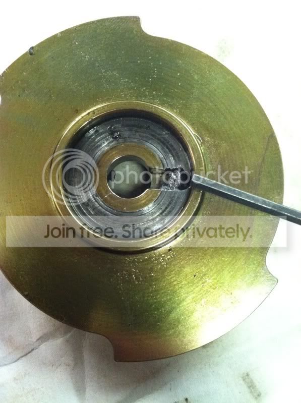

so i was looking at my timing advancer and noticed it had sum play in it even bolted tightly it wiglled slightly so of course i unbolted it for a closer look and found the old on was what look like hammered into the crank and all screwed up ,.,., ive already went and bought a new pin im curious though how it is installed the haynes doesnt help and google wasnt much better anyone have any experience installing this pin?
here u can see where the old pin was
here u can see the timing advancer has a nick in it now

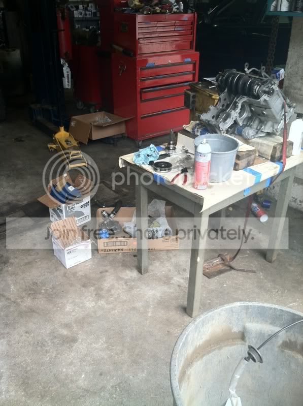

i have received all my parts need to attemppt the final build,.,.,. i went ahead got alll new gasket throughout the motor and and bearings and seals the had even the slightes wrong feel about them ,.,.,.,., bikebandit . co m is very good and very fast will be using them quite often from now on .
the biggest thing with rebuilding this and reinstalling the case was prepping the surfaces to mate up and using very little a silicone gasket to help make a nice seal ., i took not of where the forks were on removal so when i re installed the case the shifter forks went right back into the correct spots,
also i pre lube everything and make sure theres no dirt residue we have a wash tank with zep cleaner stuff is great at the nasty **** the buins up on the outside of the case and the heavy oil at the bottom of the pan
heres the SOB that caused all the headaches
heres the cases in place anyone with a keen eye may notice the gasket missing lol yeah i figured it out to about 1 minute after the pic lol :bugerit
and here is some random photos ive taken to switch it up on u
(nextphoto was taken from @freshonstanceandofffset face book page)
back to the bike :lol: :D

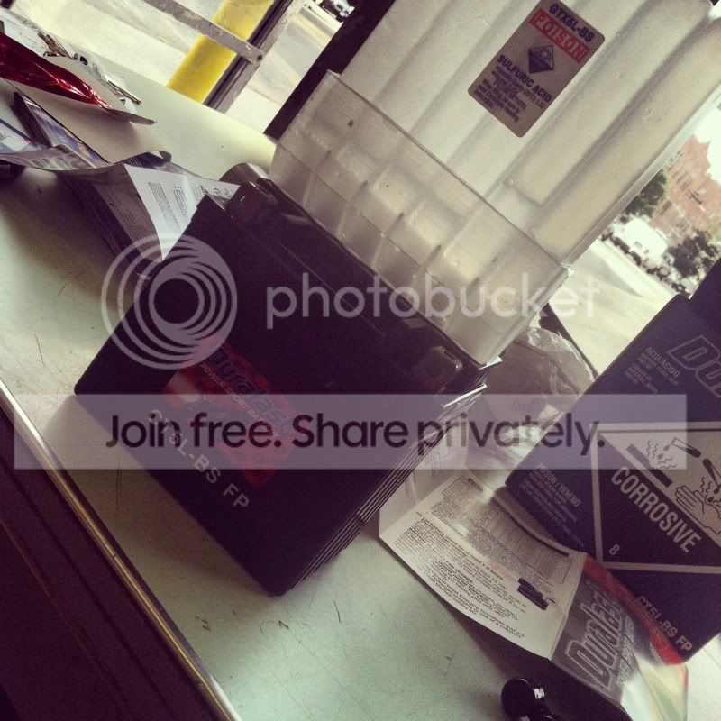

this was a first for me having to do battery acid and charge its very easy though i can only imagin what it was like for ppl back in the day when it was routine
here i decided to just get the generator and starter in before installing it in the bike
my last pic before i got it in the bike all alon so snapping pics was not an option but i will post them first thing tonight
i had started around 7 pm left the shop at about 2 am =0 :evil: :evil: #dedicated lol

so ive come across a bit of a problem the spring pin or dowel pin on the end of the crank has busted off .,., i have the ability to drill the old hole out and have areplacement pin already to go into the bike but im not sure / inexperienced in installing this type of part before i hope someone could maybe lend some knowledge

anyone wanna share thoughts i dont mind lol 1500 + views im in the process of thinking of a new color any thoughts?
update .,.,., i am still curently stuck on the spring pin install im going to get it though to determined not to ,.,.,, also waiting on a generator shain tensioner has a lil crack in it and was hard to get back into place like the spring inside imanagaed to fix it but its in the bike as a temporary peice just so i know where the parts goes

update
so i went through several pins before thinking of two ideas well one new idea the other was brought to light on here in previous post ,., my first idea is i went and bought long pins with hopes the angle it goes in at wont be affected as compared to the smaller pin, if it works i will use a cutting wheel to cut to proper length
the other idea weve discussed is a final resort and will eventually look similar to my little sketch ive drawn

update ,., well besides for the god damn pin problem lol ive decided i will get everything else buttoned up as far as wiring (what was left) , radiator ,headers, a clamp i had broke on removal i had welded up and cleaned up nice ., going to go as far as possible tonight , will take many pictures as always and also hopefully install this pin and then i will be on to installing the chain tensioner and, that will allow for me to install the clutch plates and stuff and all the covers and i will b good2go sort of lol
does any one have any experience with the unniversal spark plug wire kits ? im not quite sure how i go about wiring these up i figure it has to of been done previously ?
heres the repaired header clamp
#-o
TO DO LIST
~repair clutch piston seal (i pressed the clutch with it removed ,.,. yeah dont do that )
~ install chain cover
~install water pump(still have to fix that shaft problem )
~ remove and reinstall new chain tensioner
~figure out spark polug wire situation
~install roll pin "spring pin" and timing advancer (still concerned about it being +2)
~install radiator and fix lower mounting brackets (seems to have damage from when the bike was layed down by POS PO )
~theres some wiring issues also just need clean up connections and tape certain spots. (alson have the ground wire coming off the harness and a thicker wire i forget where it goes it seem like it connects to the frame/motor sumwhere i wil get a photo later tonight)
~ while i am there make another to do list LOL :lol:

CSo i have a 94 9r and i was tryin to start it one day it mad a clunking noise then the starter just started spinning freely ,., i went about splitting the cases an replace every peice i could tell was broken i thought i was as **** about it as possible ,., jus got everything back in and before puttin the clutch cover on and stuff i gave it a quick turn over(or attempted to at least) and the starter is still just spininng im bafffled /:
-- bike didnt have fluids other than assembly oil on all parts
-- i tried reversing Polarity on the starter motor sounds anout the same
---does the starterr one way clutch need the motor full of oil to operate properly ?
-- is it a starter motor problem ??
---- anyone have a properly funtioning motor for sale ;(

bump ttt hope sumone can lend sum thoughts,.,.,..,., have it back together but it seems like the clutch hub/ flywheel doesnt wannna rotate enough when the starter is turning the chain assembly

After all that BS the 9'r does not fire up for you?
I would try to bump start it. Find a nice hill or a few willing friends
and let the clutch fly in 2nd gear.

it has the ability to bump start it i tried tonight it had no gas but i could hear the motor turnover thru the exhaust .,., my brain is boggled lol im stuck to beleive it has something to do with the clutch or clutch release pistonor sumin in that assembly
if i attempt to start it the black gear hub trys to turn sliightly but not alot ,.,. the inner chain spins fine ,., its why i think its clutch related
