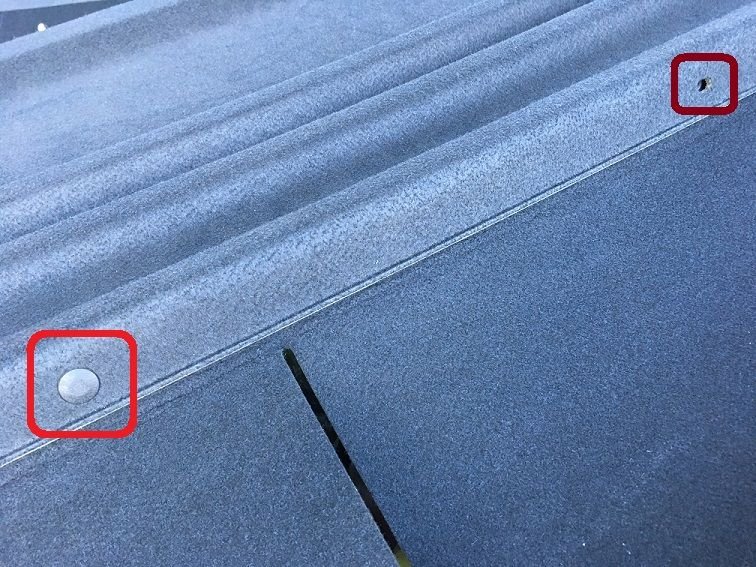

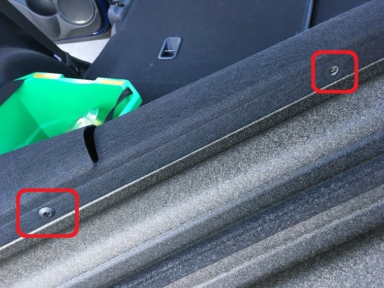

I have a 2013 Honda Fit cargo cover (http://www.hondapartsnow.com/accesso...rgo-cover.html). One of the pegs that holds the fabric part to the stiff part seems to have come off:
Far view from the top side:
Close view from the top side:
Close view from the bottom side:
Honda says that the peg can't be obtained, and the entire cover needs to be replaced, at a cost of more than $300 Canadian. The parts expert said that I might be able to find a blind rivet for it at a local crafts store, but they only have "eyelets". The unique feature about the pegs is that, relative to the shaft, they have a big circumference contacting the cover. All the better to distribute the force, and make it less likely that some inadvertent force will damage the material.
I still have the bottom piece, but not the top piece. From what I can see, I believe that the shaft is integral with the top piece. In fact, the shaft looks like a pair of legs that reach through the hole, then snap outword to hang on to the bottom piece. This doesn't seem consistent with what I've found about blind rivets or eyelets online. I haven't been able to coax apart any of the remaining pegs for closer examination, but then I haven't tried very hard for fear of damaging another peg.
Does anyone know where I can get such a peg?

Go to Lowes or an auto parts store and look for automotive plastic clips. They come is various shapes and sizes. Although it won't exactly match the color and be identical to the clip on the Honda Fit, one or more type should fit and hold.
For example, this is one style that probably will work, just find the closest matching diameter. This is just an example, they have other sizes too.
https://www.lowes.com/pd/Hillman-Var...for-GM/3012788

Yes, the 'bottom' part of the rivet is male, the top piece is female.
Start shopping websites like mcmaster-carr for what you need.
It's like a snap, you put one side over the other and press it into place, and the male part expands into the female part and mate.

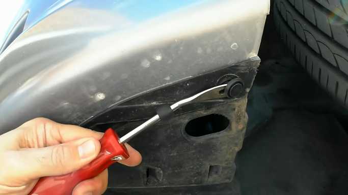

Look at the honda black plastic pieces that hold your fender liners and front fascia onto the car. They come in several sizes and look like the would work and very cheap BUT black.

@tech8: I will try your idea of going to Lowes (and Canadian Tire). That way, I can even carry the cargo cover with me so that that staff will know what I want to do. I don't want to order online, because I want to be able to see the mating plastic parts, and to get a sense that they are right for the job.
@Caoboy: You described it well, but the top part is the male part, as it has the twin-leg prongs that feed through the material to be held together, and the round plastic piece on the bottom side. I'll go with tech8's idea of visiting local stores because I want to examine the candidate solutions and get a sense that they will do the job. Thanks.

You don't have to pull anything apart LOL a simple screwdriver is used to pop out the center section and the thing then can be plucked out with just your fingers.

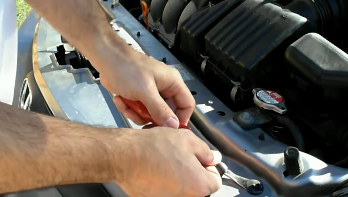

Is this what you mean?
It seems a bit tricky for the confines of an underground parking spot. I gave my ramps away many years ago.

That is where they are located both front and rear. BUT you don't even have to take the car apart to buy some. Just go to a Honda dealer and ask for them there are 3-4 sizes but they get replaced so often the parts guys will know what you want. I THINK you need the smallest diameter ones.

I noted in the video that they had clips on the top side and bottom side, thus accounting for two sizes:
I assume that the rear bumper might account for additional sizes. I'll send the pictures to the parts guy to see if he can order the smallest.
