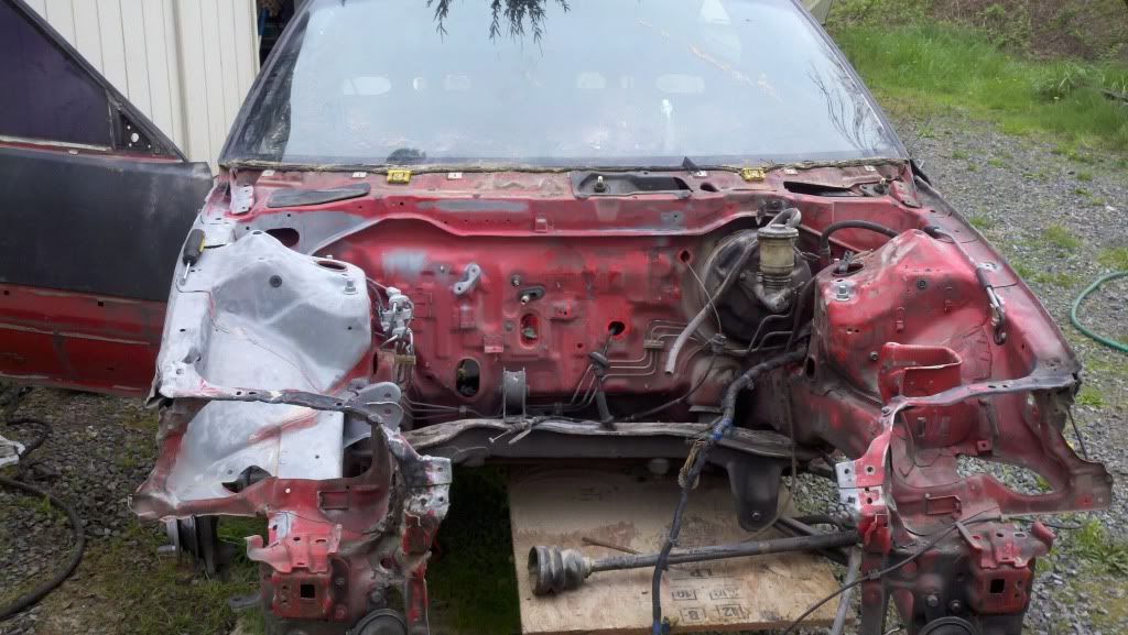

I was planning on making this my project car but then found out it had a reconstructed title so I hopped back on craigslist n found a crx that they only wanted 1k for with a y8 (vtec) engine swap in it and a clean title, body was a little rough but I just was happy to have one with a clean title. So I went to take a look and the kid took me for a ride in it n it ran like dick. I told him I'd think about it and they were trying to part it out anyway so a few days later I asked him if he'd take 200 for the shell, he said sure and thats were i started.

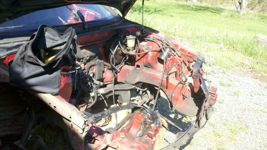

When I got it they really gutted EVERYTHING all that was left was doors, hatch, windows, heater/ac boxes and a really hacked to **** wiring harness that had an alarm, vtec, breathalizer, and what I think was the dpfi to mpfi rewire job lol, so I set to work on gutting the rest of it to get it ready to do a full paint job. Will post pics in a sec once I figure out how lol

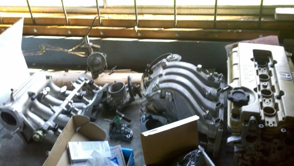

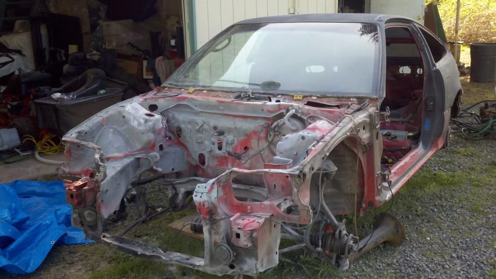

This is what I'm starting with
B18c1 block I picked up for 300$ Took it to the shop to get hot tanked, bored to 81.25 since there was some rust build up on the cylinder walls from sitting in this guys garage so long. I picked up the head for 200, no cam gears or cam cap bolts :/ and gsr usdm cable tranny so I dont have to deal with the conversion for 250$

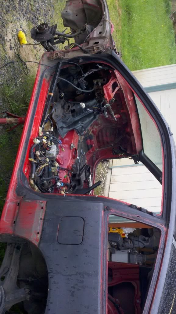

Gutted the old hacked up dx wiring and picked up a new 91 si (mpfi) harness from picknpull started to lay it out and get started on the rewiring.
Rewiring in progress shouldnt take too long only had door wiring and the wiring running toward the back chopped out.. matched color to color and ended up witha few spare green wires... Guess I'll find out what theyre for later lol

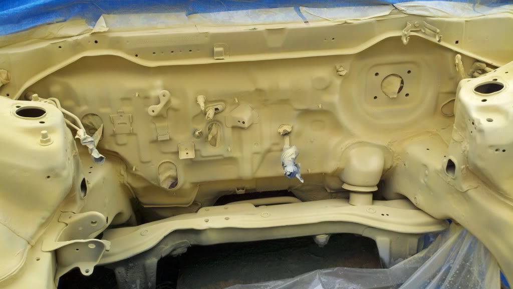

Figured while the wiring was pulled outta the engine bay I'd clean it up n prep it for paint
Pulled the break lines out (carefully) so that I could sand blast around everything and get it primered.

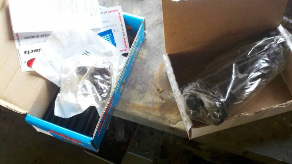

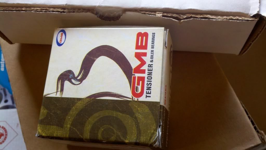

Got my packages today! Arp Head studs, new head bolts (not sure which im gunna use?)
New tensioner
New oil pump
Packages got my timing belt, gasket kit and everything else for my rebuild just need new 82m pistons, rings, mains, alternator, cam gears, and I'll b rdy to drop it in (once I get my block back from getting bored)

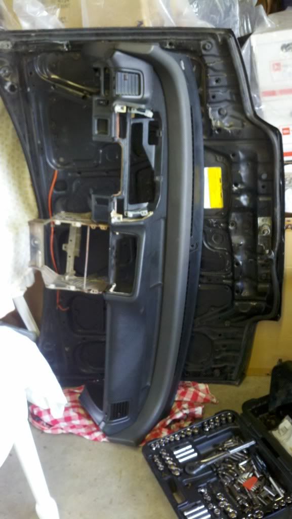

Some random pieces I got to go into it once its all ready to put together
Dash
Everything that came out of the car when i got it, shitted up seats, the side skirt that r still in pretty good shape, and some random plastics

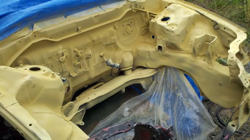

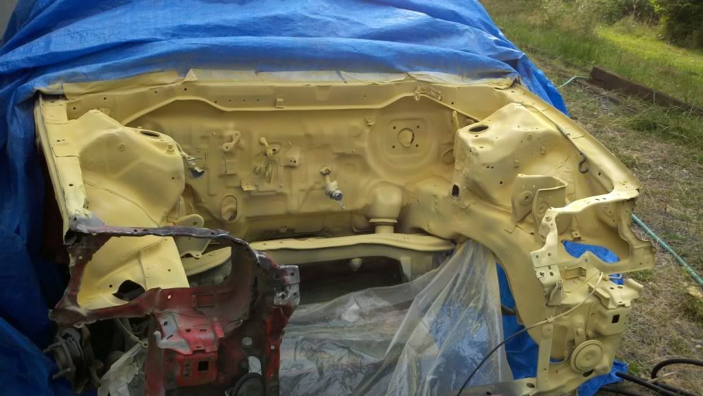

Default Re: My crx build (starting from a shell)
Got the engine bay all primered now just gotta cut the front headlights off n replace em they bent to **** n someone tried to tack em back on horribly
