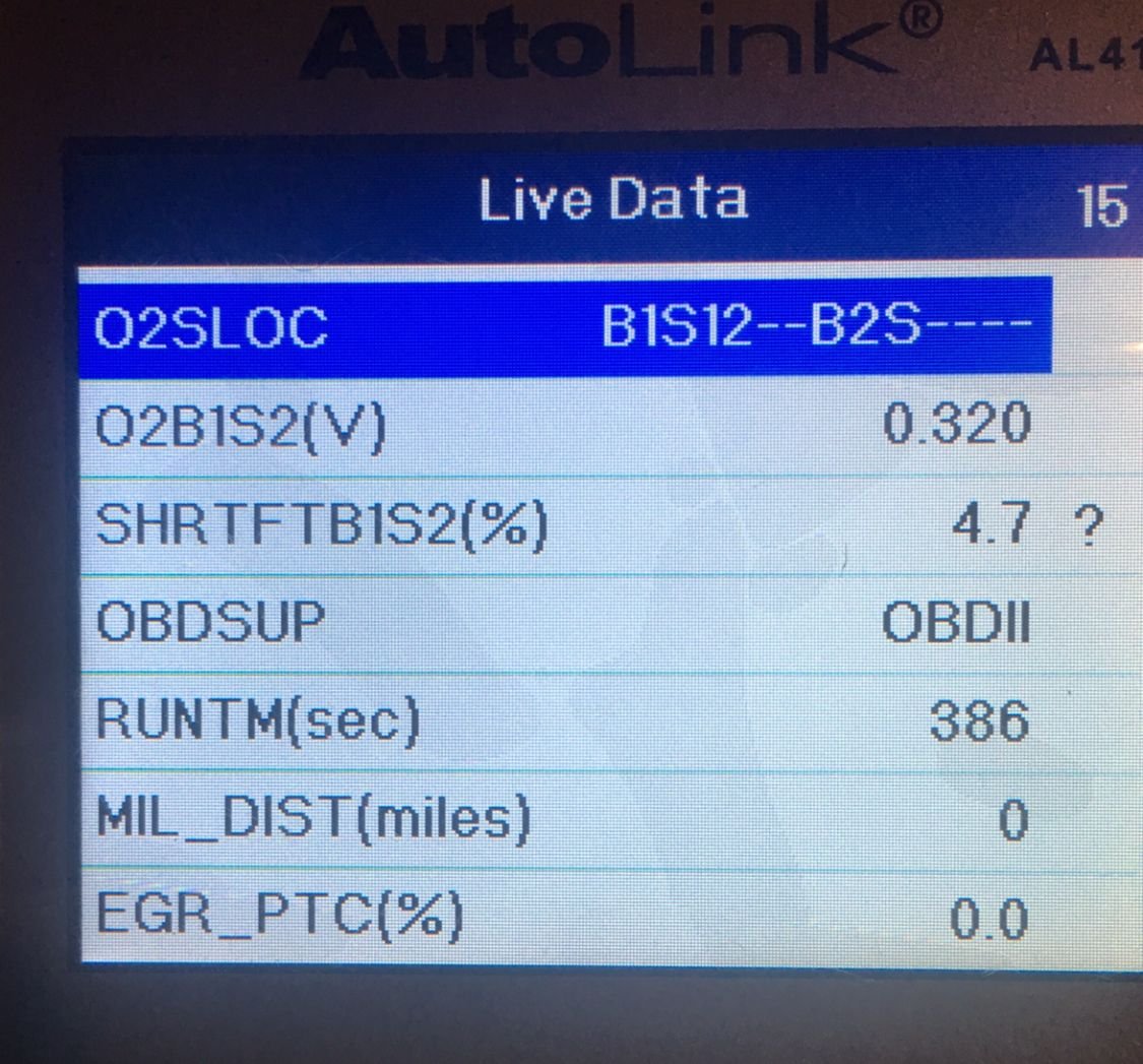

I’m wondering if this will improve after more driving? I also re-ran my OBD2 test and noticed bank 1 sensor 1 was missing. I’m not sure if it was there before to be honest. Maybe it’s a bad sensor otherwise?

For some reason it's pouring fuel in to the motor. 02 sensor is just confirming that.
You need to get hooked up to a live scanner to see what else is going on.
