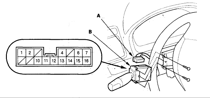

You could bypass the multi-function (combination) switch by jumping the appropriate circuits. There’s a 16 pin connector behind the steering column area.
If you jump the circuits and everything works correctly then you need a switch. If not, I would start looking at the connector for damaged wires, terminals, and the ground.
The ground for it is behind the glove box, on the left side according to alldater.

This will probably be very difficult to find the short. Earlier today I also considered some tests to rule out the combination switch; but, concluded it probably will not be due to the combination light switch. At the switch, turning on the headlights sends a ground signal (-) through the circuit. Turning on the turn signals, sends power (+) through the circuit. So, even with a faulty combo switch, it should not cause what is happening.
Turning on the headlights does send a ground (-) to the taillight relay, which then allows power (+) through the taillight relay to the small light circuit via the Red/Blk wire coming from the under-dash fuse/relay box. There may be a short in the Red/Blk wire(s) to the left turn signal Grn/Red wire somewhere along the Dashboard Harness A. The commonality of the Red/Blk power wires (+) and the Grn/Red power (+) wires are part of Connector L which plugs into the rear of the under-dash fuse/relay box.
