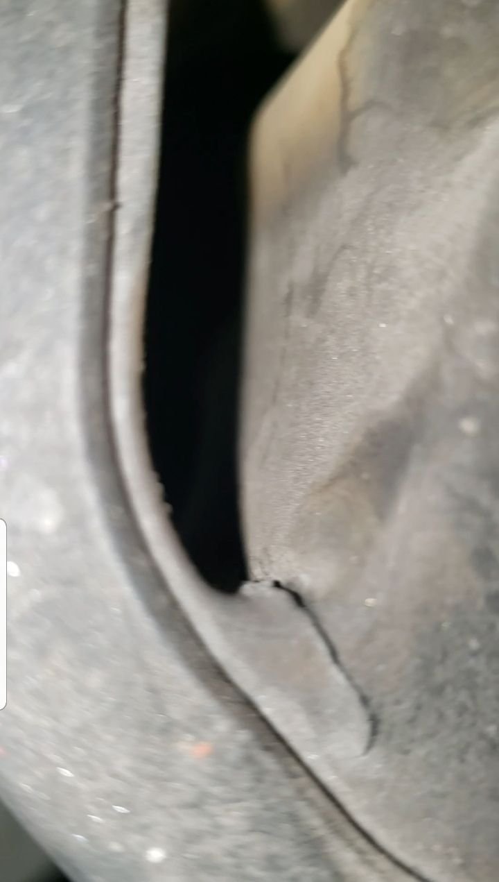

Old Dec 8, 2019 | 05:37 PM
PolkaSauce's Avatar
Joined: Aug 2018
Posts: 173
Likes: 9
From: California
Default Re: Another front end shake thread
So I removed my propeller shaft this morning and drove the car to work to see if I could notice any difference, thinking maybe it or the diff could be causing the shake, surprise surprise, no change. Good news is the ujoints feel nice and smooth. So back to google I go. I came across a thread about the strut mounts/bearings, and it peaked my interest. Apparently they are not interchangable due to having their own specific camber for each side on second gens? I wasn't aware of this, and have never seen that before on other cars. I just had replaced them with duratrash mounts, out of desperation. But the thread explained that they were having issues with their kyb strut mounts, which were just flat, and apparently sort of universal among other Honda models. The thing that caught my attention was that they said the alignment shop had trouble getting one side to stay aligned, which my shop said they were having a bit of an issue as well. They described having wandering steering memory, where the car tends to wander to either side depending on where the spring binds. This would totally explain my clunk and wheel hop on take off, and my wandering steering(I think), and hopefully, my lingering shake. Have you guys had any issues like this when replacing your struts? Apparently their issue was fixed by replacing with specific Monroe strut mounts, which are manufactured just for this, I'm thinking of trying it out. After putting the propeller shaft back in of course. I didn't realized what a huge difference that rt4wd made in the rain till I got my back end a little sideways😂
Old Dec 8, 2019 | 09:31 PM
Smackin's Avatar
5 Year Member
Loved
Community Favorite
Joined: Jun 2017
Posts: 433
Likes: 32
From: Texas
MR. Polka sauce,
Yeah it’s certainly a thing on other cars, I did a few strut mounts/bearings on Darts and Cherokees and they had the sides marked L and R.
When I did struts on my 2nd gen I just bought the KYB quick strut setups, haven’t really experienced issues. Except, I do have a hard time getting my left side camber where I want it. The camber bolts don’t seem to give enough I guess.
