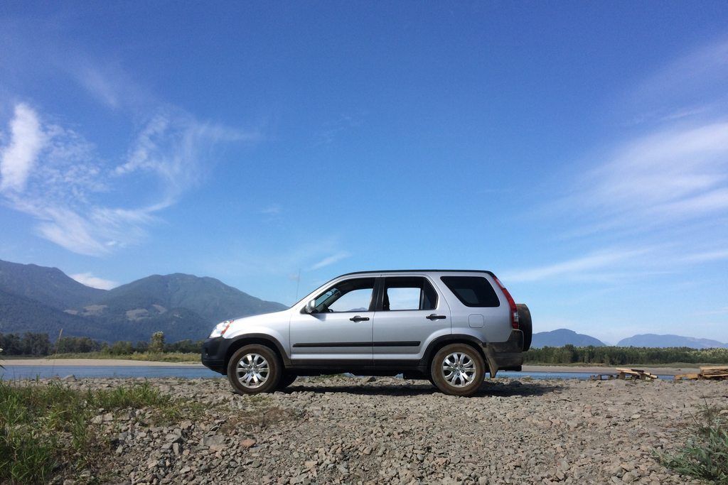

The day I bought it:

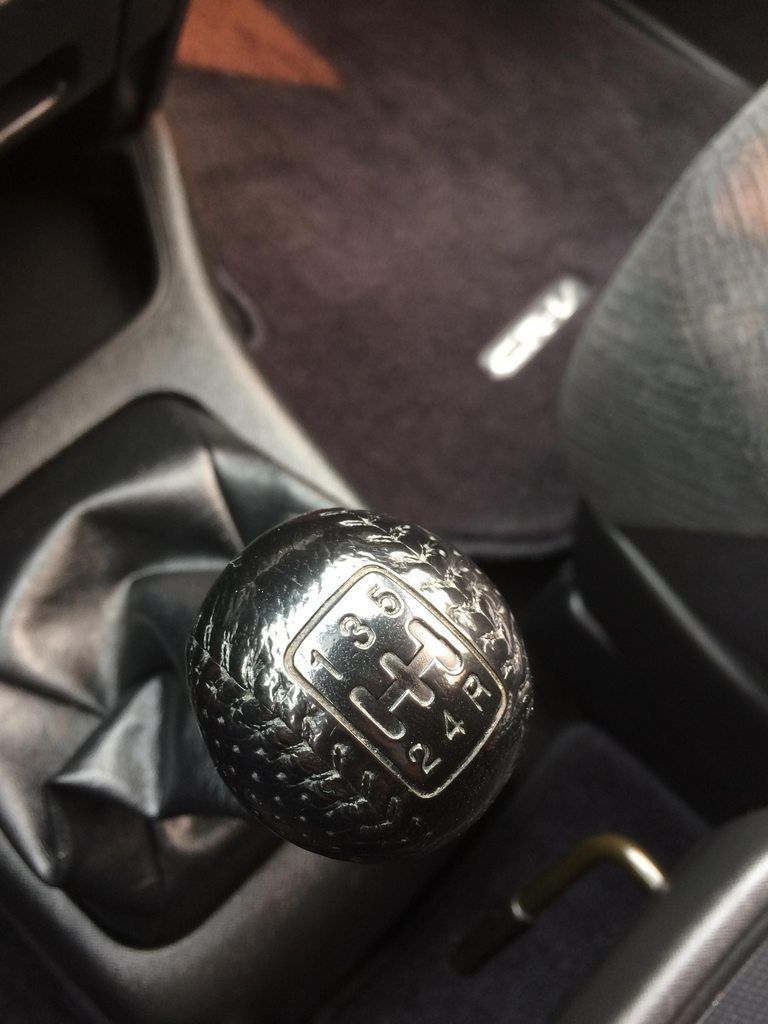

Not sure how common this combination is, with AWD and manual trans. I'm glad I was able to find one.

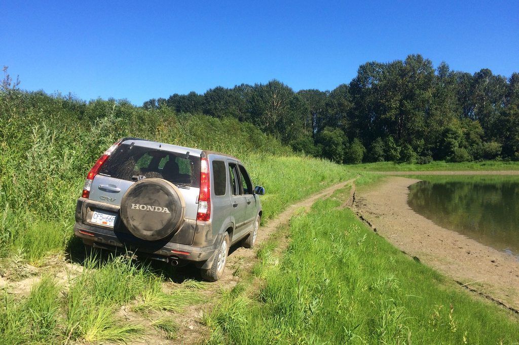

It goes off pavement reasonably well for a car. The low 1st gear is no substitute for a transfer case with low range, but it is a clever feature.
Tires are a weak point. It came with Uniroyal Tiger Paws. They seem fine on the road, but offer poor grip on any loose surface. I would hate to tackle snow with these!
Already having fun going places my lowered Preludes never could.

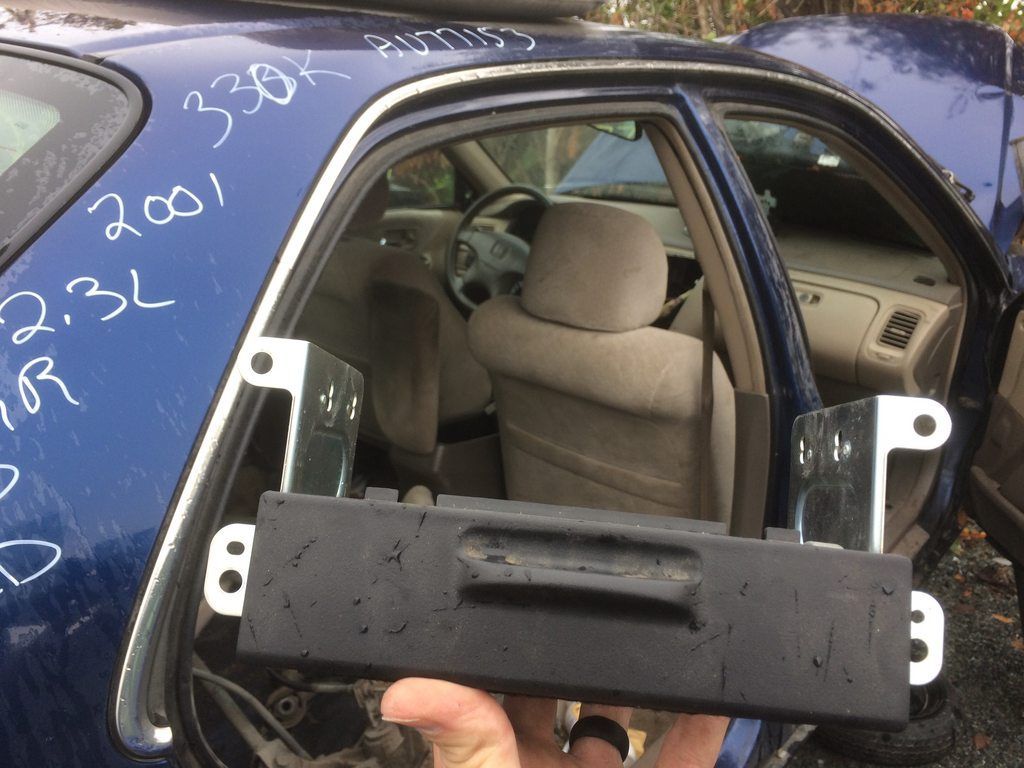

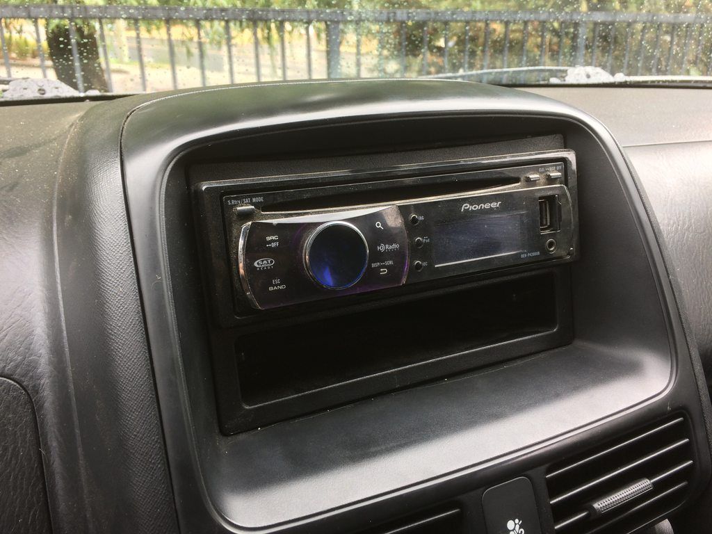

Tiny update today. When I first got the CR-V, I used a Metra kit to install my stereo. It was honestly a terrible product. When I tried to fit it behind the bezel, the bezel didn't fit. And when I put it inside the bezel opening, it fit loosely and rattled over bumps.
So today I went to the junkyard and grabbed a pocket from a 6th gen Accord. Here it is with the ISO brackets from the CR-V attached:
There is still a gap under the bottom of the pocket, but it's not bothering me. Because it's fastened and bolts instead of plastic clips, there's no wiggle or rattle. Don't buy a Metra kit when you can get a better solution for $5 at a junkyard!

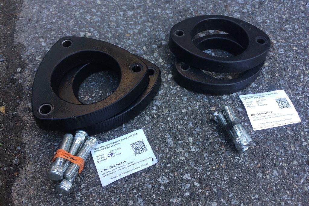

My tires still haven't arrived, but my strut spacers did so here's a picture of them.
Tema4x4 20mm lift spacers for 2nd gen CRV. The ebay listing calls this a "leveling lift kit", but the front and rear ones are both exactly 20mm thick.

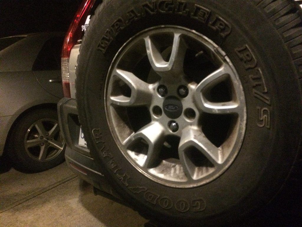

Picked up some wheels today. When I first saw these on a shiny new Ford Ranger in about 2007, I knew nothing about wheels, but I remember I really liked that aggressive look of what I now know is a low-offset wheel. They were probably the first wheels I ever really noticed. There's no way I could have guessed I'd be bolting them onto a Honda 10 years later!
Specs are 16x7 +12. Still need to test fit for brake clearance, but if all goes as planned I should be painting these over the winter, getting rid of the huge 255/70r16 Ranger spec tires, and mounting some AT's for summer.

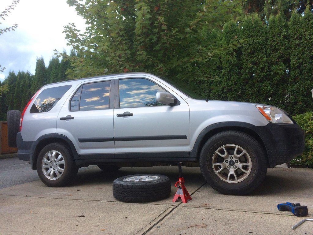

Ok, finally got my 215/70r16 winter tires on. Since this is the smallest amount possible bigger than stock, it should be no surprise the difference is minimal. The speedometer is only 2 km/h slow at 120km/h. It feels like the car won't crawl quite as slow in 1st, but I don't think I could actually perceive the tiny difference in gearing so I chalk that up to the placebo effect. All the tangible changes have more to do with the apples-and-oranges tire selection than sizing.
You could probably park it next to another V and not even notice the size difference unless you were looking for it. Just looks a little more aggressive due to the knobbier shoulder tread. So there you have it, 215/70r16 Motomaster (Cooper) Total Terrain W/T on a 2005 2nd gen CR-V.

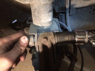

Got my 20mm strut spacers installed, thought I'd write up the process. Nothing crazy to see here if you've worked on suspension before, but I didn't see a writeup in existence yet for the 2nd gen CR-V.
First things first, rear end on jackstands and wheels off. You want to check if your shock fork bolts can be removed. Do this first so you don't end up stuck halfway through the project. My little battery impact wasn't able to do it, so I took the car to a shop and they blasted the bolts out with their big pneumatic impact for $30. In the past on other cars, I've sheared off bolt heads by using a big breaker bar. This would mean cutting out and replacing the bolts and possibly the bushings, so you really don't want that to happen. It's going to be more likely as our cars get older.
Once you've verified that you can get the rear shock fork bolts out, next thing is to remove the two 14mm nuts from inside the car under the panels. This is also a good time to unbolt the rear sway bar body mounts (not pictured, sorry) and let the swaybar hang free. You do not need to detach the end links in any way.

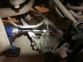

Now remove the two 17mm bolts at the front of the lower control arm. This lets the arm sag further down, relieving tension on the spring. Then remove the shock fork bolt and pull out the strut.
On the driver side, you'll need to remove one or two screws from the charcoal canister thingy in order to make space for pulling the strut out.

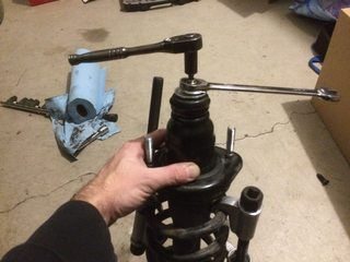

With one or both rear struts out, use a spring compressor to... compress the spring. Use a torx (NOT allen) key to stop the shock from turning and take off the 14mm locknut. Very careful now, there's a lot of energy stored and nothing stopping the spring from flying if something should go wrong with the spring compressor.

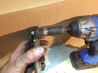

Remove the stock studs out of the top part... what would you call that, a bearing plate? I used a 4lb sledgehammer. (Front strut pictured)
I used some big nuts as spacers, and a correct sized nut with my impact to "press" the extended studs in. These were provided with the Tema4x4 spacers. (Front strut pictured again)

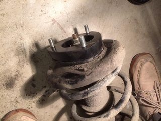

Put the struts back together.
Spacer in place.

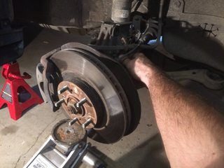

The front end is a similar process but with a few other things for me to point out. I'd pop out the steering end link first.
I'm not actually sure if it's necessary to drop the front sway bar, but I did. The front springs are not compressed at full droop, unlike the rears.
Remove the bolts that hold the brake line and ABS wire to the strut.
Remove the strut lower bolts.
At this point it is VERY EASY for the suspension to sag too far, which will pop out the inner CV joint quicker than you can say oops! I recommend keeping a jack or something under the rotor so you don't end up having to pop those things back in. It seems like something that should take ten seconds, but I struggled for hours before I called a friend and he did it on, roughly, his 6th try. Something like this should do the trick:
Remove the upper 14mm nuts in the engine bay, remove the strut, and install spacers as you did on the back end.
Assuming you didn't let the axle pop out, assembly is the reverse of disassembly. Don't forget to use proper torque specs such as "fairly snug" for small bolts and "two ugga-uggas" for big bolts.
