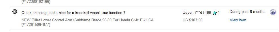

Here you go from that seller.

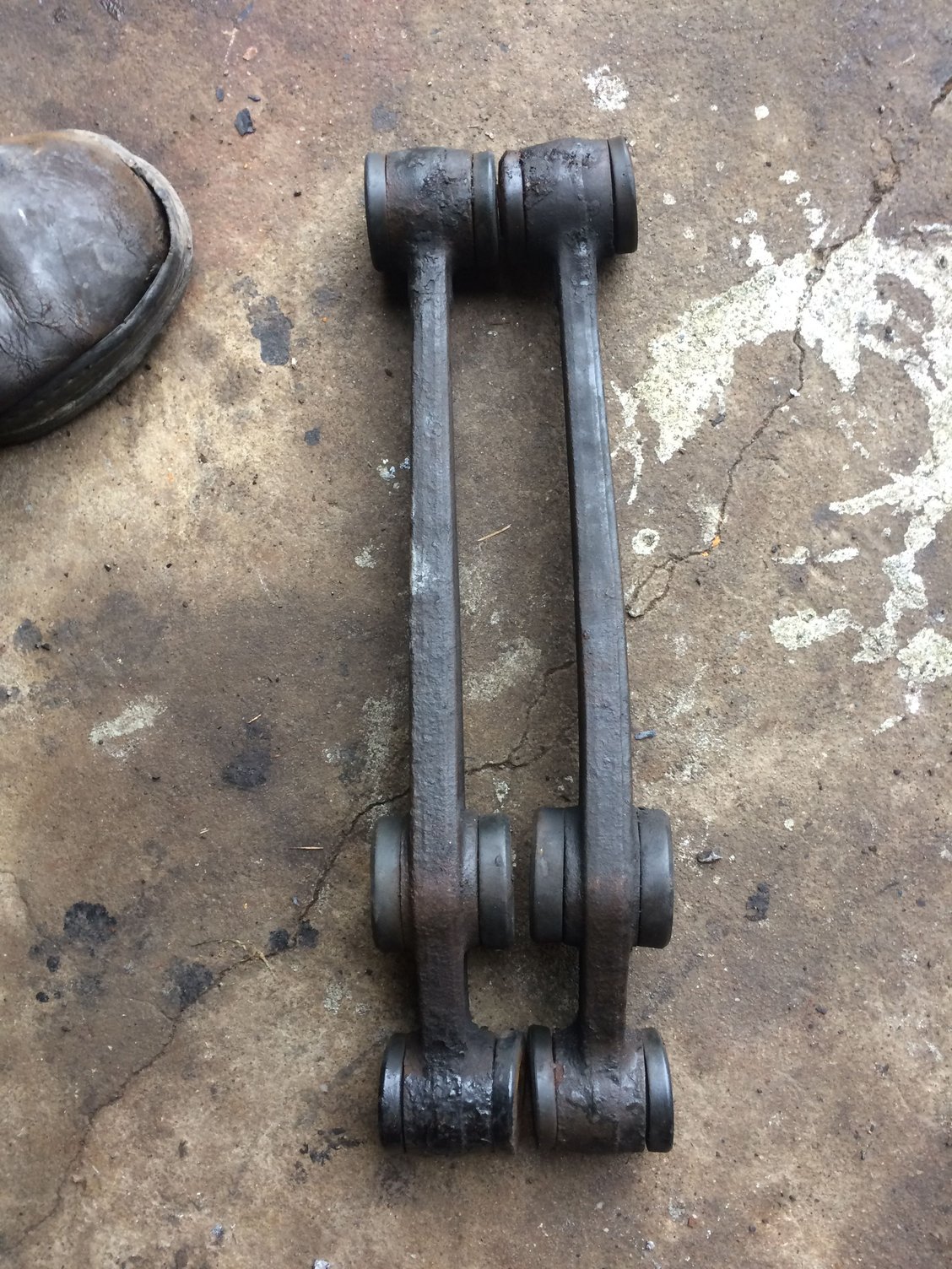

Let see photo of your current LCA.. which one is bent and which is not.

im tellin ya, the passenger side oem trailing arm is bent on the eg and honda bent it, not me and not a previous owner.
I'll post pictures but it's already a known fact its bent. I was really hoping someone would say that it's fine to use the function 7 or not or that i may need a rear camber kit or something like that

This doesn't make any sense. The trailing arm is bent? The trailing arms and control arms are identical on both sides, just mirrored. If there's a bend on the passenger side and not the driver , than it's a different part or something is wrong. Where is it a know fact that only the passenger side is bent? The only info I'm coming up with is that some eg's, integra's del sol's have a bend in the LCA to allow for a sway bar. A rear camber kit has nothing to do with this issue. Your overthinking this. If King sent you the correct control arms, install them and preload the suspension. Check for clearances. I haven't seen a single thread where someone had an issue installing aftermarket LCA 'a on an EG.

^^ exactly. Just want to see what is currently installed your car to verify whether someone had mixed lca installed. Dont have to get all worked up bout it. Trying to help you, not throw u under the bus.
EG on top EK on bottom, both OEM lca
Which one are installed currently?
Integra lca, except itr, are same as eg except it have sway bar mount provision.

To answer your will it fit question. Yes it will be fine with your new function 7 lca. They will work perfect. No issue. Problem here is trying to figure out what you said is bent on your current setup.

Oem 95 civic ex 5 spd non-abs
K i wasn't sure if i was being clear

Looks bent from hitting a curb, etc..., but, I digress. You will not have any issues with installing the F7 arms. Just make sure your F7 arms slide into the trailing arm side straight. Your bushings there look at an angle and a little wonky. Be sure to pre-load the bushings before the final torque.
