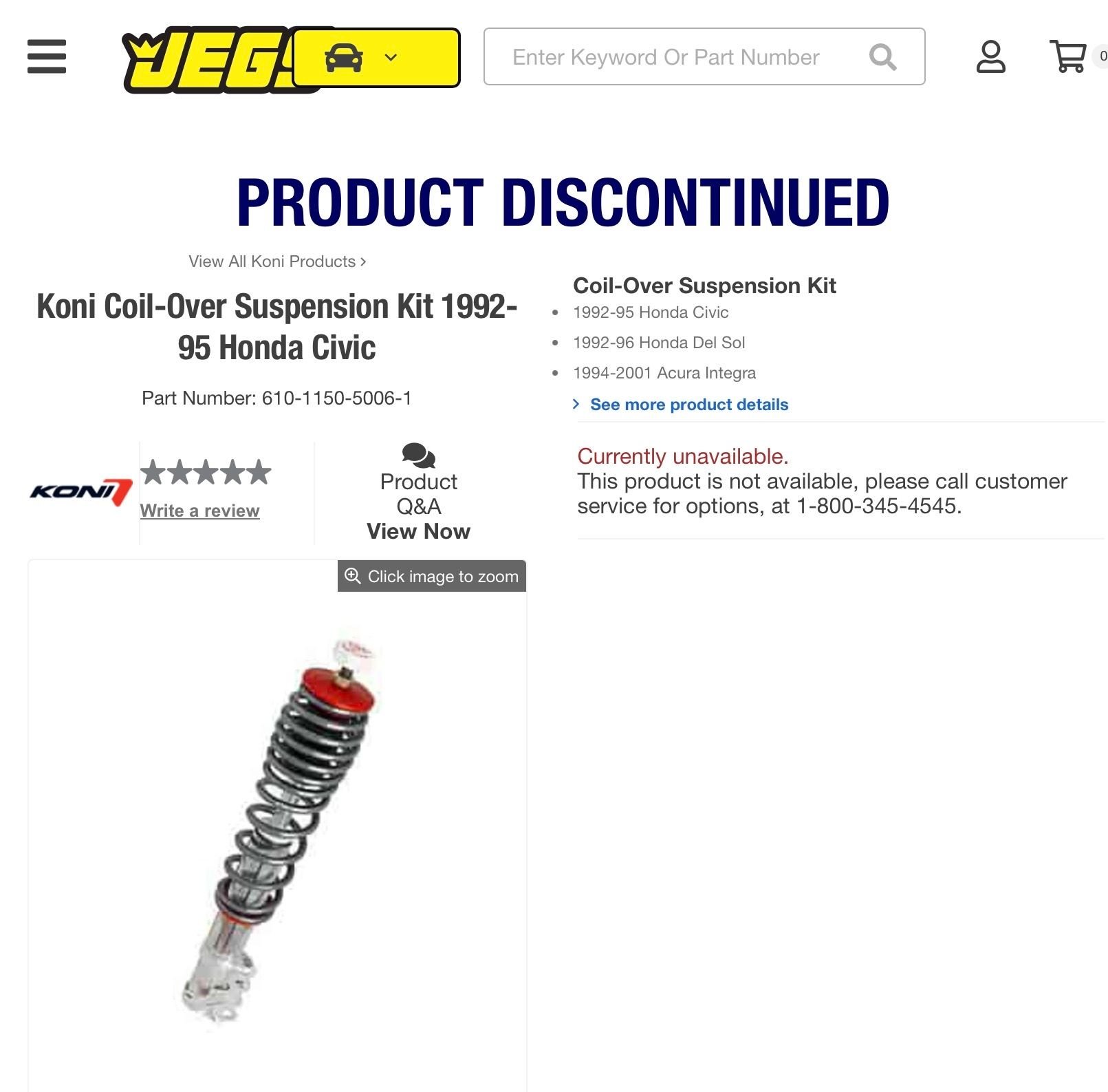

I found a set of these still in the box. Will they fit my 2000 EX coupe? Thanks!

Front shocks are the same and it can be used plug&play but rear shocks are different.

To be clear - the rear dampers will still fit. You will need a spacer on either side of the lower mounting fork as the 96-00 bushings are narrower than the 92-95 ones. Koni included them with the 96-00 versions of the 8041 dampers, it was the only difference between the part numbers.
