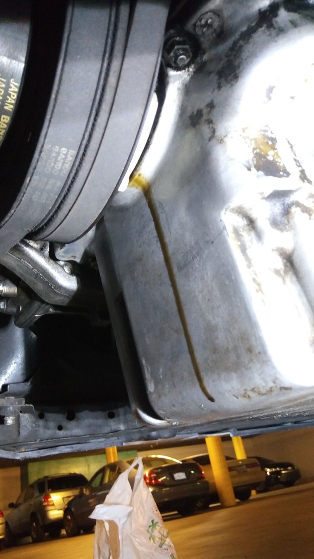

On my way to harbor freight to get torque wrench...i cleaned the area and this is where it started
