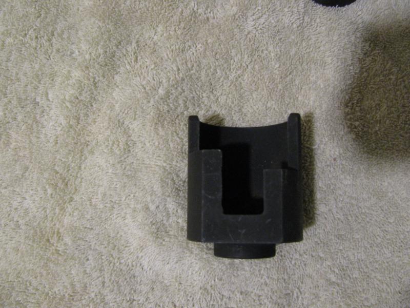

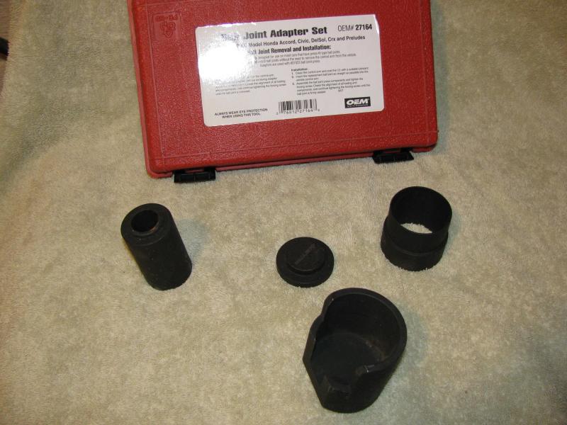

Originally Posted by TGO-MD
I started looking for a tool to press these out of the spindle as well as press them into the spindle. I came across this tool from Autozone (part # 27023):
The rental cost was $100.00. You get the money back after you return the rental tool. I tried to use this tool to remove the LBJ and I got absolutely no where. After getting quotes to remove the LBJ, I headed over to H-T to see what they had to say. After searching the “hammer” it out idea was beginning to sound good. The only issue with that is how am I going to stop the LBJ from moving on its axis.M-
first I have to say thank a million for posting this...4 hours after I first saw this thread I had the 12-ton press set up and ready to go. this is also my way of doing things.
the Autozone tool rental that you needed for the ball joint was part # 27164 - it's specifically made for hondas and their awkward balljoint setup. anyhow the only way I could get it to work is shown in the pictures below.
******I want to add that this part # 27164 says that it's an adapter set used with ball joint press # 27023, however I could not get them to work together because the c-clamp arm from 27023 was too short to fit the 27164 adaptors. I don't see how they say they're made to work together.*******

The kit of "honda adapters" has all the funny shaped adapters you need, and the press tool has round collars. If you use the press tool, theres a part that spins in the end of the screw...it pulls right out so when you press the new joint in, you don't damage the threaded end.
The last couple times I've done lower ball joints, I just used an impact wrench on the tool. And if you stick the new joints in the freezer, they go in a little easier.
