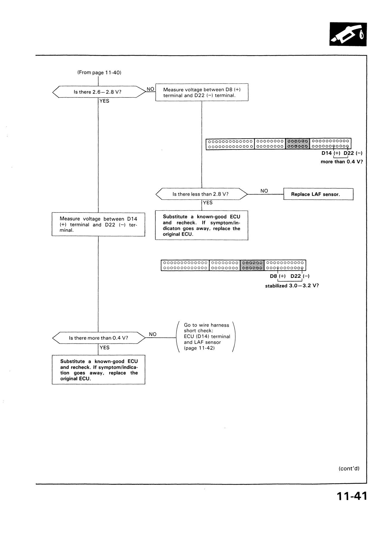

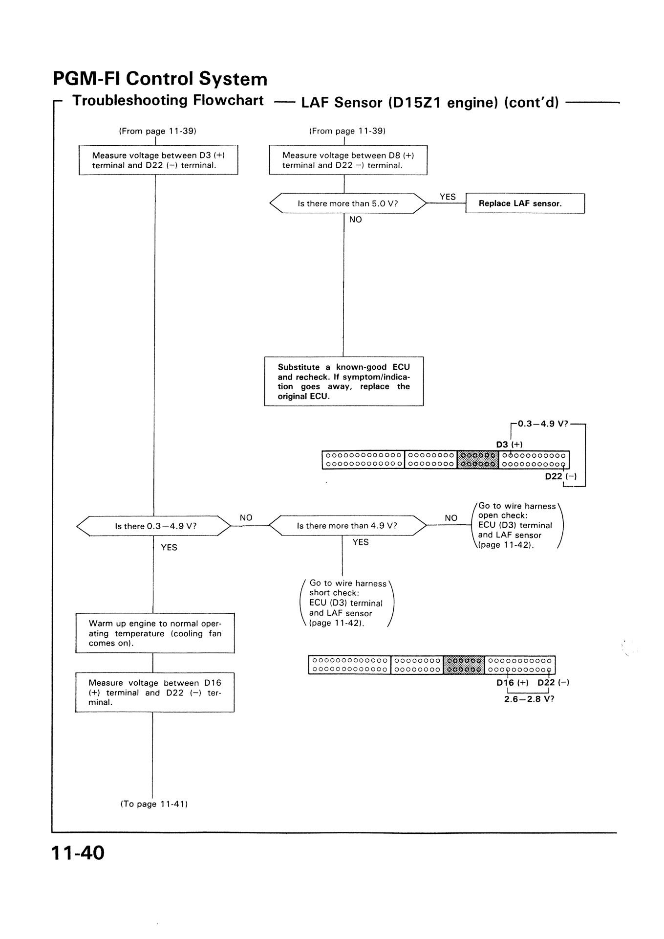

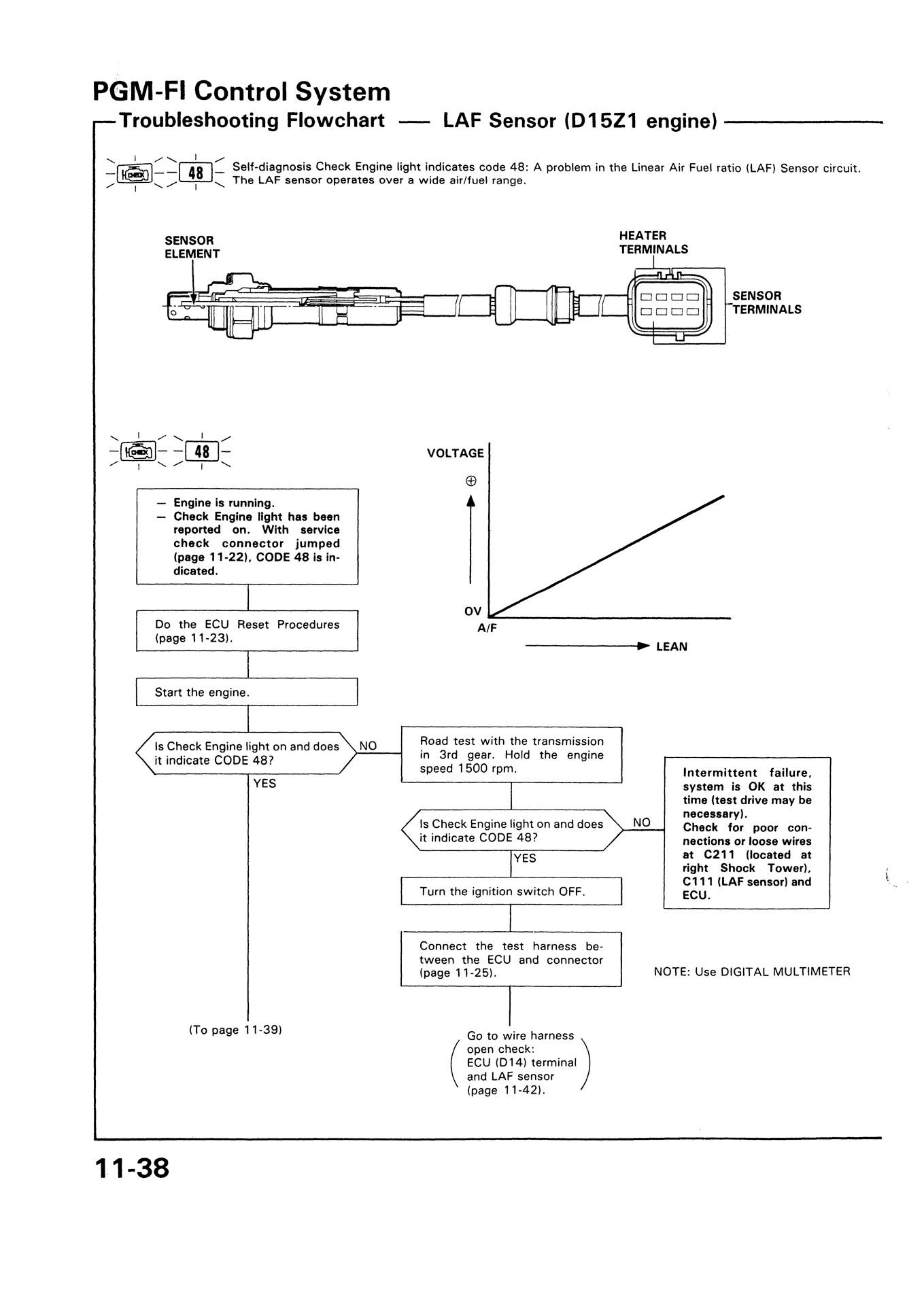

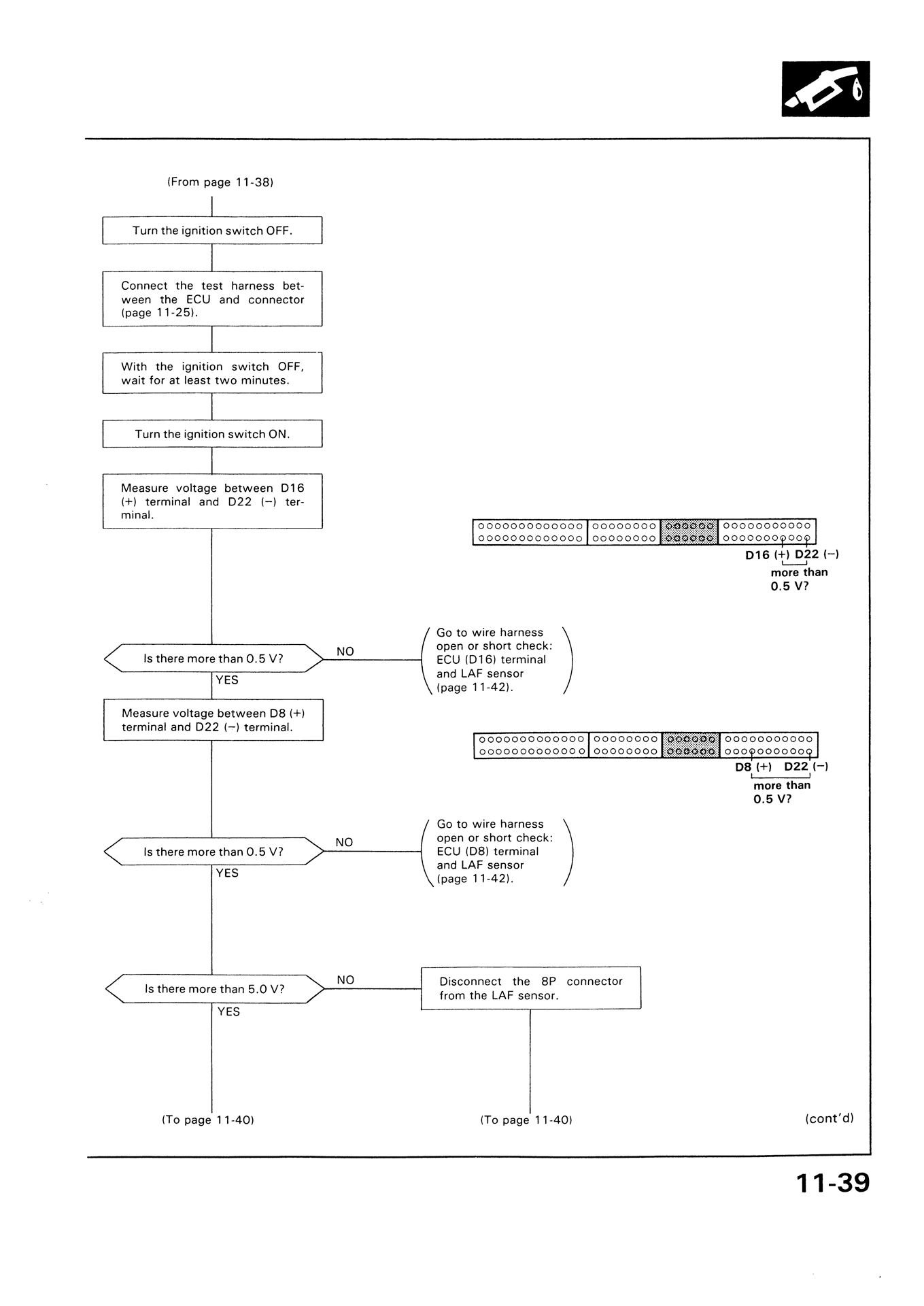

The D15Z1 vtec-e motor from USDM/CDM should be pretty close to your D15Z3 as for procedure. Please see the LAF pages below:
