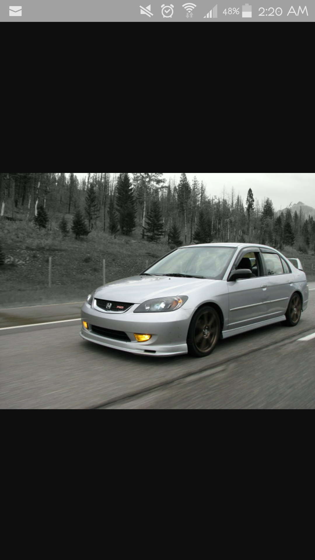

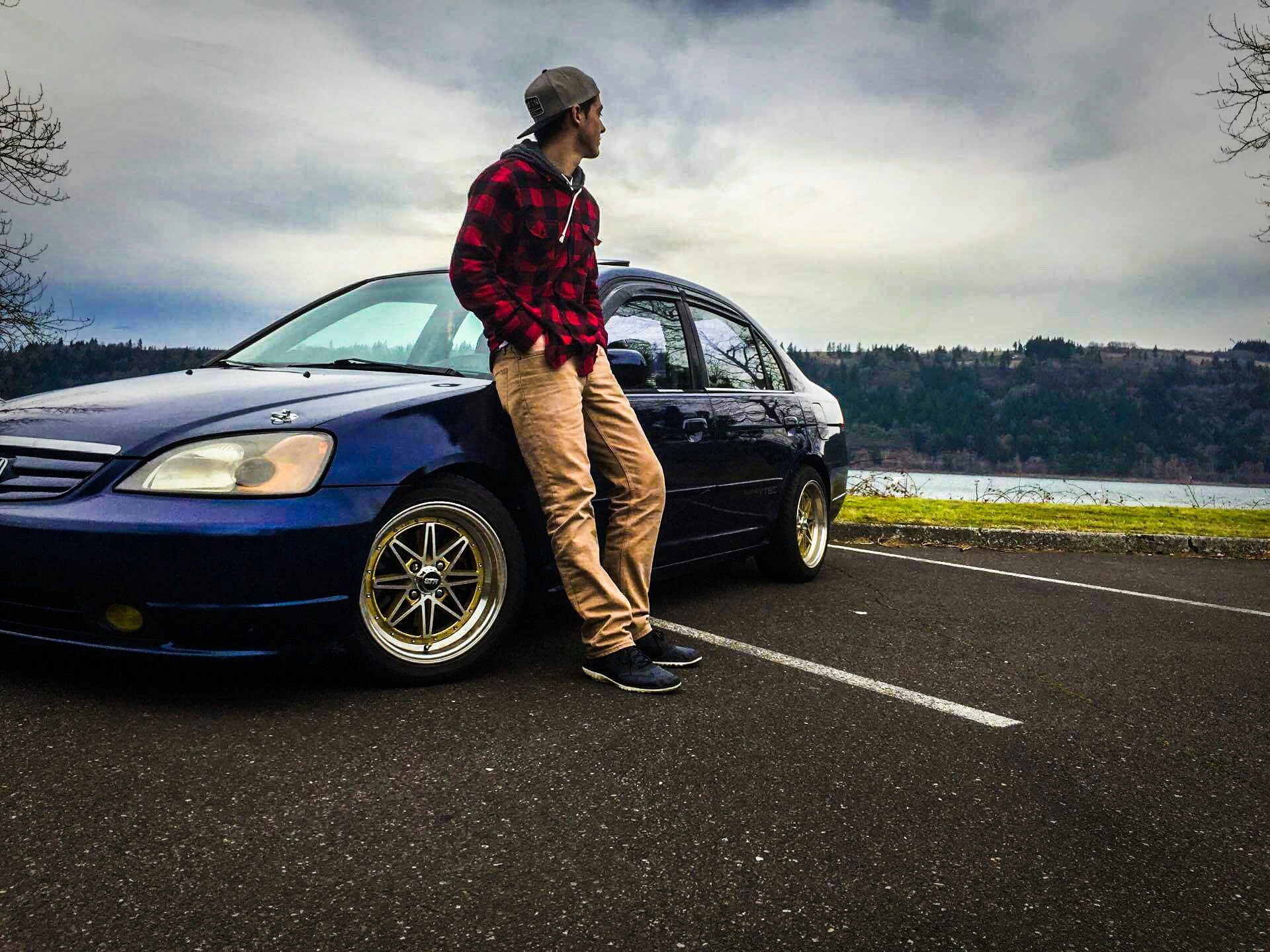

Hey guys so I recently bought this 2002 civic sedan and I'm currently interested in swapping the front end to the 04/05 civic look but if I bought the fenders, bumper, lights and hood would I be able to just remove the old and bolt everything on or would it not fit??
This is my car currently how I bought it and below is the look I'm wanting
Does anyone know if this will work without any major modification..?

Fenders, Headlights, Hood and Grill. Should bolt up with slight modifications.

Nice Ride what will happen you need two fenders, hood, headlights and also the radiator support so that those head lights will mount on it without any modification also I believe you will change your headlight bulb sockets too. I am also looking to do it but I am looking for 04 05 Acura EL front complete, I just did the rear end swap about a two months ago. You will spend some ?s probably not on the parts but to match paint them. Hope this help good luck with your conversion.
