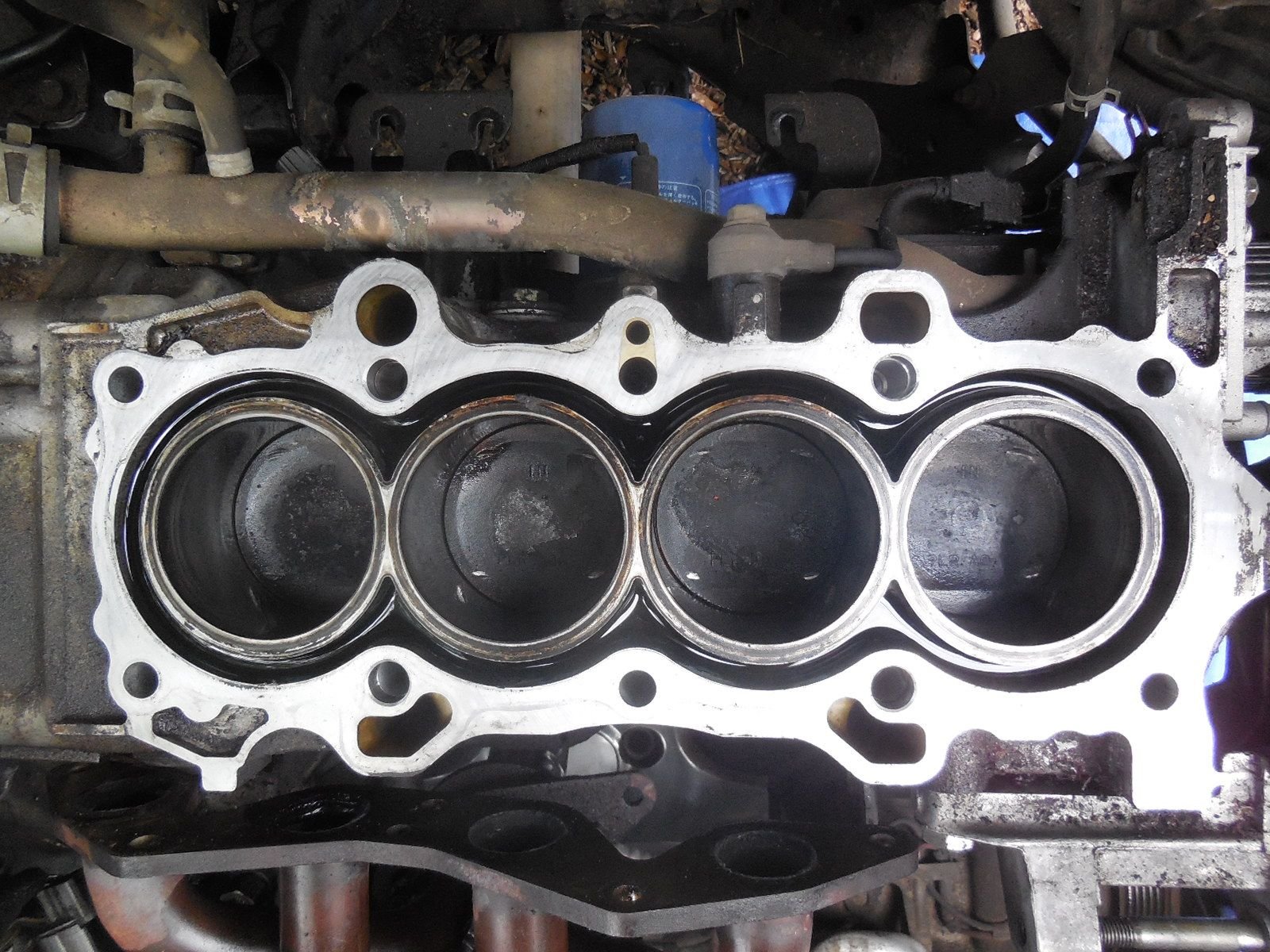

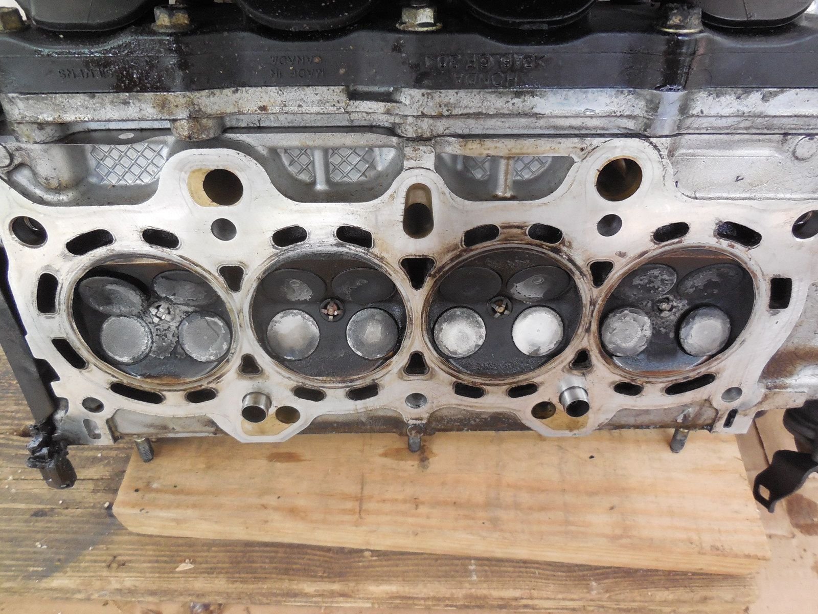

I pulled the head off, and it looks like I may have gotten lucky?? There is no damage to the cylinder walls, and only minor dings to the piston landings. There are obviously bent valve stems on number 1 and 4, freezing the cam shaft in place. Do you think the head is salvageable, or should I just go to a remanufactured head? Should I worry about the minor piston damage?

I pulled the cylinder head off, and it looks like I may have gotten "lucky". There is no damage to the cylinder walls, just minor dings to the piston landings. There are obvious damaged valves on the #1 and #4 cylinders, the bent valve stems freezing the camshaft in place. Do you think this head is salvageable, or should I go with a remanufactured head? Do I need to bother with the dings on the piston landings?
Old Jun 29, 2024 | 09:42 AM

Likes: 9
Default Re: Engine destroyed???
Looks like you shoukld take the head into get surfaced. Have em look at the valves. That is your best option and cheapest.
Looks like every valve touched a piston. Meaning every valve is probably bent.

After working on the engine whenever I had time, the engine is back together. You were right, the valves were all bent, and the machine shop did a nice job on the cylinder head. New timing belt, crank position sensor (I only use genuine Honda parts in critical areas), belt tensioner, etc.
