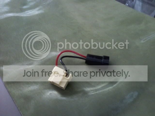

I got myself some depo black housing headlights for my 94 accord which i already installed. my accord headlight harness is for hb4 (low beams) and hb3 (high beams type bulbs). so since the jdm black housing types use h3 and h1 instead, depo being a replica also uses those bulb types. so i have this plugin wire thing where its makes h3 bulbs work on my hb4 wiring harness. However, i only have one so one side of my headlights wont project any lights. My question is i need help identifying what this picture i post here is called and if anyone can tell me where i can buy it from any auto shop or online that would helpful. Thanks in advance

When i got my HID's it came with the samething you have in your picture except its HB4 Male on one end and HB4 Female on the other, When i got everything installed the Light did not work on one side so found out one side wasn't contacting, i ripped the wires out of the connector with the Pins connected and just plugged it into my Stock connector - wrap it up with some black electrical tape and Now it works fine. I think the pins arent pushing all the way in on the connector. You can just go generic like me and pull out the 2 metal pins and stick em into your stock connector.
Hope that's your problem as well

I got my setup from suvlights.com and bought all the H4/H1 connections AND the other ends of the 9006/9005 setup to have a plug and play setup

Alrights thxs guys ill see what i can do
