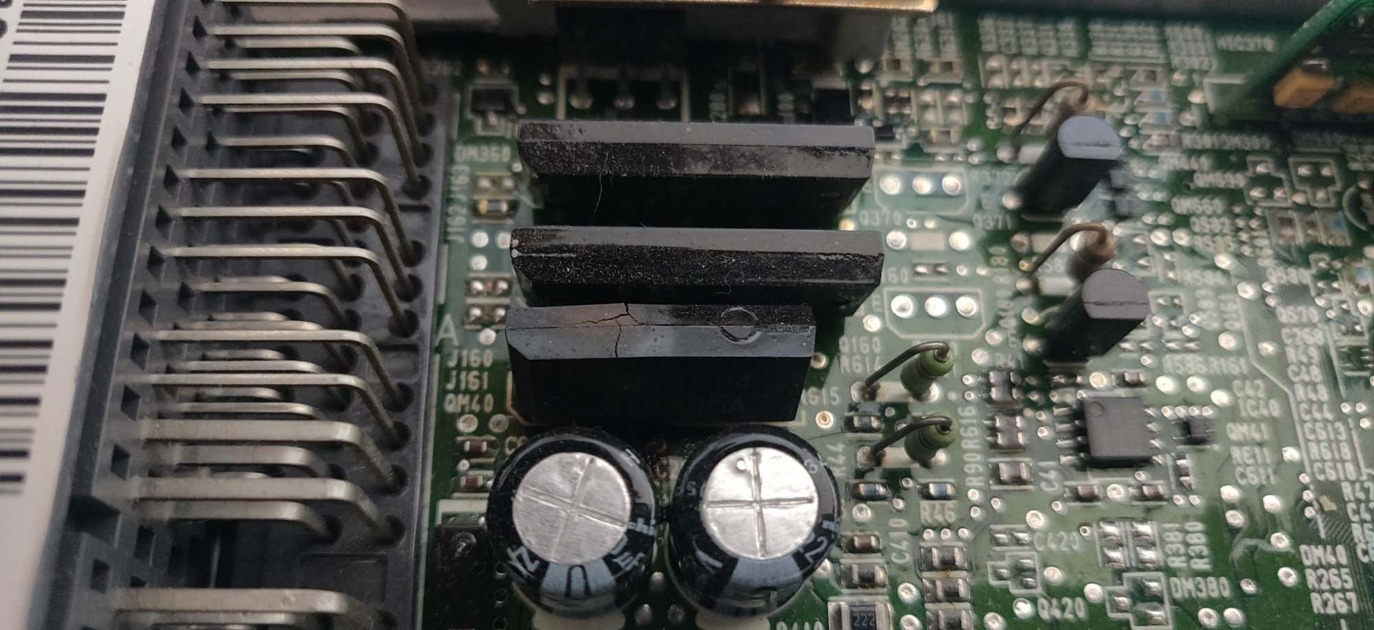

Hrm...if you aren't getting power or ground at the harness, you have a different problem than me. Mine ended up being the computer wasn't reading the 02 sensor, but it was at least getting power. I suppose your issue could still be the computer, though. When I pulled it out, even before I opened it up I could smell burned electrical components. I opened up the computer and found this:
I swapped out the computer and bought a key programmer from walmart. Worked like a charm. If you get a new ECU, DO NOT get the bypass kit. I ruined one ECU trying to get the stupid bypass chip in because it ultimately wouldn't fit right. The soldering pads were spaced too far away.
