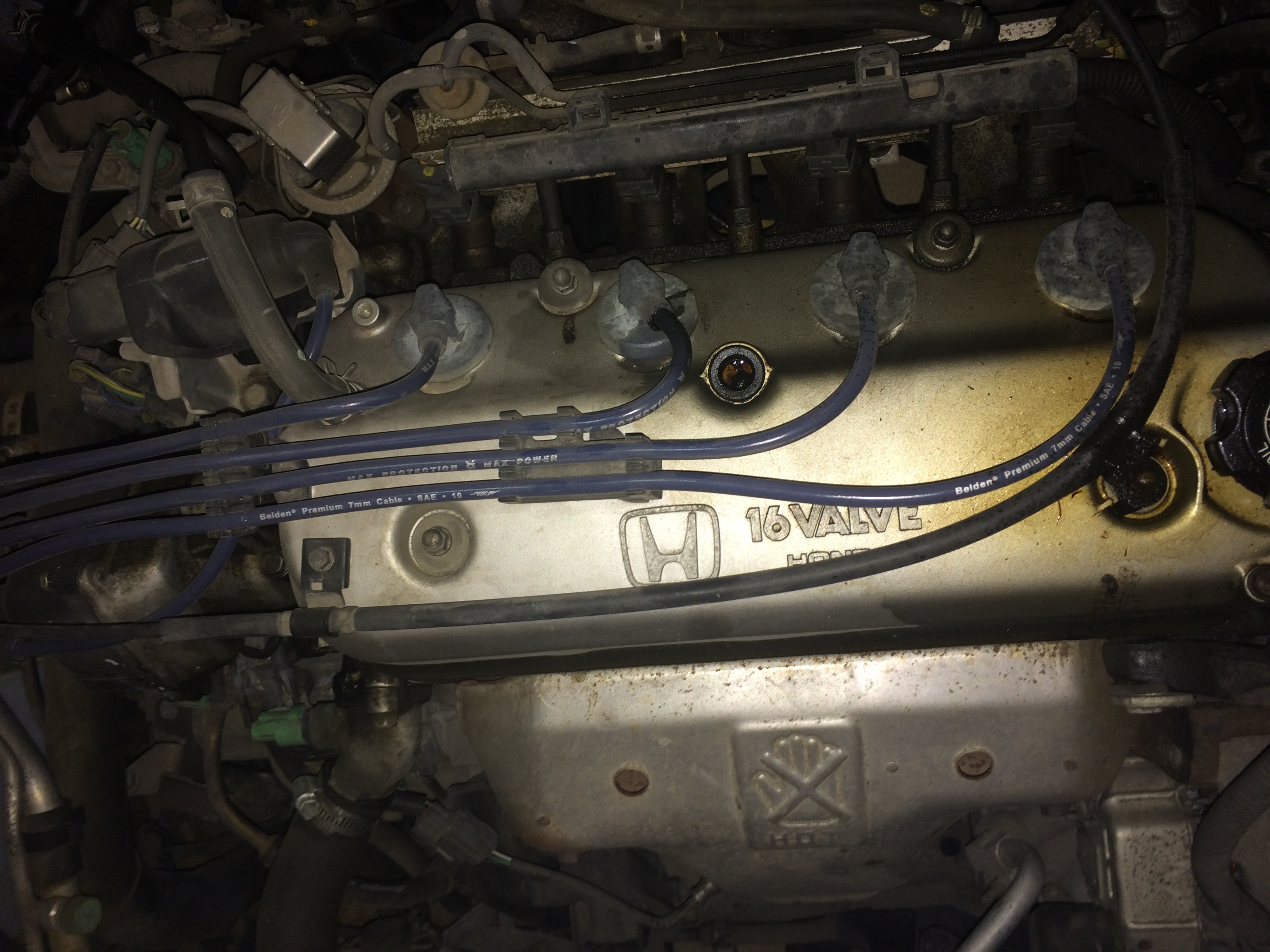

Can anyone help me identify the hose in the picture? I need to get one as 1997 Accord my daughter just purchased for herself is missing the hose completely.

PCV hose.

Thank you, that is what I was thinking from my limited research. This is what I am looking at on the car as is.
I will need to get a PCV hose along with a PCV valve along with a couple hose clamps to fix this???

Shouldn't need any clamps.
A PCV and about 2 foot of 3/8 fuel line and you should be good to go - double check me on the 3/8 line, while at the store test fit the valve to the hose.
