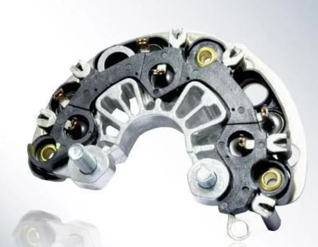

For the alternator I'm having a hard time looking for rebuilding kits in Spain I have found some online shops that has the diode bridge but none in stock, I'll have to go to a parts store, or maybe to my local honda. I'm planning to also replace the voltage regulator of course.
This thing I have to replace?
I will first test to see if the car runs like this, and after I'm sure that my mess didn't do big damage I'll have a look at that alternator.
