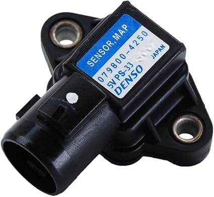

What other vehicles map sensor are interchangeable with a 92 Honda Accord

Out of curiosity, why would you do that? You can get the correct one for $20. Are you searching in a junnkyard?

That is not the correct map sensor for a USDM F22A engine, the link posted seems to be for a European Accord 2.0i maybe.
If this is for a US made vehicle any 90-02 chassis with a 3 wire,2 bolt, throttle body mounted MAP sensor will work. all trims Civic, Accord, CR-V, Prelude, Odyssey or Integra.
Denso -TN079800-3280 and or TN079800-4250... I think any of them that start with TN079800-XXXX will work.

I apologize, I didn't mean to post the wrong part numbers, thanks for catching that.
