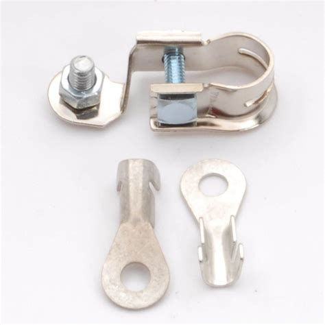

*I Use these battery terminals when the ends need replaced, not those odd lead terminals with frayed wires. I then solder the cables onto these eyelets.
