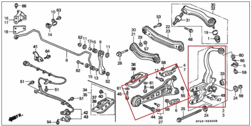

Its actually a very easy swap. You can take the whole rear trailing arm/subframe/hub out of an EX Accord and bolt it up to your LX.

Like 1996accordlx said, its a pretty easy swap. Just a matter of obtaining the hardware and parts you'd need. I'd say go to your local junkyard and pull what you need yourself, that way you get all you need including hardware and you gain some experience in how it all goes together and comes apart. Plan on buying a set of pads and rotors, your not gonna want to bother with used. Also keep in mind that you'll obviously need calipers but good ones too, so consider buying a set from the parts store to use on the car and if you do go that route, taking the used ones from the junkyard too (to use as a core return). Another thing to consider is whether you have ABS already and if you plan on retaining it. I'm pretty sure all disc brake equipped 5th gen Accords were ABS equipped, If you don't have ABS already and don't want it, then you don't have anything to worry about. Another thing is e-brake function, I'm not sure if you'll be able to use your drum brake e-brake cables on the new disc setup, you might need disc brake e-brake cables.
You will need:
  • Rear Trailing Arms
  • Rear Knuckles (Retain the already mounted, wheel bearings, brake dust shields & wheel hubs)
  • Brake Lines (Just the short, rubber lines that run from the junction @ steel line and run to the new calipers)
  • Calipers
  • Pads
  • Rotors
  • Disc Brake E-Brake Cables (Possibly)

I think Honda decided to save some time, energy and costs by using e-brake cables that work will both disc and drum configurations, I havent 100% confirmed that but the illustration of them in the OEM Honda parts illustration shows the same cable ends for both.
