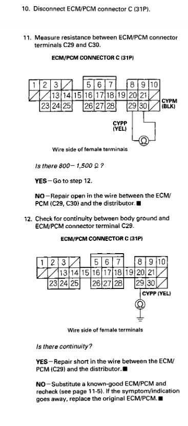

P1382 is CYP sensor no signal. The CYP sensor is in the distributor. Cause may be due to the distributor, wiring, connection, or PCM.
Normally, you can test the resistance of the sensor in the distributor. Since you already replaced the distributor, you can move on to test the wiring that runs from the PCM to the distributor, etc.
The PCM is located under the dash, center console area. You only need to remove the passenger side carpet clip to access the PCM connectors.
1. Disconnect the PCM Connector C (blue connector).
2. With a multi-meter, at the disconnected Connector C, measure the resistance between the cavity terminal no. 29 (yellow wire) and no. 30 (blk wire).
You want to see if there is resistance between 800 - 1500 ohms. If there isn't, there may be an open (break) in either the yellow wire or black wire that goes between the PCM and the distributor.
3. If there is resistance within specs., then that may indicate a faulty PCM.
4. You can also check for continuity to ground at Connector C cavity terminal no. 29.
If there is continuity, then that may indicate a short in the yellow wire that goes between the PCM and the distributor.
If there is no continuity, that may indicate a faulty PCM.
