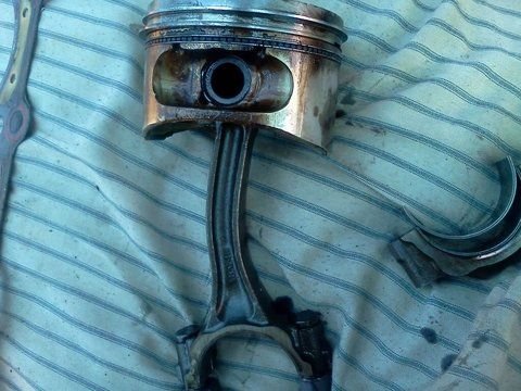

THIS B#TCH GOT POWER FOLLOWED BY TIMING BELT FAILER IS A COMMON PATTERN I ACCUMULATED. LOL
bent piston rod after, olds 2.3 lt backfired, blew my muffler apart like a m80 in a pop can. Bearings and all were within specs so just replaced piston rod assembly, no I replaced all the bearings, now that I think about it, told better do all then the one set, think from bearings from schucks at the time, purchased piston and rod assembly on the forum I was subscribed to, brought head to a different shop that corrected the assume valve leak then, same symptoms as this Honda started earlier, 2.3 lt 1st dohc I took apart twice, just replaced timing belt and head gasket, then head gasket again, Fun..
first shop I took it to wasn't around, said to have resurfaced and some angle cut on the valves and seats, forget what it was called, anyway still backfired, little pops, sometimes big pops, then after new exhaust system, including catalytic converter a huge bang, piston sat inch or so below tdc. Ok jabbering over.
