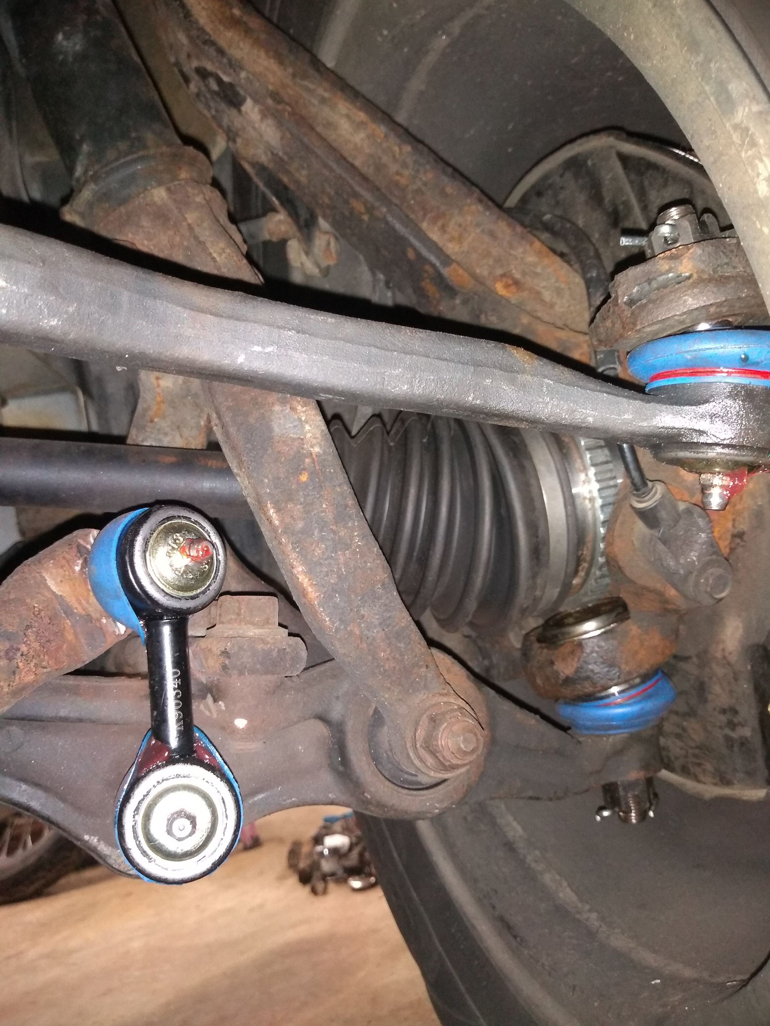

Seems as if the shop was just trying to screw me. After moving the tie rods back to original place and comparing length to the new ones. I could find no issues. The shop had open up my passenger side boot. Loosened my inner tie rod almost all the way.
This is why my tie rod was maxed out. After correcting and readjust the tie rods and steering wheel three times. I now still have 1/2" of adjustment available for both sides. So always check your inner tie rods and boots to see if they were messed with. When I originally put the boot back on I use white zip ties. The shop had throw a black on to hide they messed with it. So I would suggest marking you zip tie or bands also.
I did clip the excess after tightening the inner rod back. Pic is just to show the difference in the zip ties.
