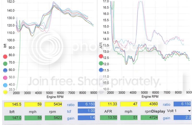

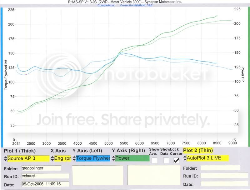

lost power on dynopack but gained power on dynojet.... starting to think dynojet readings were fucked up
dynojet from sat
dynopack from today - thin lines = new tune RUN TO 9K IS NEW TUNE!!!
real rich - a/f taken from exh tip which is leaner than actual (red/blue/green = new tune)
guess I should have taken it to the track to see which is actually better lol

lol there was no more tune from 229whp... I just threw in on a dynopack so tuner could see the tq curve...I was very happy with the results that I saw on dynojet but \/
I didn't want anymore & was expecting to see less horsepower...go reread my previous post... where dynojet showed mid to top gains from previous tune dynopack showed loses... same cal was used for baselines & same cal for full tunes
reading &gt; you
on a good side BOTH dynos showed the gains from moving vtec from 4K to 3K lol... but thats it
tune #1
1320 dynojet 220 whp
local dynopack 214 whp
tune #2
1320 dynojet 229.82 whp
local dynopack 206 whp
I had expected to see gains on dynopack where I saw them with dynojet... maybe I will stop dyno'ing all together

dynojet numbers will always read higher than dynopack/mustang dynos/dyno dynamics. dynojets measure how fast the wheel spins to calculate HP, so when changing from a 16inch wheel to a 14inch wheel a dynojet will show hp gains.

jesus christ
FOR THE LAST TIME - ITS NOT ABOUT THE DYNOPACK BEING LOWER NUMBERS!!!!!!!!!!!
ITS ABOUT THE DYNOPACK SHOWING A LOSS OF POWER WHERE THE DYNOPACK SHOWED A GAIN between 2 calibration files (with exception of 4-5K gains made by moving vtec from 4k to 3k.... ) only changes made where a/f, spark, cam angles
edit -
BTW history on dynopack
base ITR cal - 201.4 whp
partial tune - 214.1 whp
full tune - 206 whp
look at a/f... I bet if I lean it out all the missing power will come back... the graphs are all right there but nobody cares to read them or what I am typing
