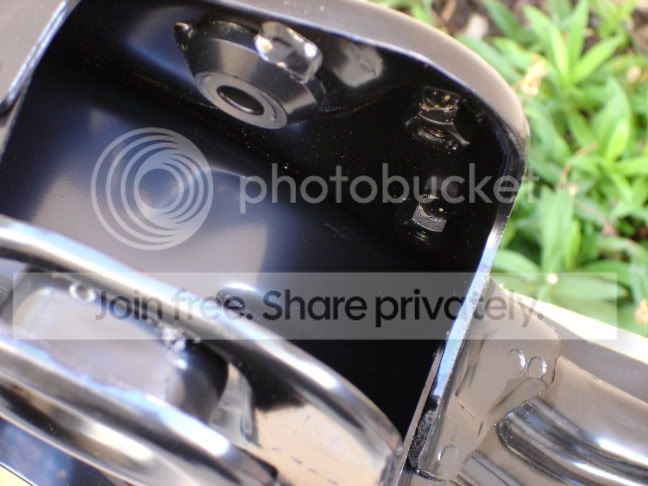

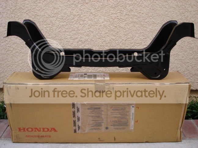

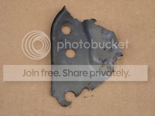

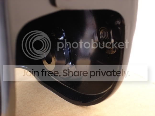

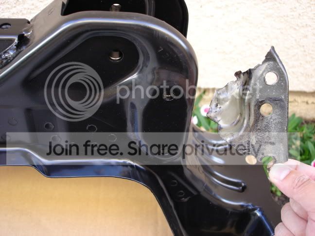

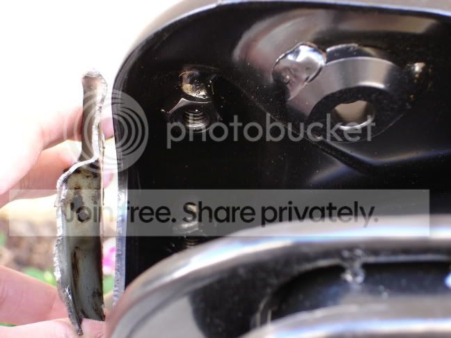

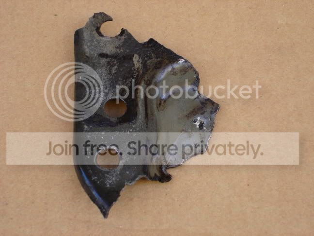

as requested, here are some pics of the new ctr rear subframe that will be replacing my oem dx one.
recap:
after 4 years of running a 22mm itr rear sway bar with reinforcement plates, my subframe tore.
i removed the rear sway bar to prevent further damage only to reveal this horrifying image
i then sourced a ctr rear subframe from japan and 2 months later, ups is at my door. big thanks to a&j racing
some comparison pics of the difference in subframe thickness and quality between the ctr and dx subframe.
torn piece of the dx subframe
front shot
rear shot
notice the threaded nuts behind the subframe for your sway bar vs. nothing in the back of the dx subframe
trying to compare thickness between the 2
next step, going to the shop to have REDZONE work their magic

^^^honestly one of the best investments!! makes you wonder, why didnt honda just put all the same parts on all the civics so that they wouldnt have to produce two different types... cant wait t see that installed!!!
