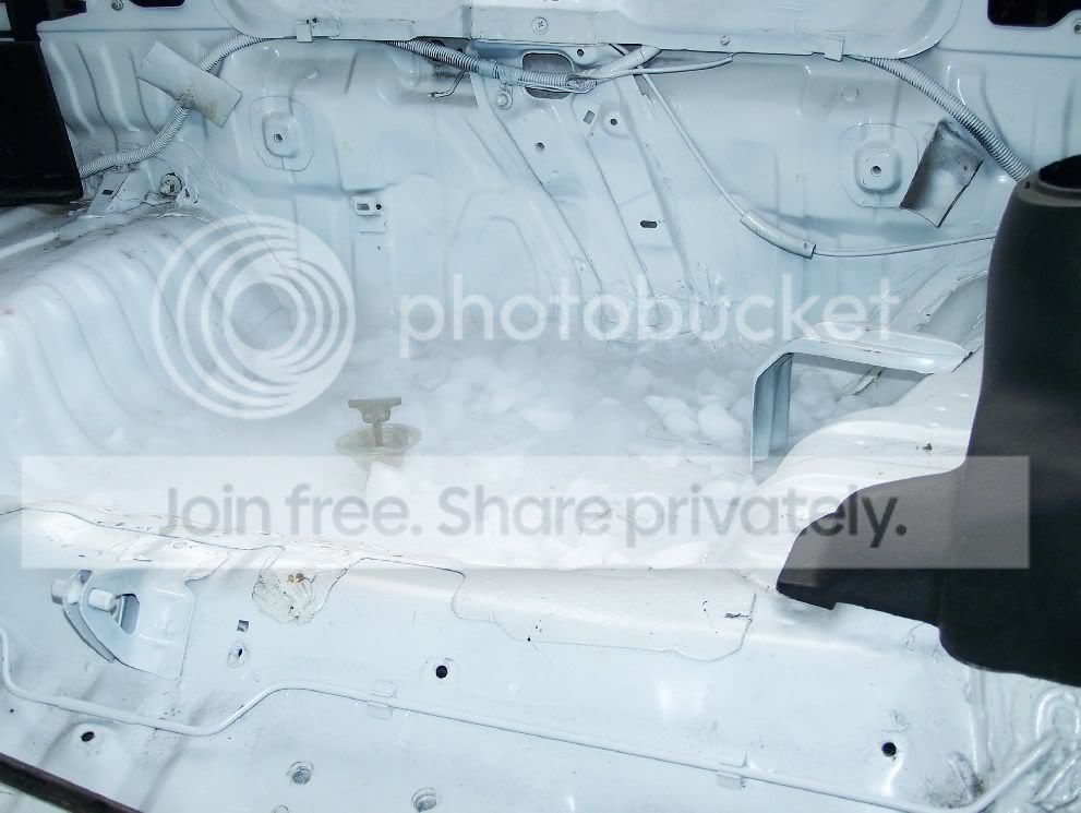

Dry ice owns. I need to get the residue out left over from the tar out of mine. I think I'm going to soak some rags in WD-40, cover the floor, then wipe/scrape it out, unless someone has a better way...

<TABLE WIDTH="90%" CELLSPACING=0 CELLPADDING=0 ALIGN=CENTER><TR><TD>Quote, originally posted by -NA-aLL-thE-wAy- &raquo;</TD></TR><TR><TD CLASS="quote">Dry ice owns. I need to get the residue out left over from the tar out of mine. I think I'm going to soak some rags in WD-40, cover the floor, then wipe/scrape it out, unless someone has a better way...</TD></TR></TABLE>
I told you guys a million times
acetone + dryice = the win
If your scared to lift paint ,then substitue acetone with IPA (isopropyl alcohol)
If your scared to lift paint ,then substitue acetone with IPA (isopropyl alcohol)</TD></TR></TABLE>
Even after all the tar is out? All that's left is the residue. I'm not worried about paint coming off. What mixture are we talking about? dry ice:acetone

there really wasnt much if any residue on my car after the dry ice treatment..
a bit of paint thinner got any gunk off. let the dry ice sit for a bit, and the junk usually pops off clean. never ceases to amaze me! its fun

I bet it's because we did it when it was about 105* outside.

Start with a litter of acetone and disolve as much dry ice as you can, maybe 2-3lbs. DO IT SLOW in the begining, hte acetone will "boil" as teh cold co2 transitions from solid to gas. But after 10-15 minutes after the acetone gets cold it should be fine to add at a normal rate. When saturated you will have a slushy around -78 degree celcius.

Start with a litter of acetone and disolve as much dry ice as you can, maybe 2-3lbs. DO IT SLOW in the begining, hte acetone will "boil" as teh cold co2 transitions from solid to gas. But after 10-15 minutes after the acetone gets cold it should be fine to add at a normal rate. When saturated you will have a slushy around -78 degree celcius.</TD></TR></TABLE>
do we pour it on afterwards??
The dry ice pretty much took care of everything slthought I didn have some trouble spots (ie how the hell do you keep dry ice on the wheel base w/out it falling off )
And there is some spots where there is that sealent stuff (right under the rear seat)
Old Mar 7, 2007 | 08:22 AM
And there is some spots where there is that sealent stuff (right under the rear seat)</TD></TR></TABLE>
Yeah its a slurry so its more viscous than just solid dry ice. You get better coverage and the acetone eats the sticky **** at the same time. I would use a cheep paint brush and move it around. You could also u liquid N2 Thats what im going to use on my crx but i think u need a license to get it.

I dont think they get that cold, plus the **** left over doesnt evaporate. So inturn u have a mess left over. Organic solvents are very volatile
i was just going to say this. alcohol plus dry ice = a wonder paste.

I actually didnt have to use dry ice. I just waited till it was pretty cold outside and most of it broke off. I still need to buy some for acouple spots. Still dont know where to buy the **** from.
<TABLE WIDTH="90%" CELLSPACING=0 CELLPADDING=0 ALIGN=CENTER><TR><TD>Quote, originally posted by Boosted Chemist &raquo;</TD></TR><TR><TD CLASS="quote"> You could also u liquid N2 Thats what im going to use on my crx but i think u need a license to get it.</TD></TR></TABLE>
haha. I use liquid N2 everyday at work "schlumberger". That **** is cheap we get it for 40 cents a gallon. The only thing is that I dont think they would let me take it home. Hell I dont know how I could get it home. If you just put it in a gallon or bottle it will explode..lol..trust me I do it all the time at work.

Yeah pretty much, i use that all the time.
<TABLE WIDTH="90%" CELLSPACING=0 CELLPADDING=0 ALIGN=CENTER><TR><TD>Quote, originally posted by harmonator84 &raquo;</TD></TR><TR><TD CLASS="quote">
haha. I use liquid N2 everyday at work "schlumberger". That **** is cheap we get it for 40 cents a gallon. The only thing is that I dont think they would let me take it home. Hell I dont know how I could get it home. If you just put it in a gallon or bottle it will explode..lol..trust me I do it all the time at work.</TD></TR></TABLE>
I know, i use it everyday also, we have 3 and 6 litter dewar to transport it around. I spilled a little splash on my sneaker, wow that was cold
