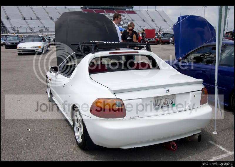

Originally Posted by honda_racing101
....WHere can I get that spoiler?? Nice!!
