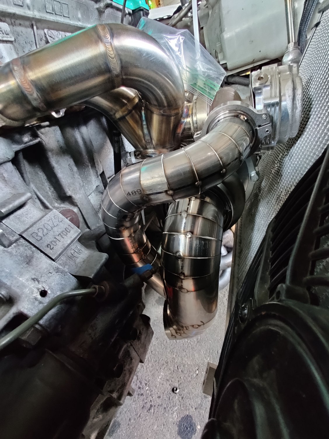

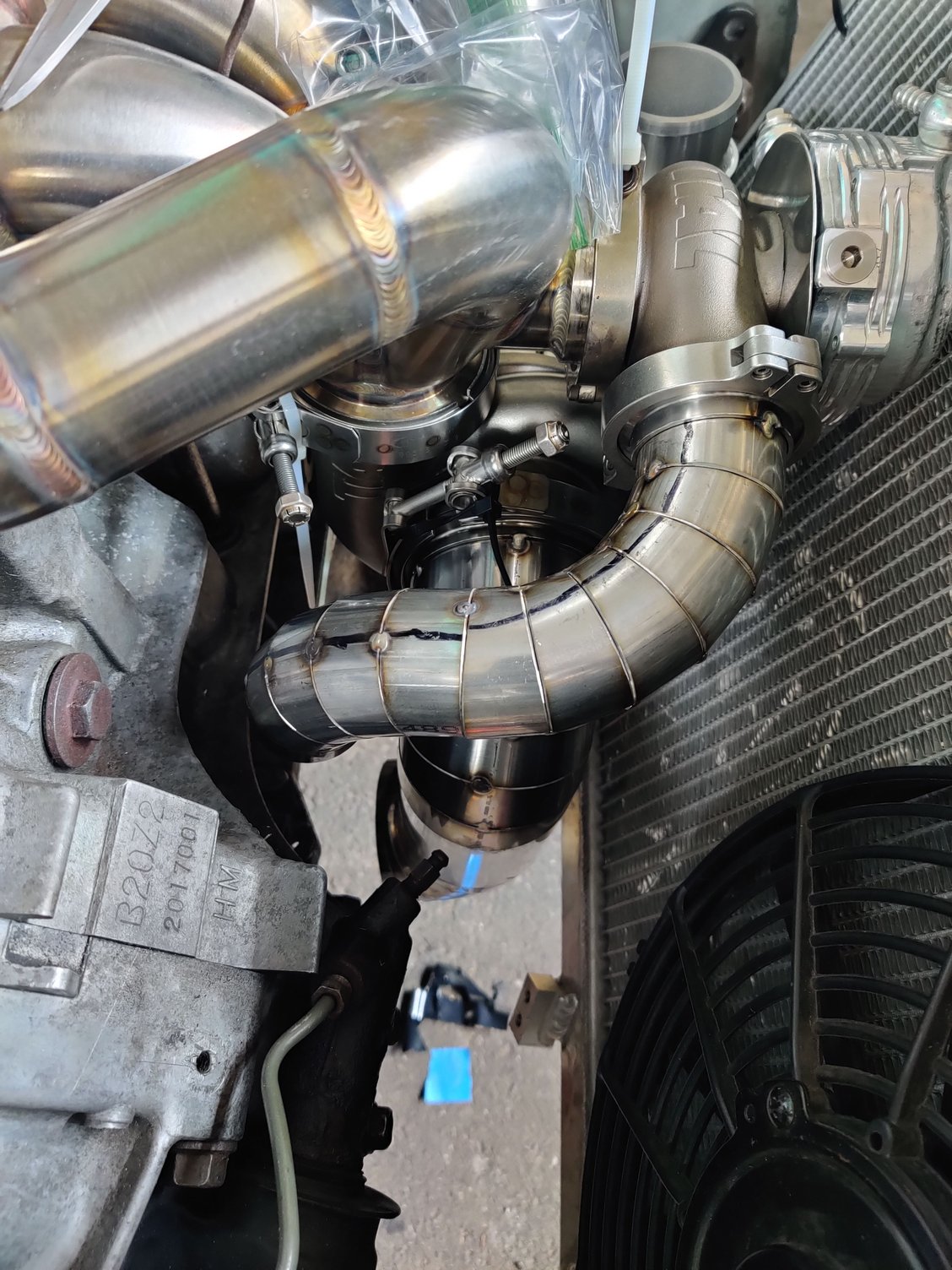

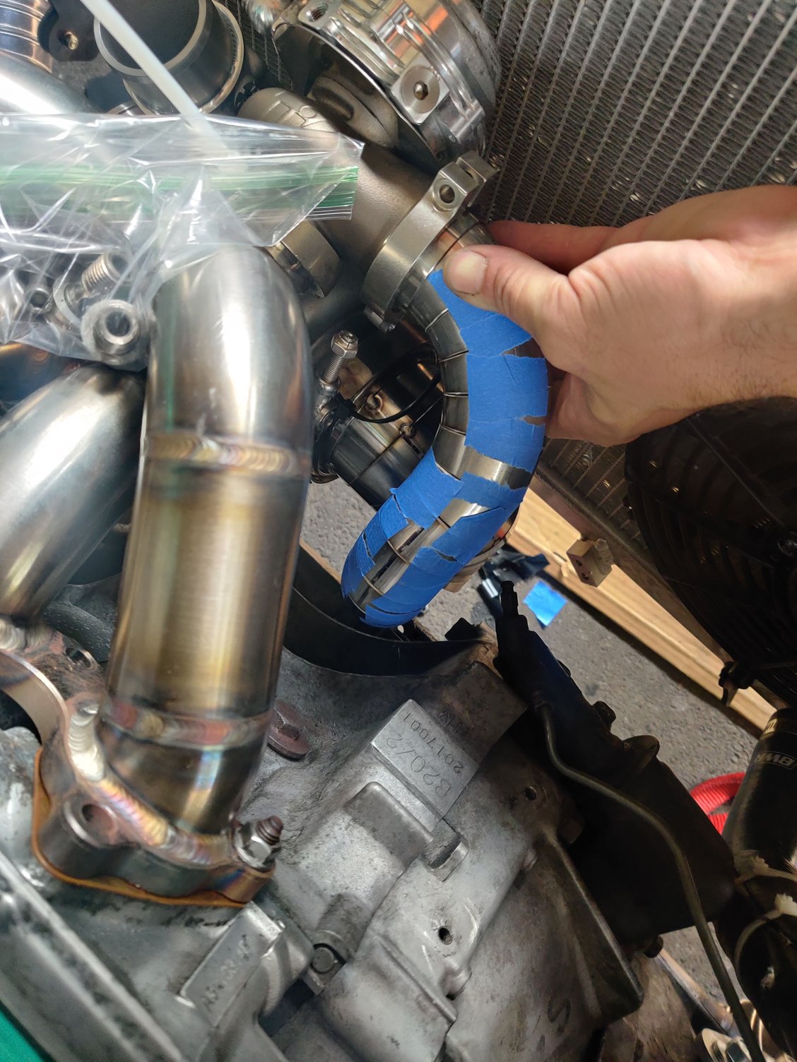

I want to say the flex section on the downpipe is to help get it on and off. Otherwise itll be a really tight fit

Yeah it'll be tight. Weld in place. But vband gives a smidge of play atleast.
I'm stoked this has been going fairly smooth. Been doing a lot of fab this year so guess practice helps. Roll cage not long ago. And the stainless core support gave me the stainless training I needed.
Gotta go find another regulator and gauge to backpurge... Trying to get all the cuts done before too late that way I can weld into the night and not make my neighbors angry.

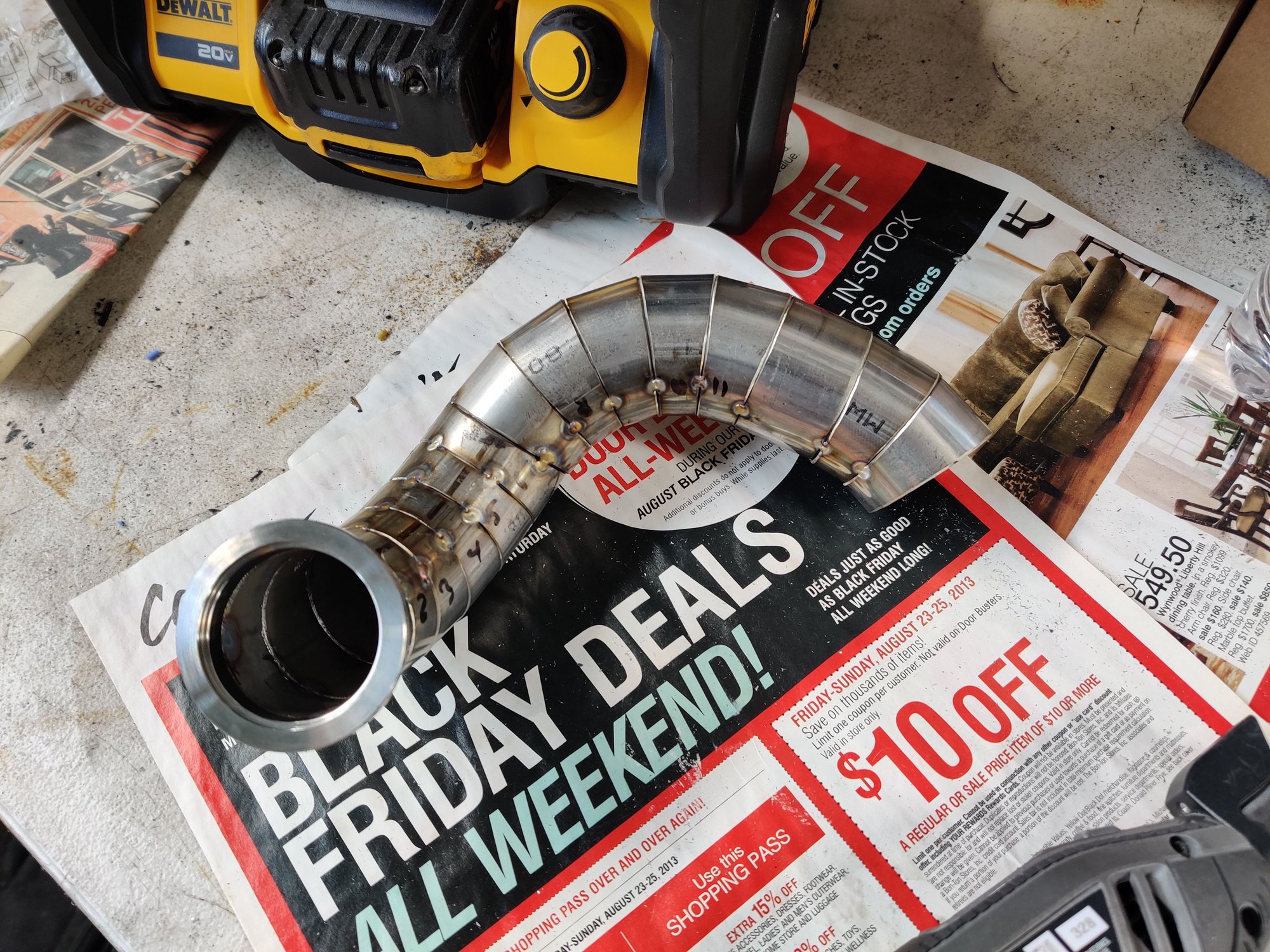

Ive shyd away from using pie cuts as much as possible. Lots of companies offer tight clr bends now a days.
Thats gonna be a lot of welding

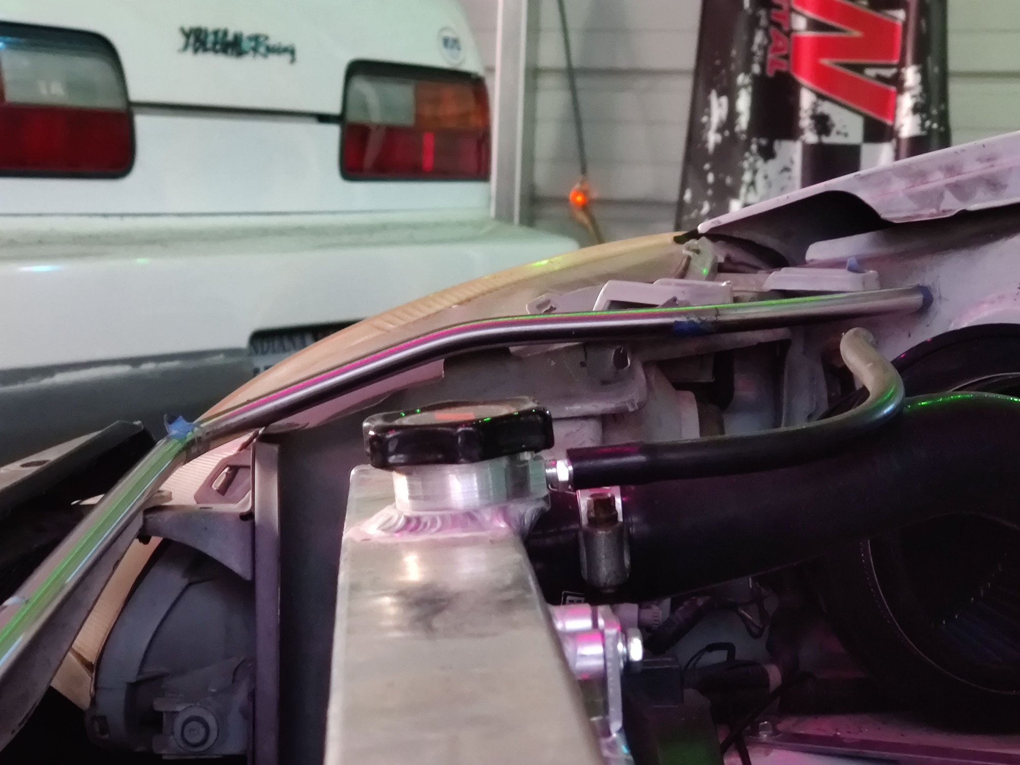

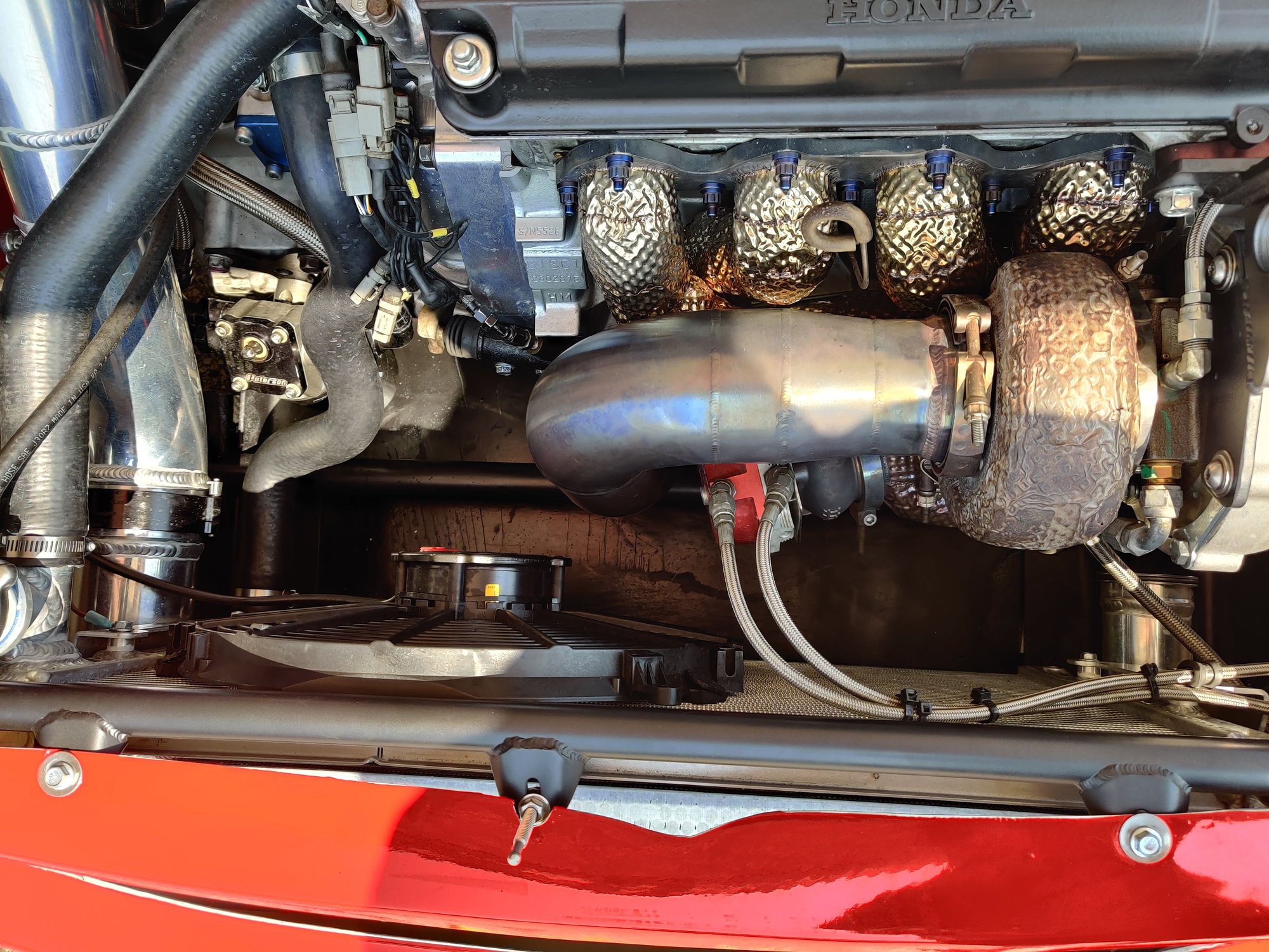

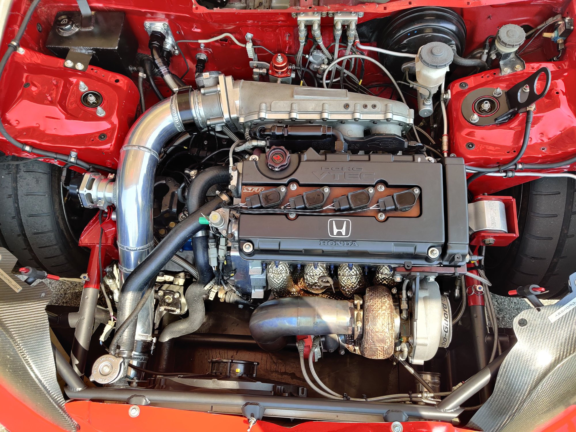

Do you have any room to move the radiator away from all of the exhaust tubing and turbine housing? It all looks pretty close.

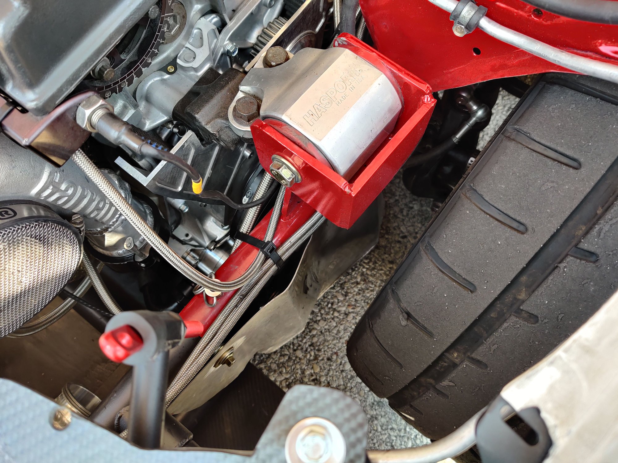

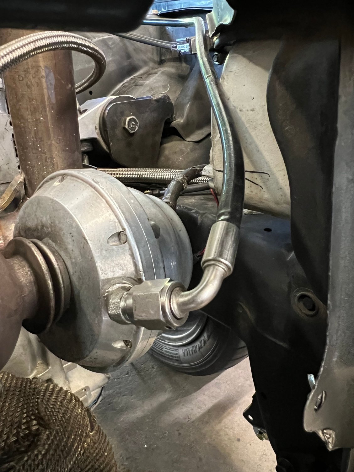

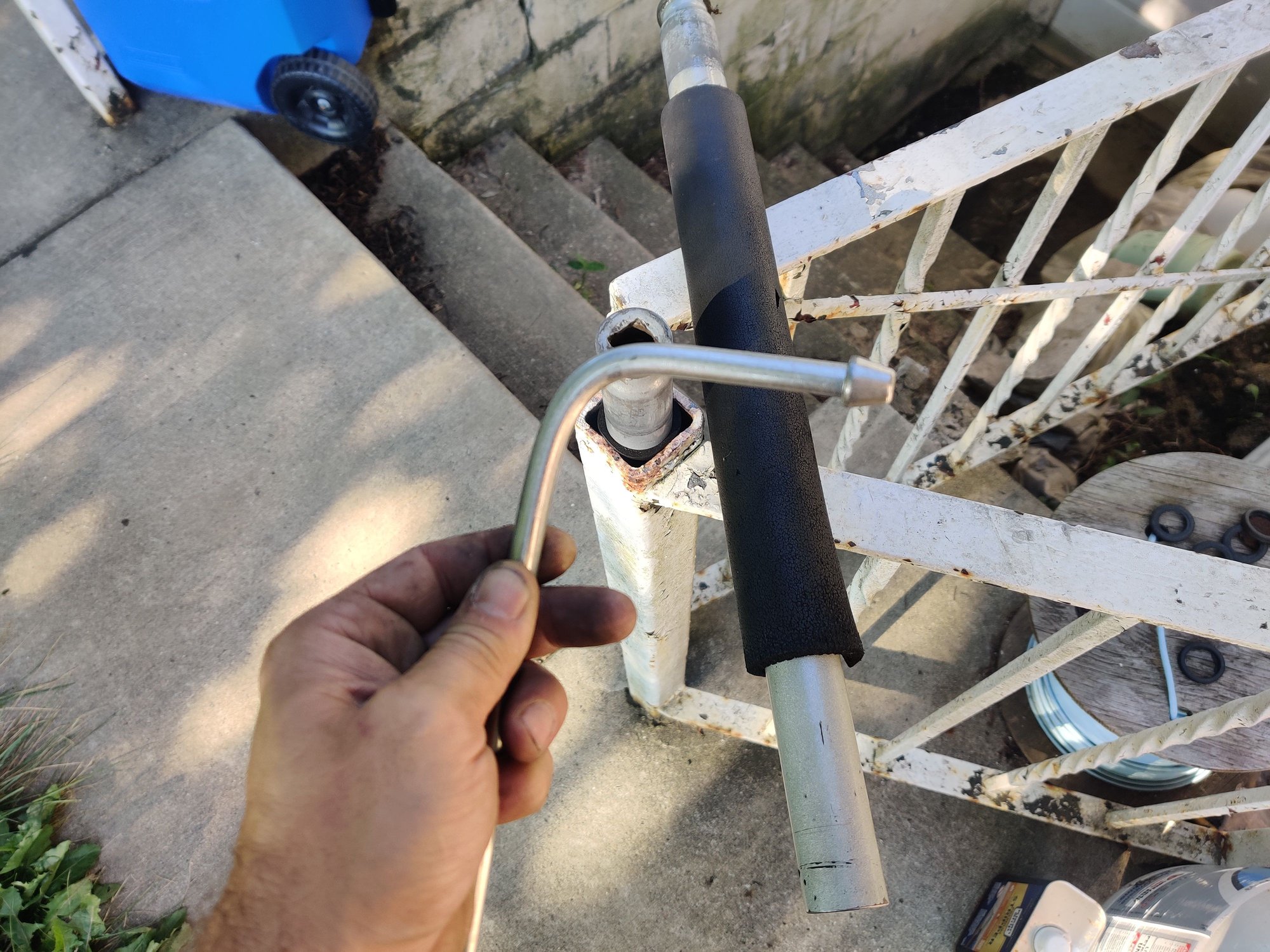

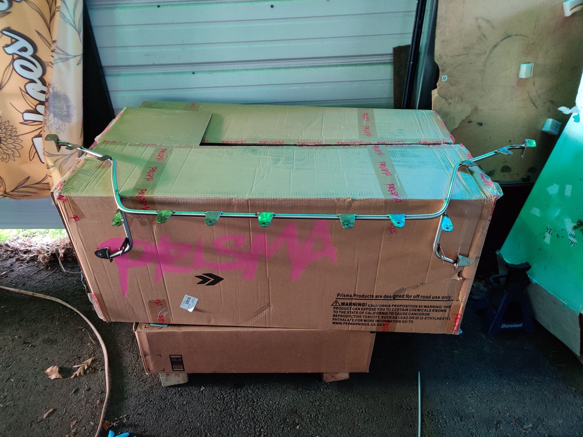

Another thing to watch for is your wastegate vac lines. I use braided steel now since i ended up melting the pvc lines tracking in the summer.

Originally Posted by Pepe14
That's real solid right there.
I've been using HPS silicone hose for everything and they have been ok so far. This will be second time using the silicone hoses to feed coolant to and from the turbo, first time for coolant to the wastegate. My barb fittings arent very long, I will have to do some long neck banjos eventually. But in the past on my heat soaked b16 they didnt fail so I bet they will be OK for now. PVC does sound sketch tho. Those bougie push connect fittings and hoses previously?

Ive had the polyethelene line melt when i was using all steel bodied push to connect fittings on the wastegate. Ordered some plastic bodied ones from parker, no more melted lines. The fittings from parker should be cheaper than vibrant performance fittings. At least with the poly tubing, you wont have to worry about little pin hole or tears in the silicone tuning. I say that, because i had some the extra thick silicone tubing from silicone intake rip and the barb fitting before.

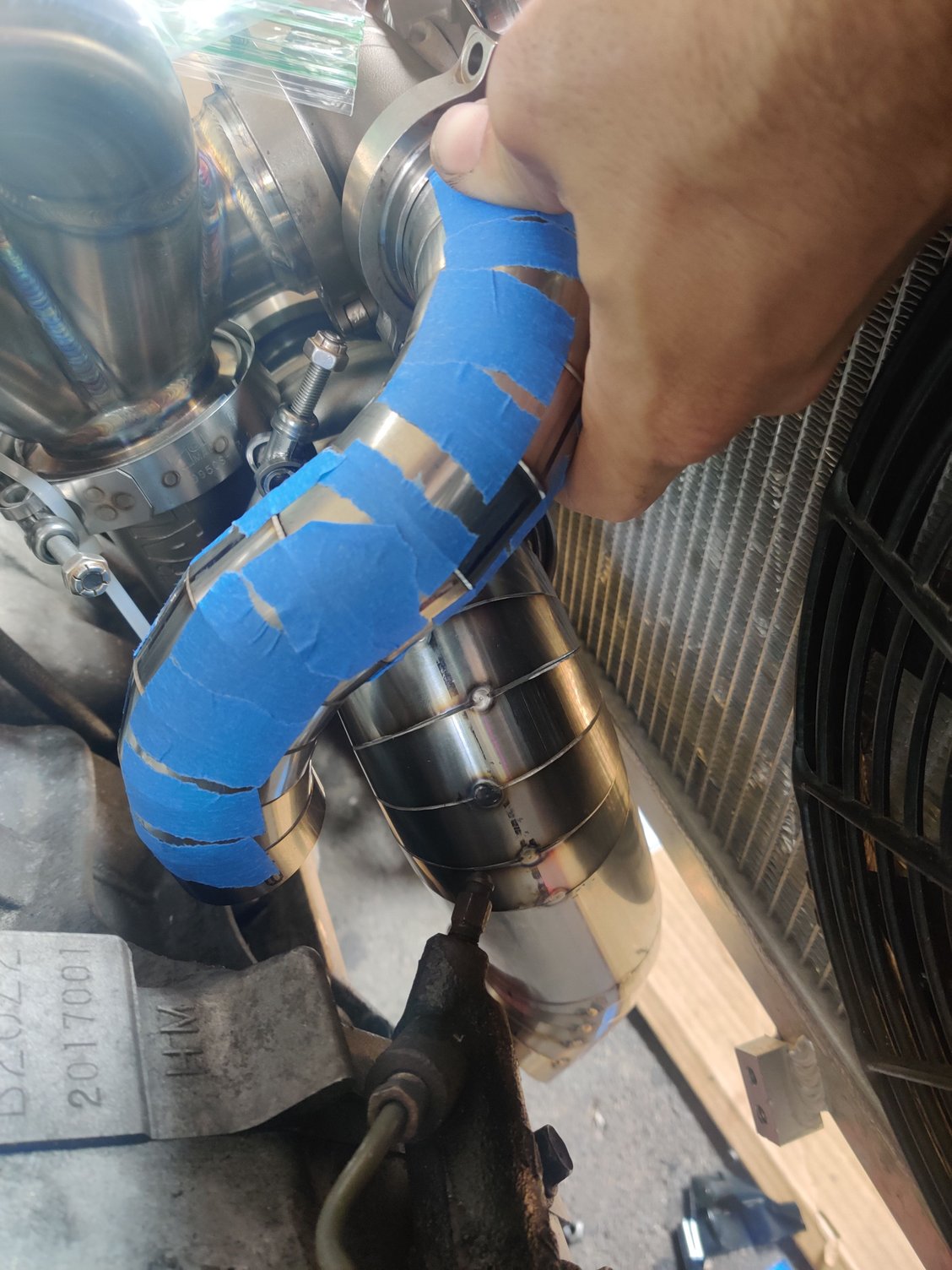

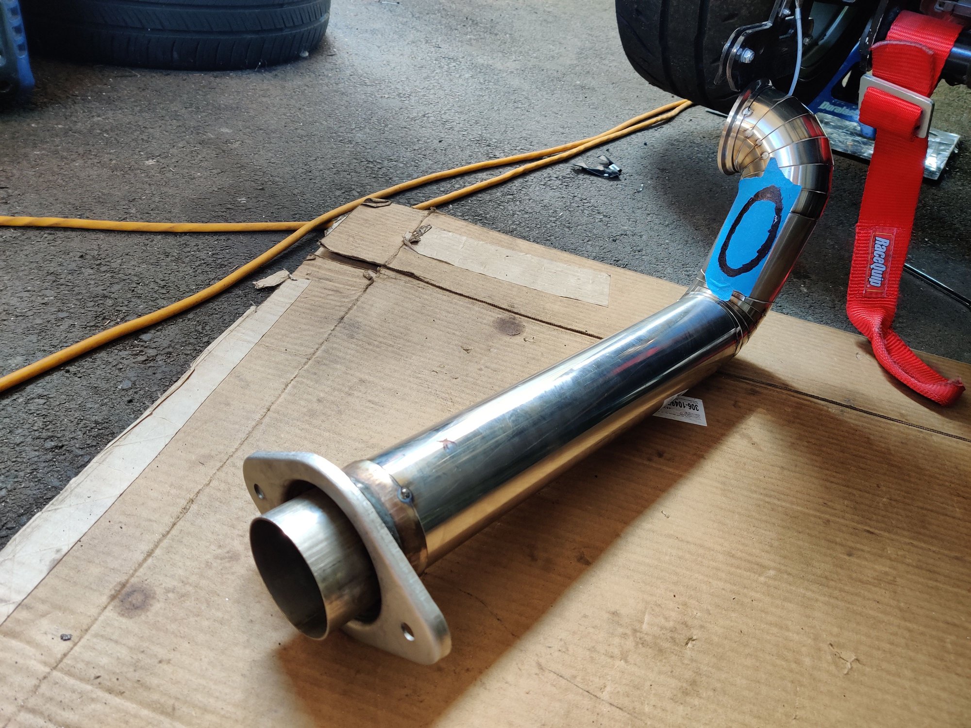

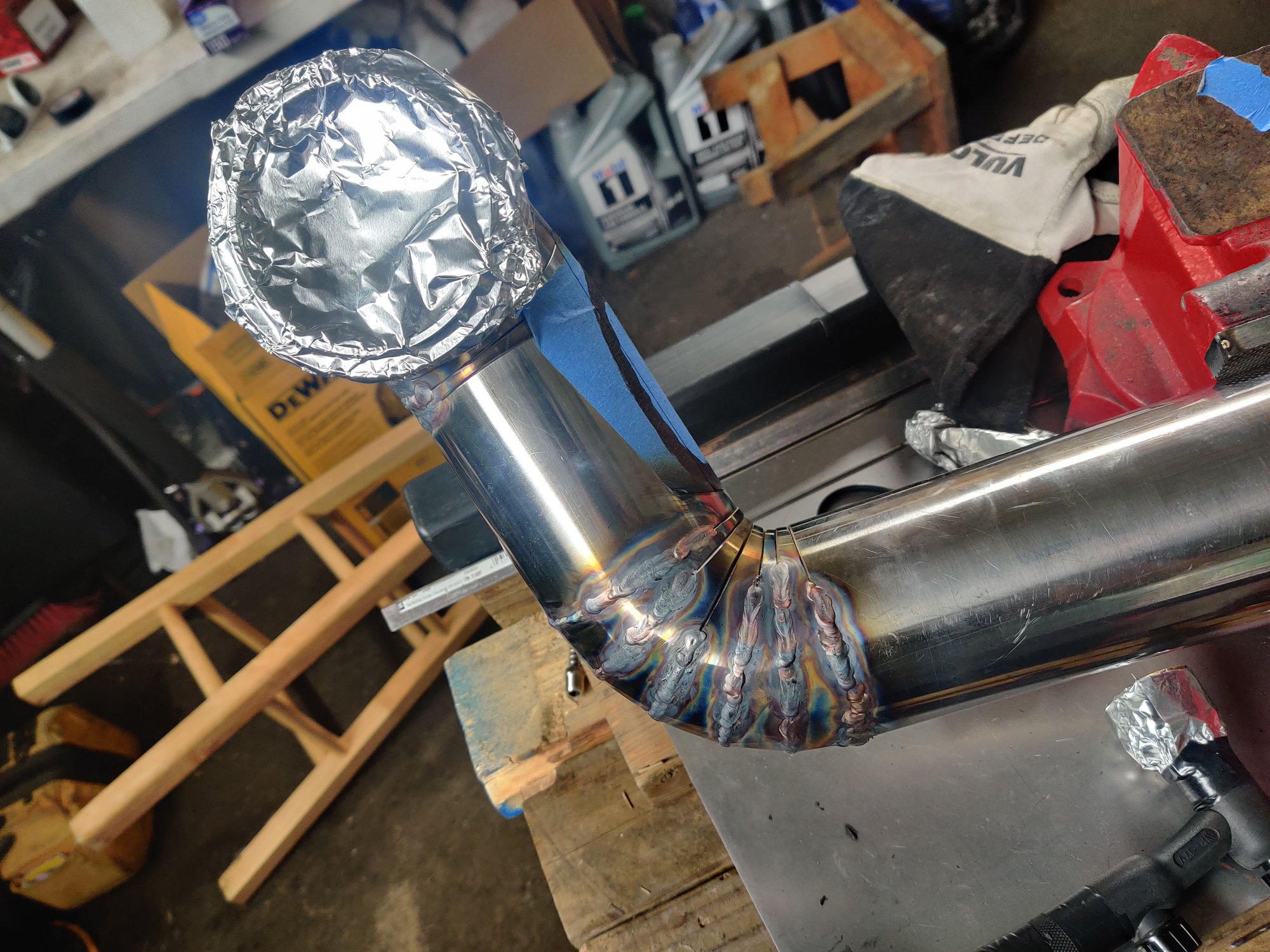

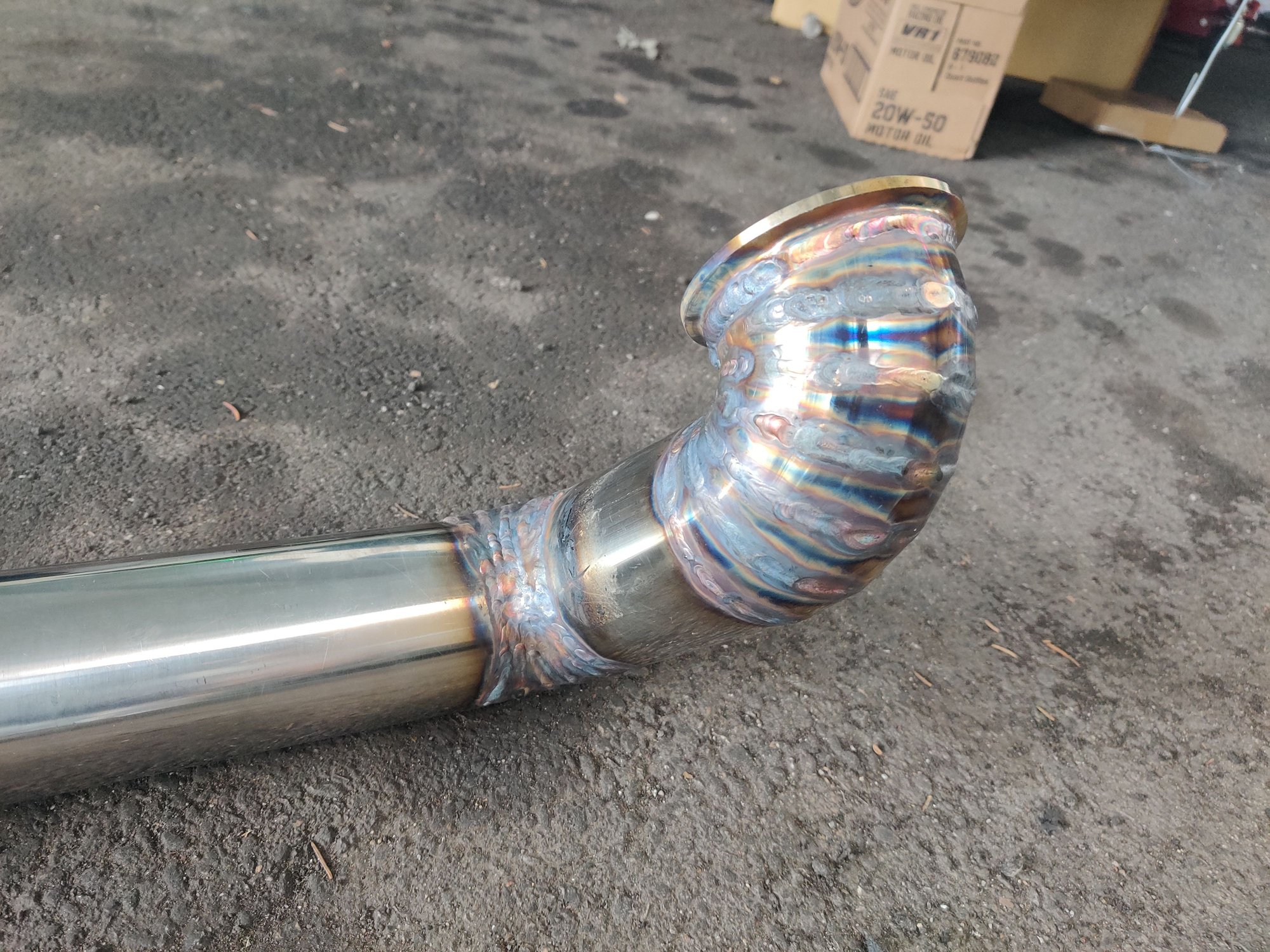

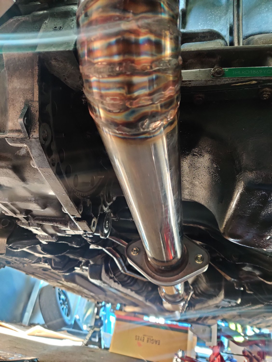

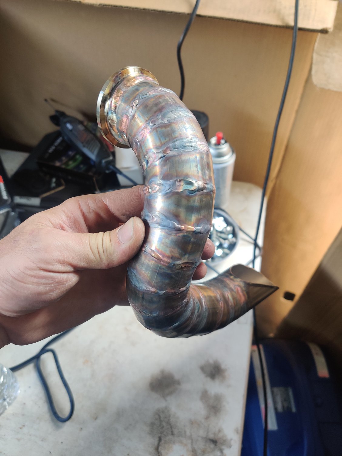

Good progress today. Basically make a turn down for the rear exit, and weld these suckers up. Then I'm trailering the car over to Ron's house, ronsan, Saturday to have him do up the aluminum things.

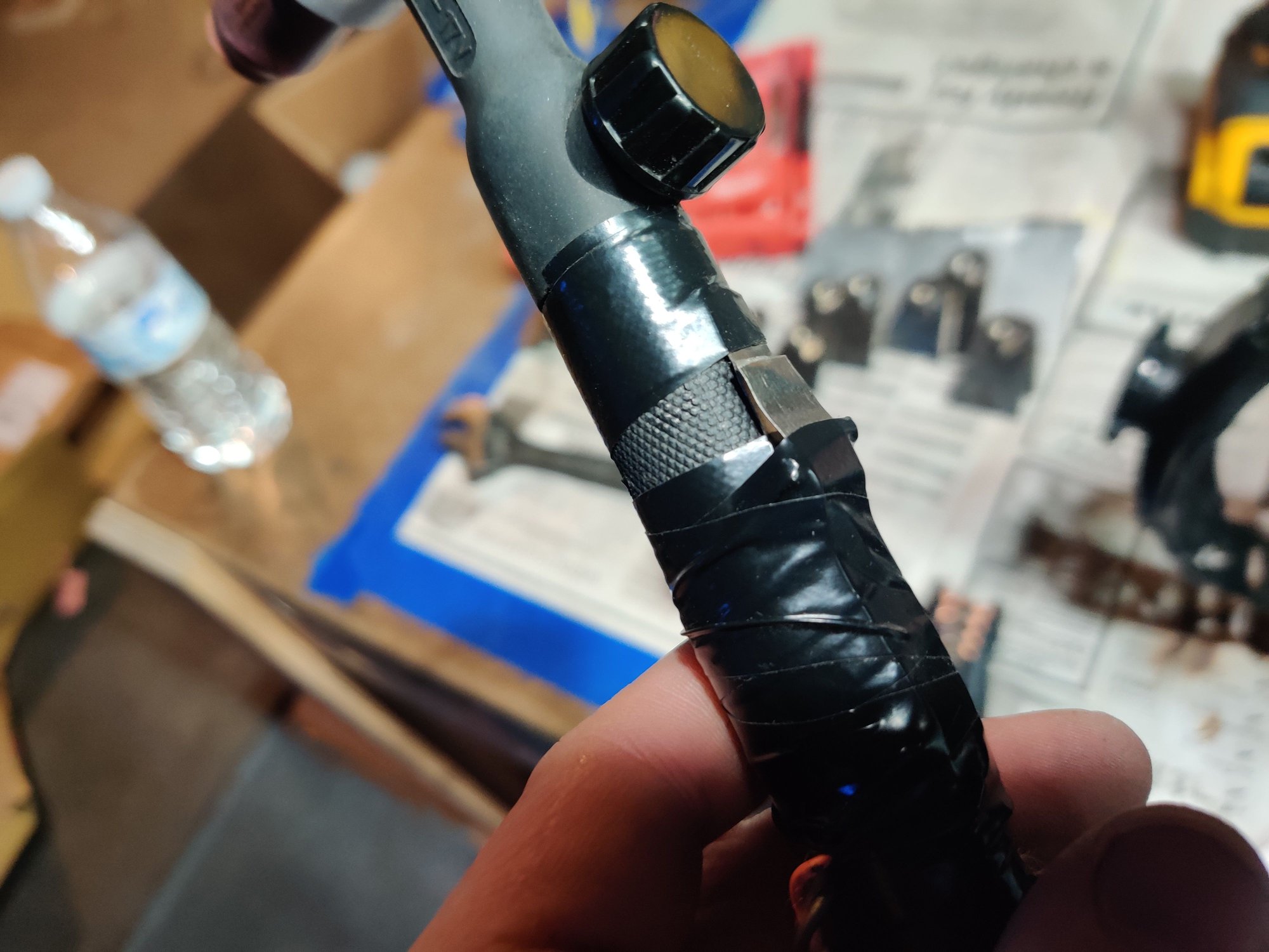

My harbor freight welder is only DC its also only lift to start, no pedal option. So I developed an add-on when I was trying to first weld stainless for my front core support. Lift starting is fine of course but wisk away to stop the arc is not at all kosher with stainless. So using some nickel strips with a chunk of wood skewer in between, some electrical tape (to make a momentary button), 18/2 security system wire, a car battery for 12v more than 2amp load delivery, and a lawn mower starter relay, I created a ground interrupt. So I can stop the arc while keeping gas flow going. I'm overdue for a decent welder with features.
No word from opel/machine shop yet. I want to think thats a good thing. I want to believe they did the line hone and it wasn't a failure so they didn't call me. Hopefully tomorrow is bore hone and pickup!

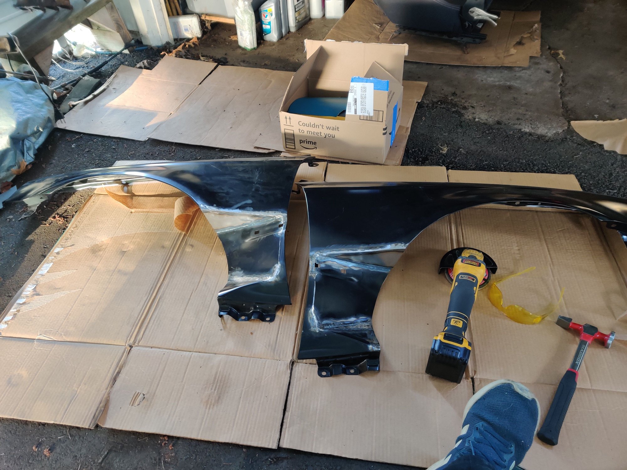

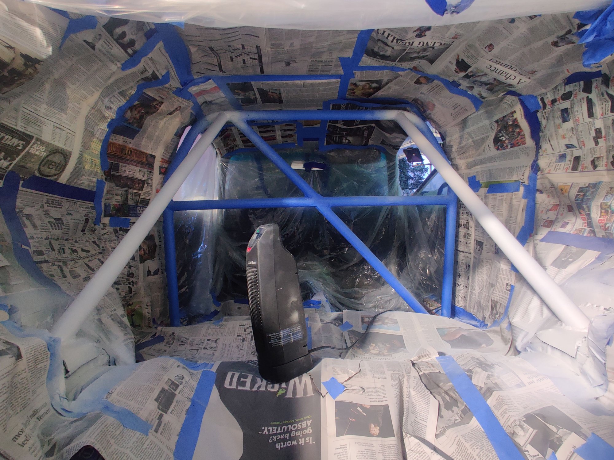

Well I scrolled back for those pics so Im gonna throw some random fab pics from earlier this year. The car was 100% different at the end of last year. This has been a crazy year!
This first pic is February 2nd 2024
This looked soo good will try to fix it again and stick it in my CRX. Future GLTC car shhhhh lol.
I'd have to move the radiator to the other side of the traction bar.
Maybe I'll get a smaller radiator like gears and gasoline just did with Bens EK.
Sitting in traffic I would be worried. At race track speeds there shouldn't be much heat able to move that direction.
Funny thing, at South Carolina I was camped right by false grid, there were many times Ben was stuck in traffic in front of my car. After he wrecked the front end he ended up doing a front core support like me. I wonder where he got the idea lol. Also, the plm one in his video really makes me glad I just made mine from scratch

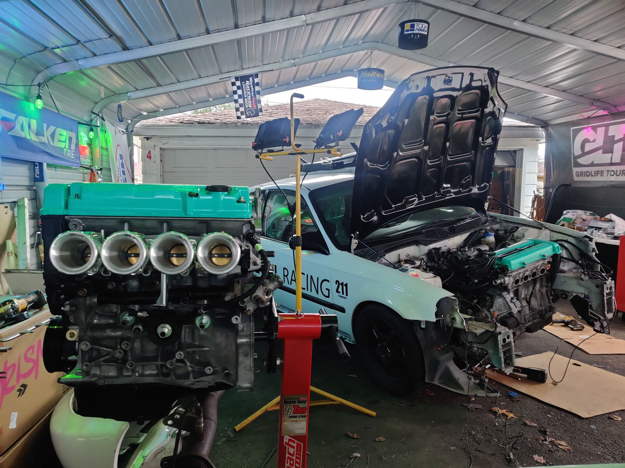

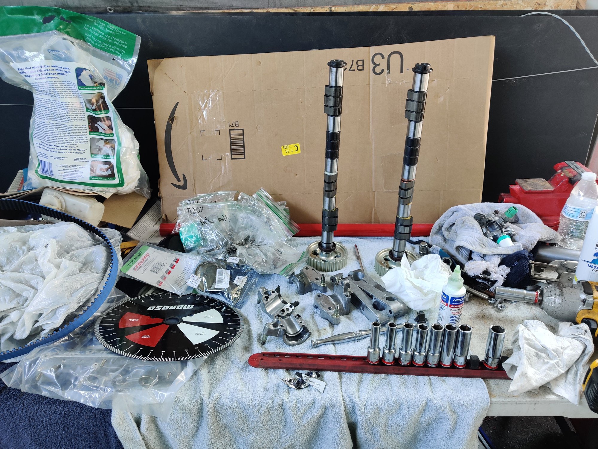

Woohoo block is in cleaning, I'm clear for pickup! 😁🤘
C'mon Nine Lives ****!

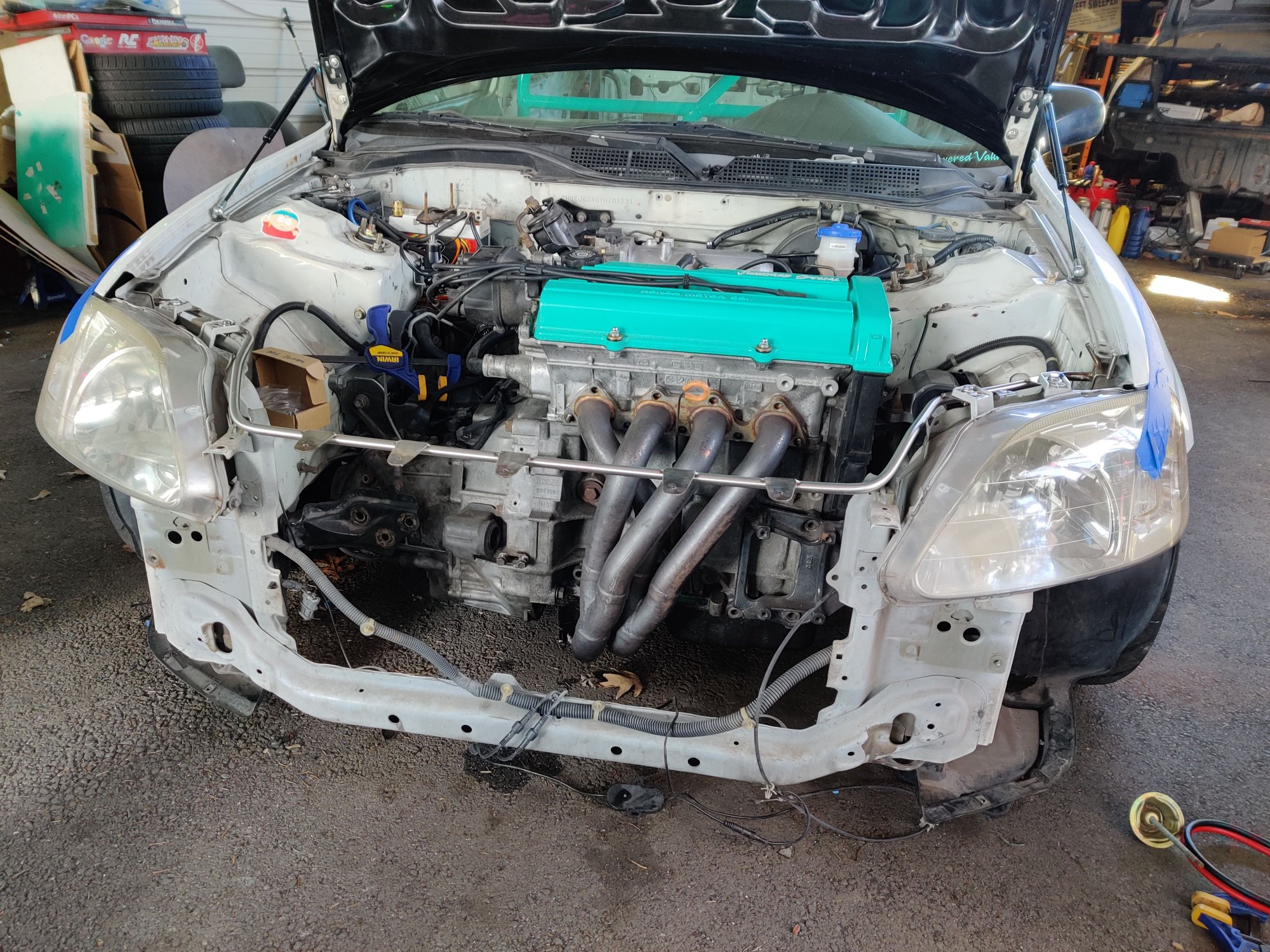

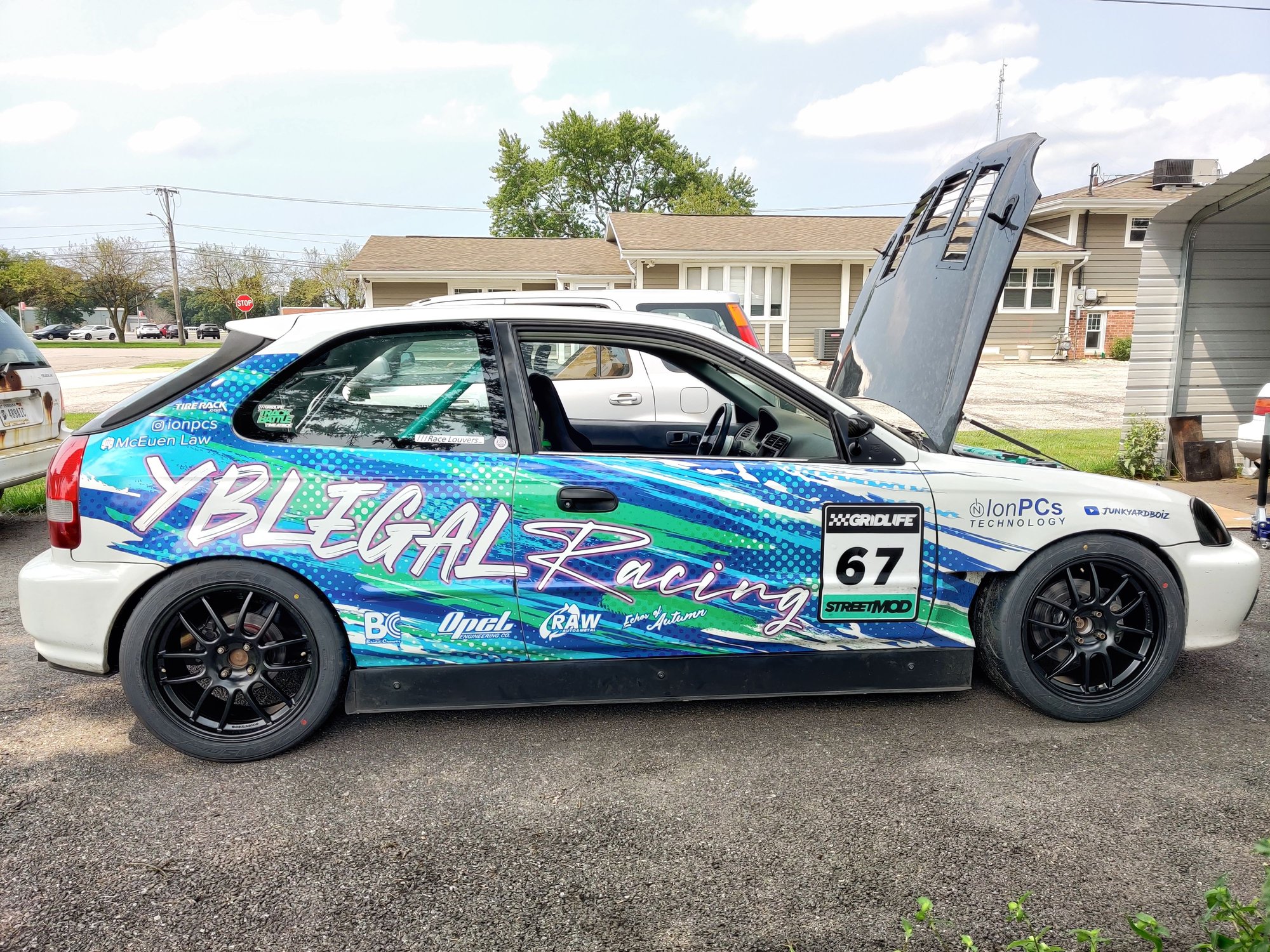

​​​​​More pics, before the last event, Road America, this was this focus:

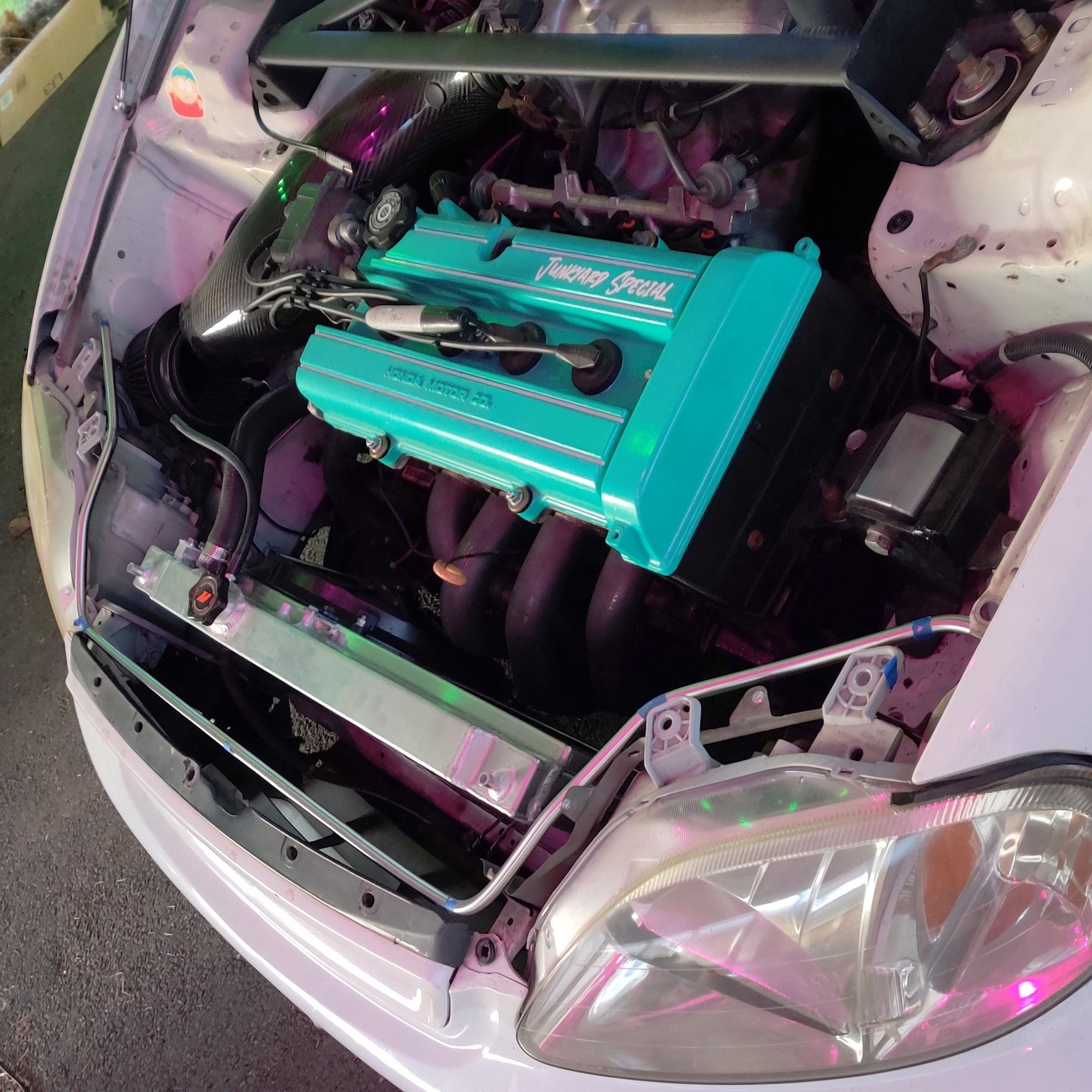

I made the haltech and cop plug n play with the oem harness so I can switch motors real quick, no repinning no goofy stuff. Toss in the p30, a distributor, and it's back to oe spec. The wires that run to the distributor function as my cop triggers, power, ground. Worked out nicely

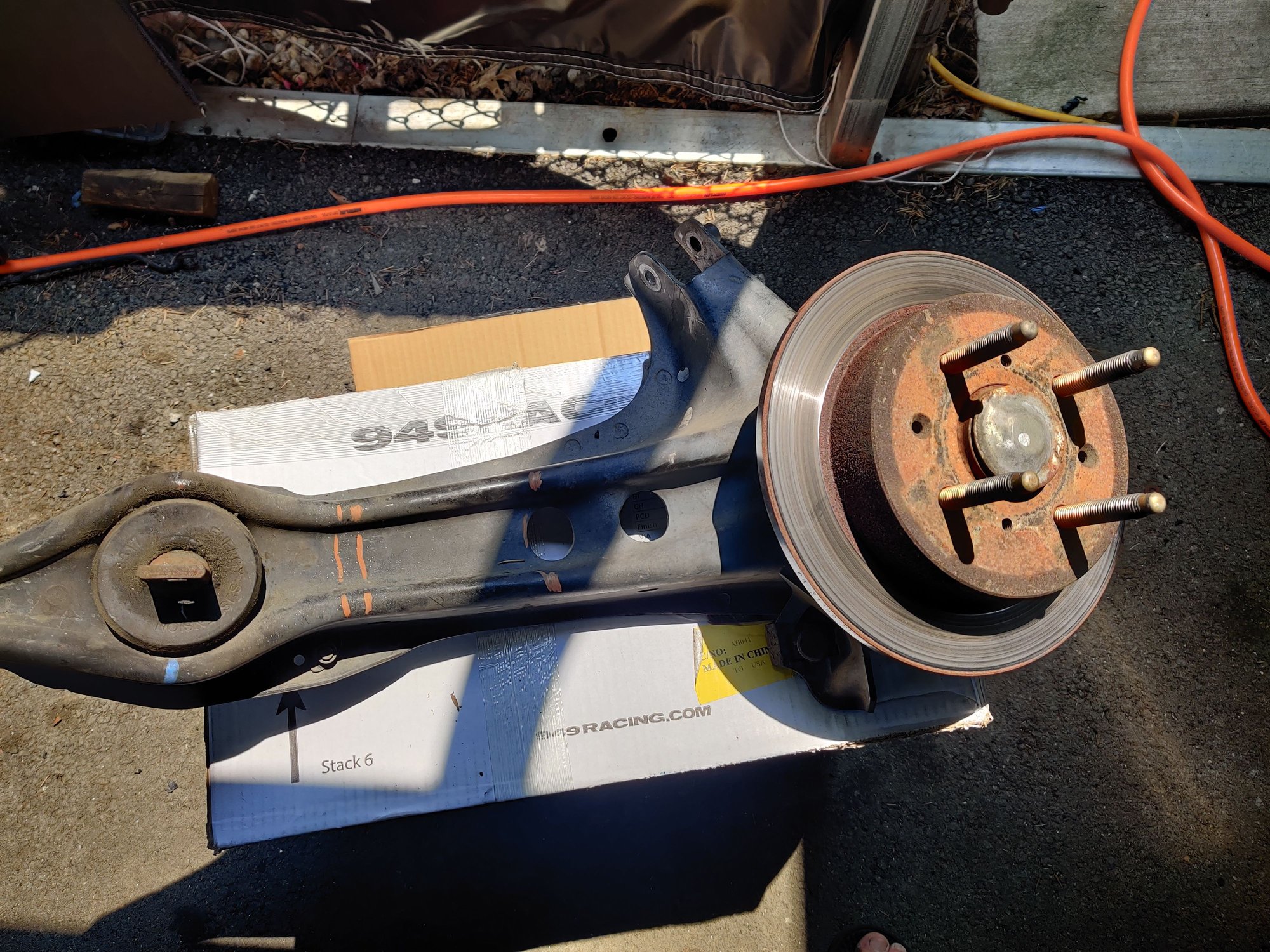

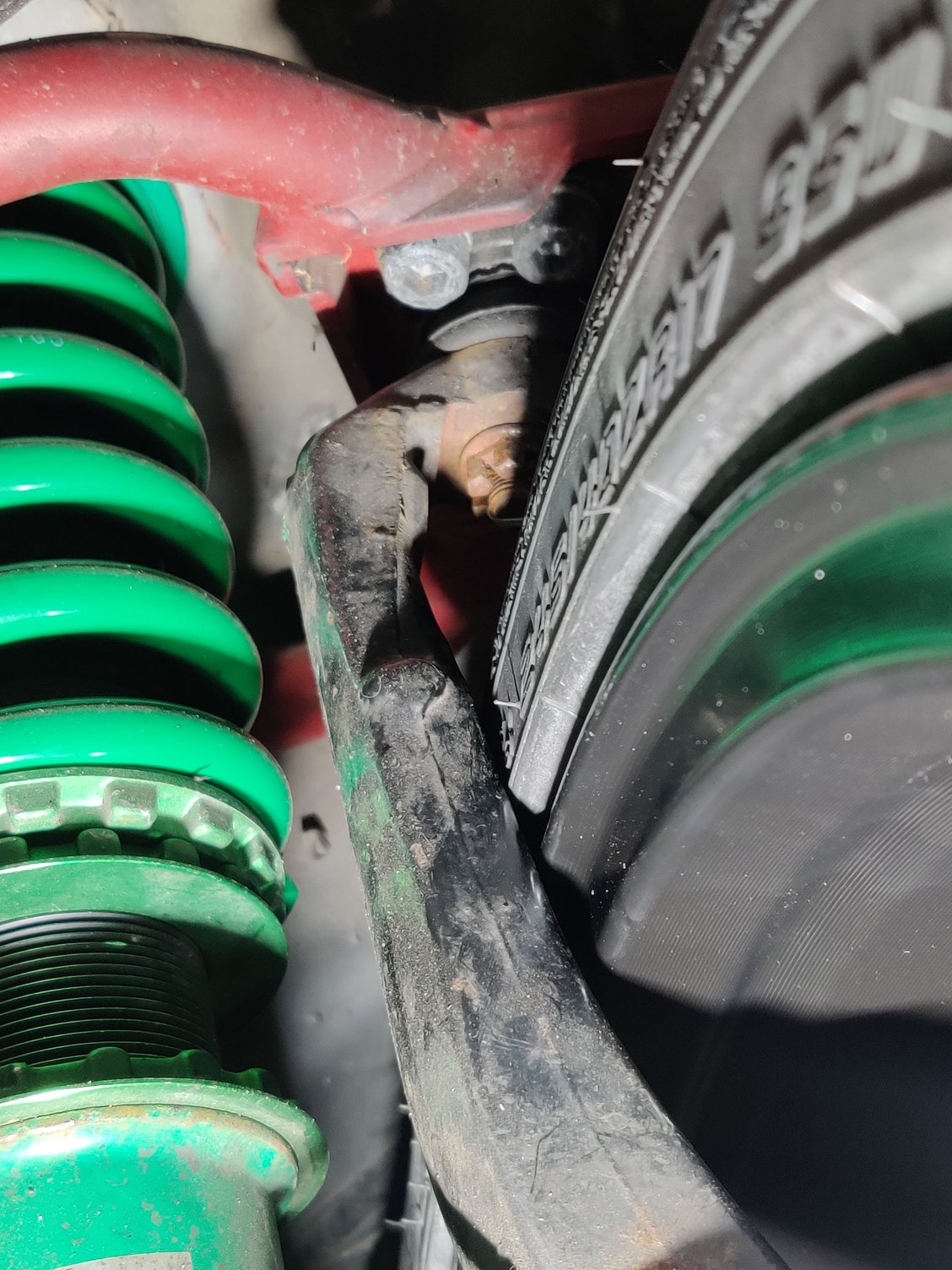

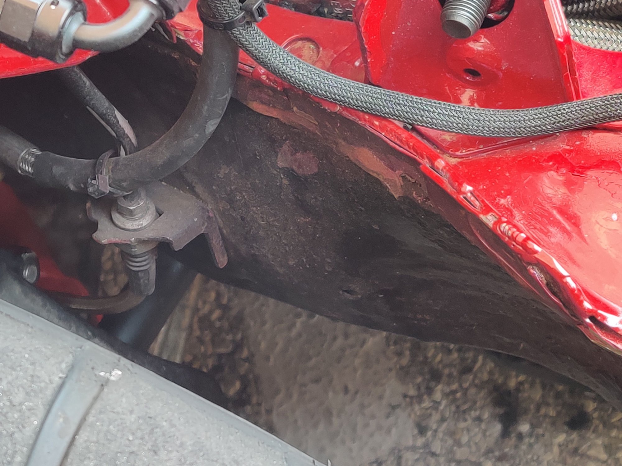

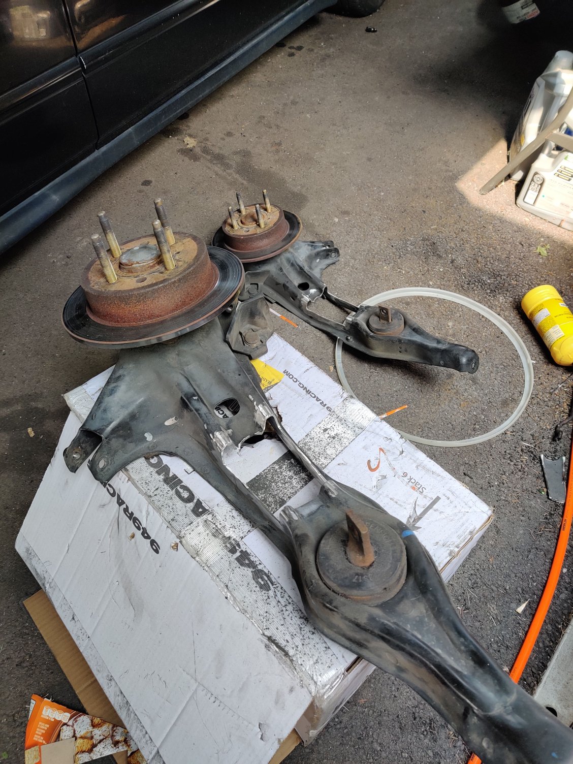

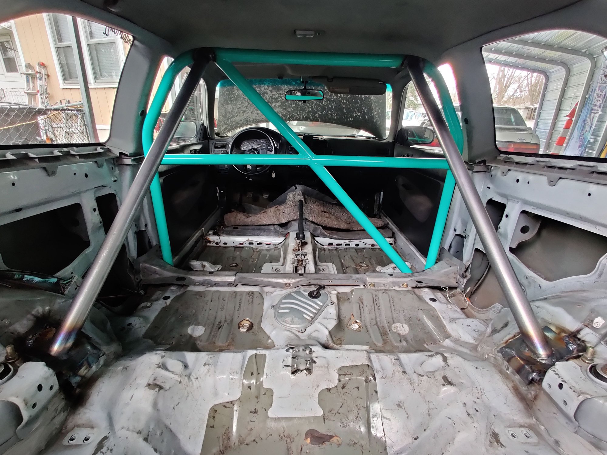

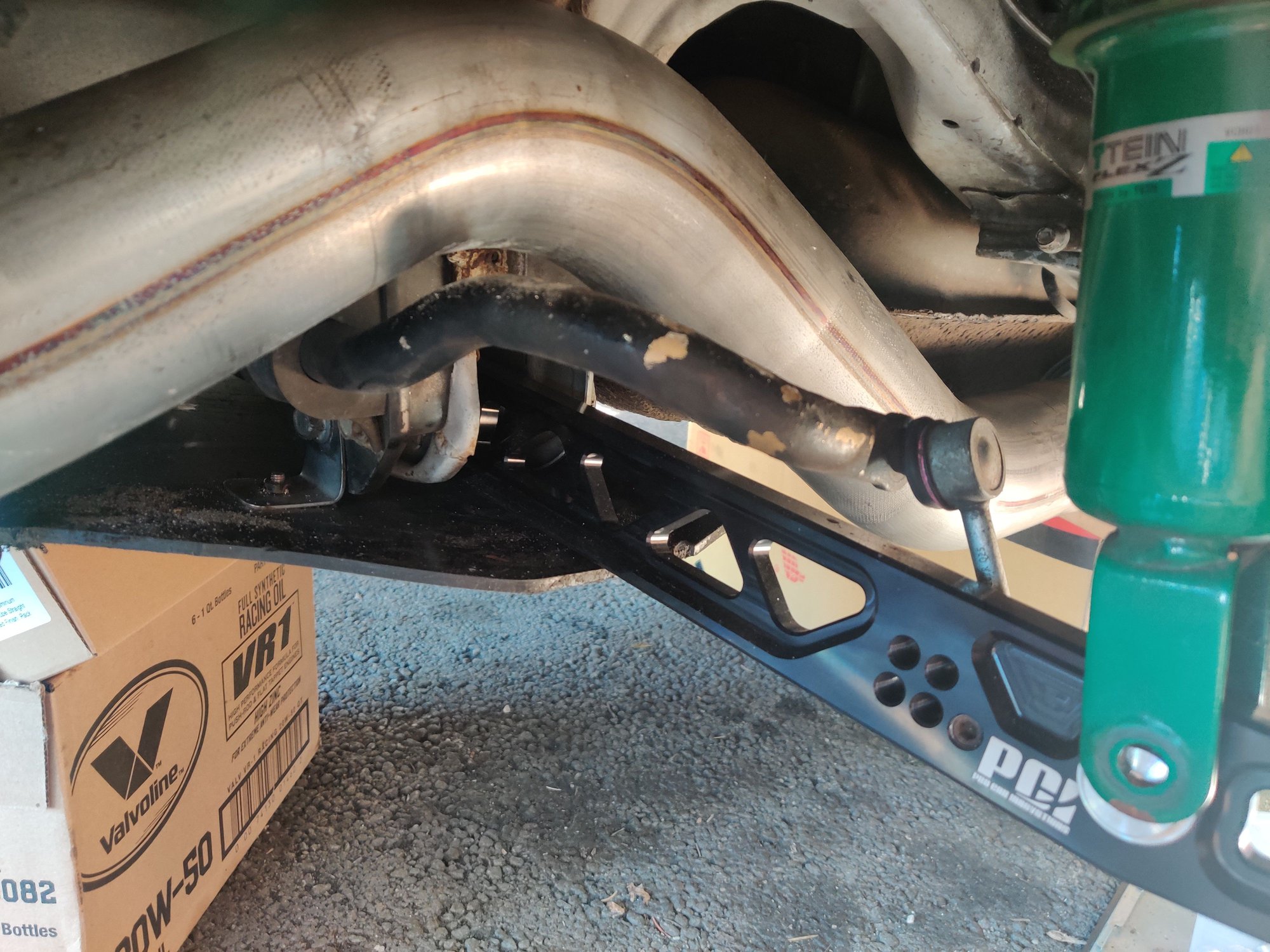

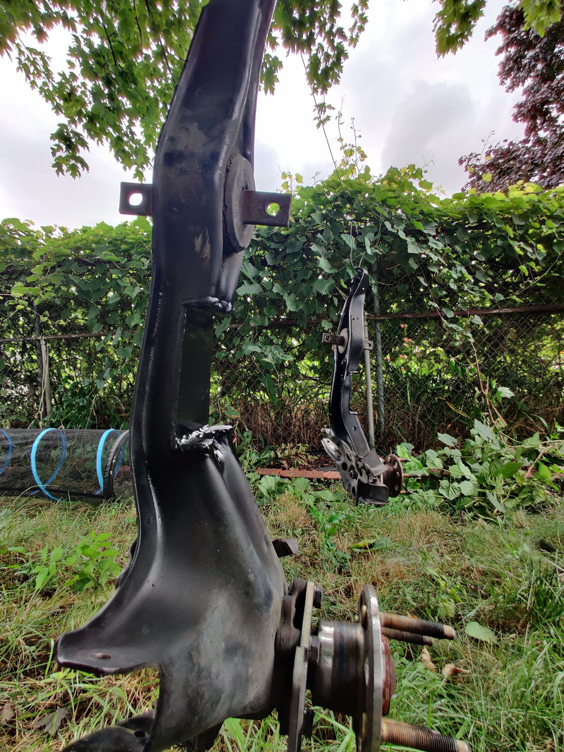

What size are you running up front and what offset? I notched my trailing arms also a few years back. I run 255 squared but with spacers.
Old Aug 9, 2024 | 07:11 AM
  #45
theYBLEGAL's Avatar
Loved
Joined: Feb 2010
Posts: 1,280
Likes: 176
Default Re: YBLEGAL's B20 Time Attack Build
Dang you got me beat.
17x9 +45 245 square but also spacers, 10mm front 3mm rear. Front has slight overfenders I made, rears are rubber mallet rolled. I'm sure I can fit 255 on the front but idk about rear.
You got rear overfenders? Chassis also ek?
My steering range is bleh. Did you clearance anything?
Check out eric lavigne's ek (gridlife road america). Oem pickup points and oem length arms.

Thats Chris’s car. @boersma racing. Ive followed them all for a long time. He runs a 305 i think now maybe larger.
I plan on doing a 3 piece wide front like his once i do a 5 lug swap and can get wheels with better offsets. The +45 konigs are the best i can find.
No over fenders yet front or rear

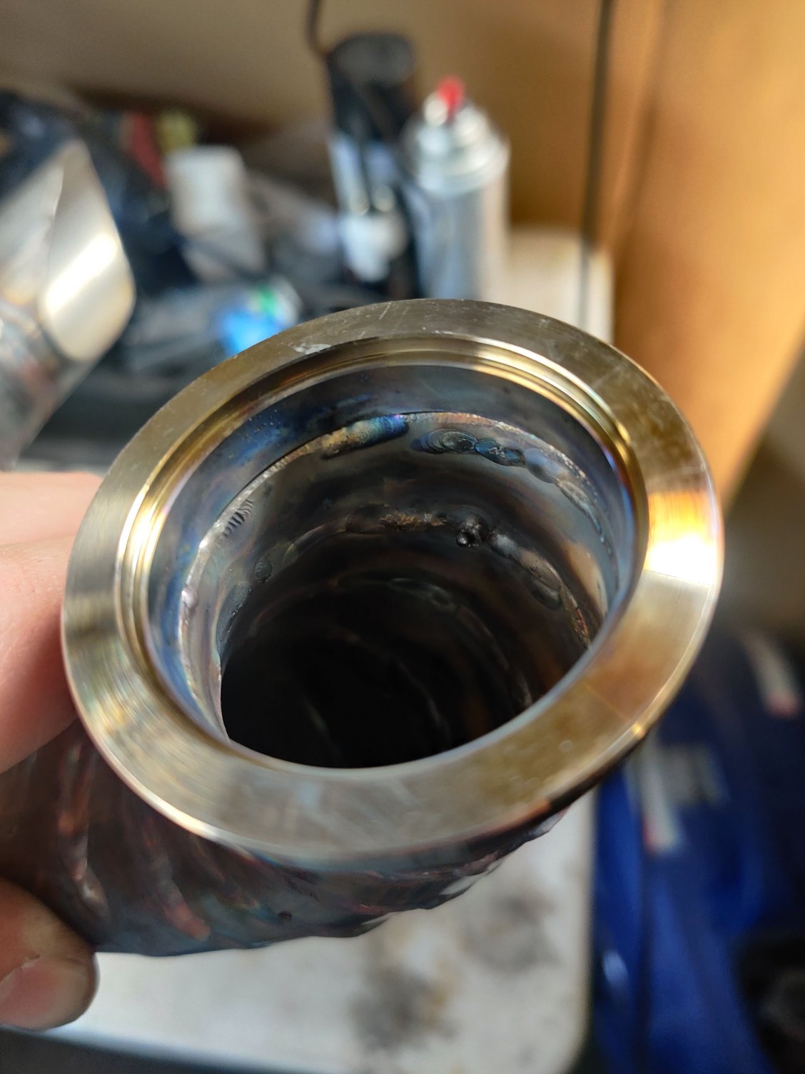

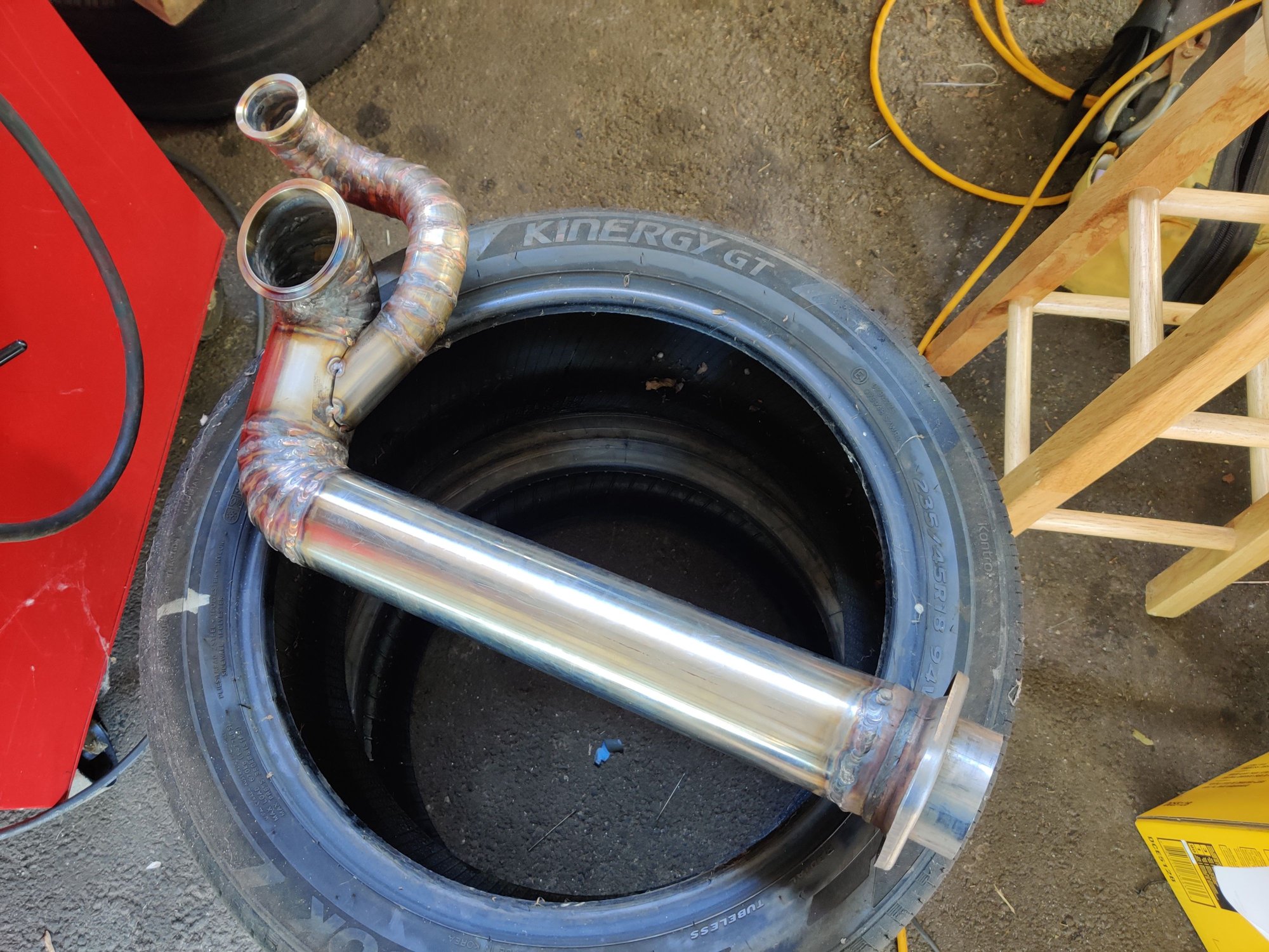

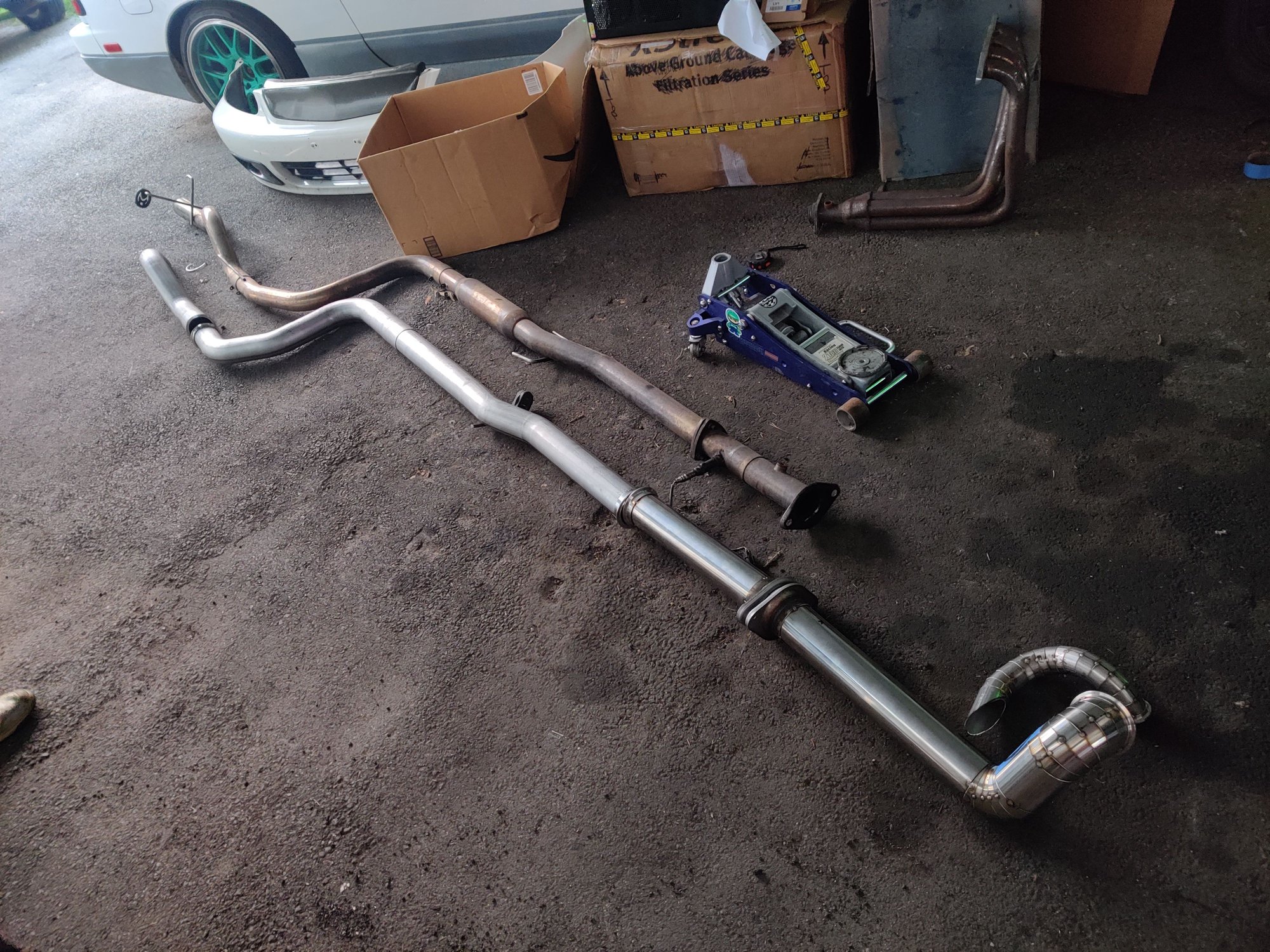

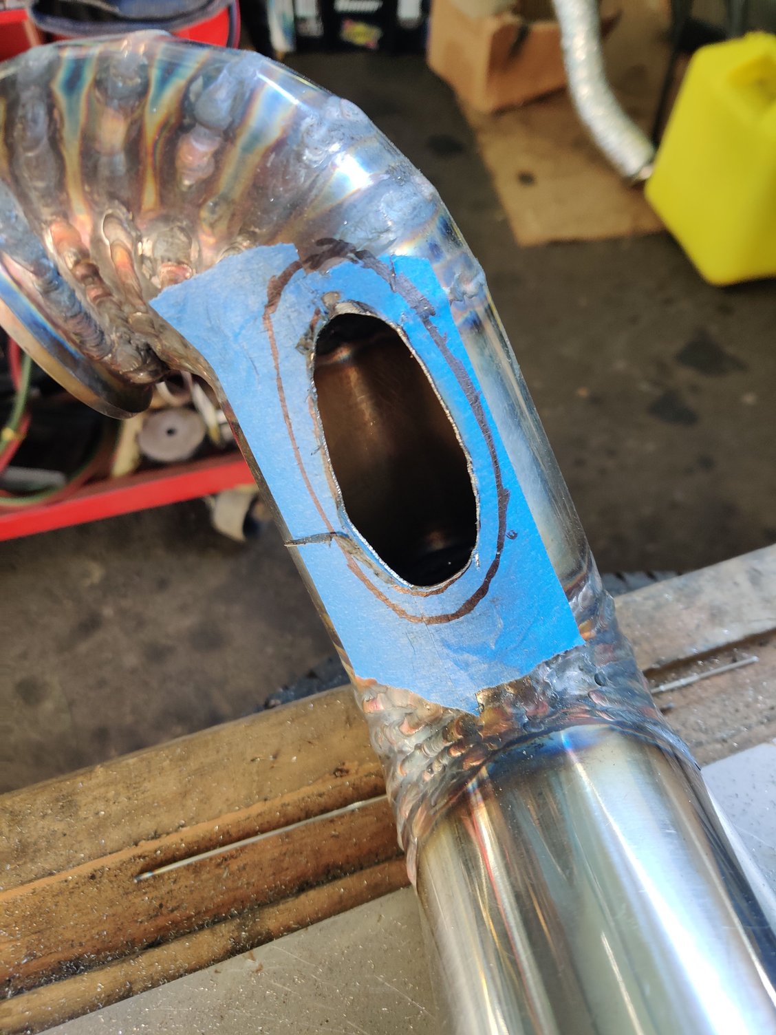

Got pie cut welds done yesterday. Took 4hrs of welding and a full tank. And like I said they aren't beautiful but they will hold. No oxidation.
Got a new tank at 7pm last night thankfully. Last chance for the weekend. So I have plenty to complete the vband welds on the tail pieces and the turn down.
This morning I started early, mounted full exhaust to fit the downpipe and cut and tack. That is complete. Just needs finish weld. Going to go really slow so I hopefully dont mis-align it/warp it.
Math was done and the oval has a greater surface area than the tube diameter. So thats good.

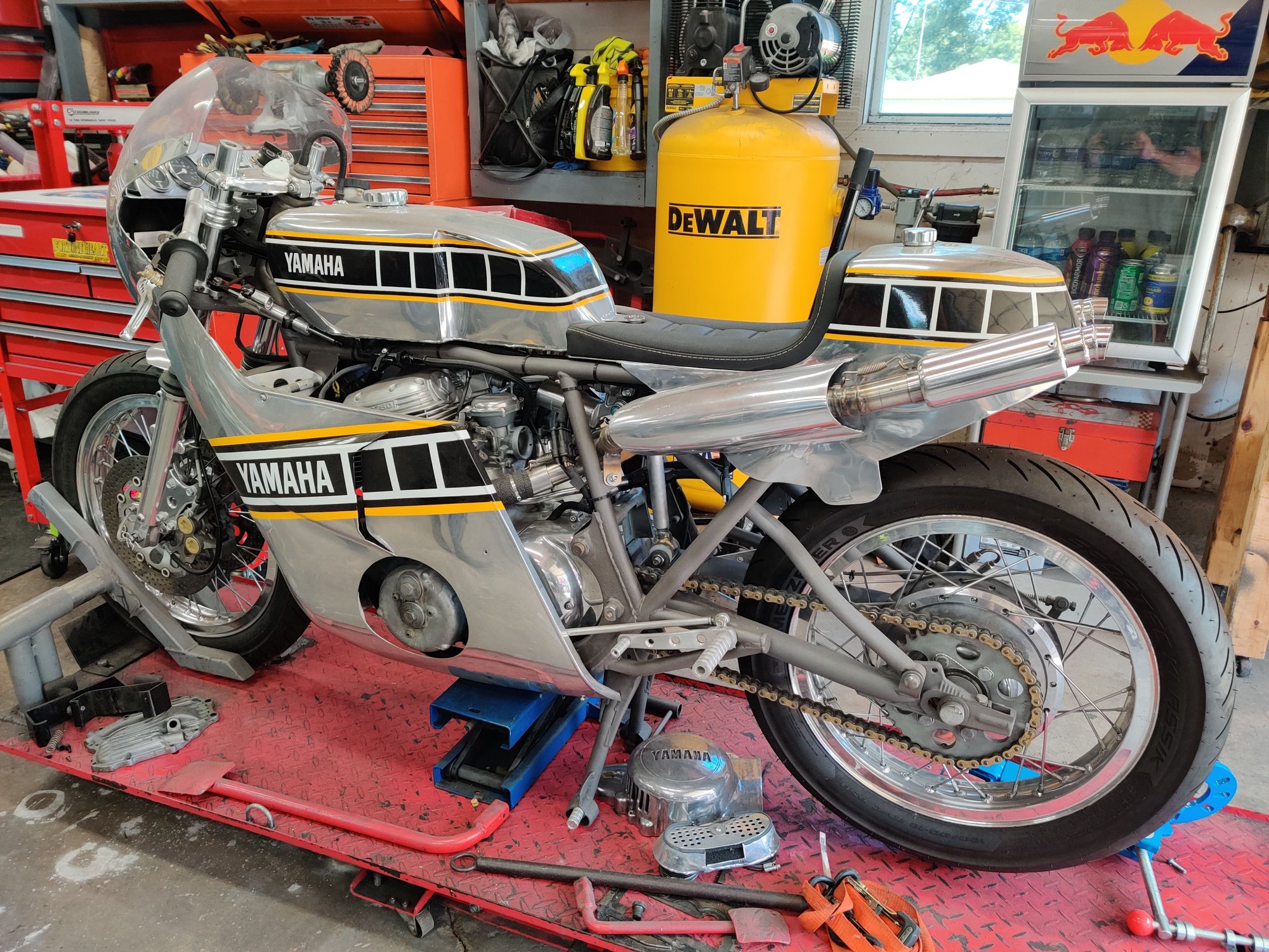

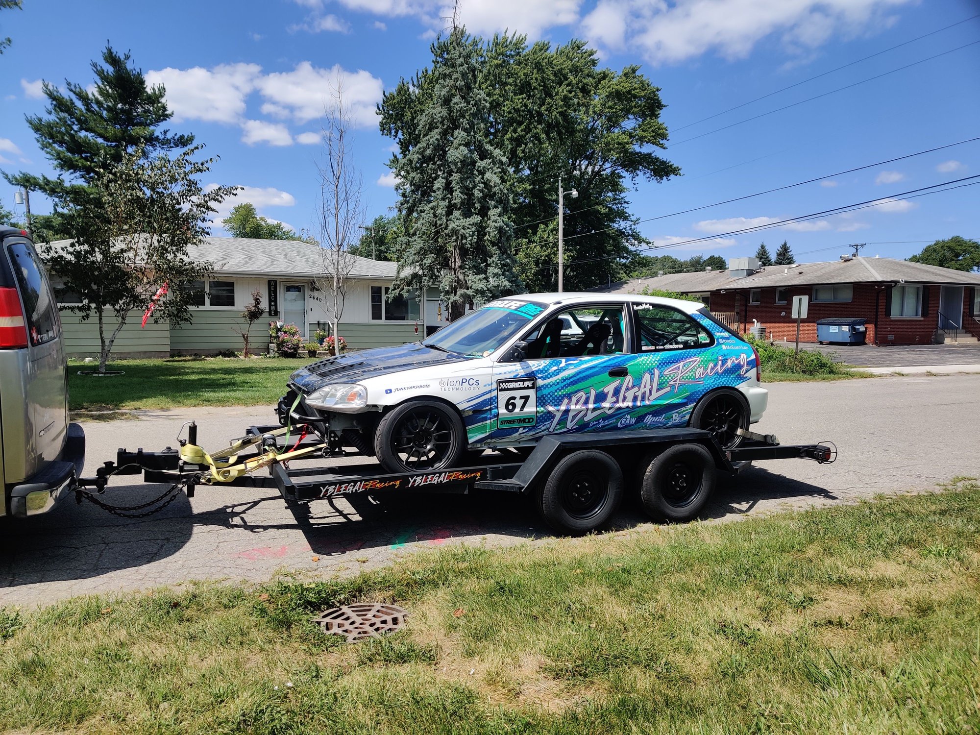

Loaded car on trailer and is now at Ron's.
He did all the fab work to this bike. Car is in very good hands 😊

Im buying you a grinder and some flap wheels for Christmas lol
Next time just fuse it if youre going to back purge. You have a full exhaust with mounts. Its not going to crack.
Old Aug 11, 2024 | 04:22 AM
  #50
theYBLEGAL's Avatar
Loved
Joined: Feb 2010
Posts: 1,280
Likes: 176
Loll. Yeah I wasnt too sure about just fusing it. The fit was good. I started fusing but I wasnt sure how strong it would be that way. Oh well its def strong.
​​​​​​Making a downpipe isn't too bad if I gave myself more time. Learning!
