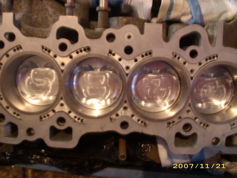

Can anyone tell me what sleeves these are? i tried searching google images but can't narrow it down. Im not trying to get bashed, i just found a really good deal.

Either an AEBS sleeved block, or a CSS stock sleeve block.
Do you have close-ups of the sleeves?

looks like a AEBS to me

after furthering googling, I have to agree, that this indeed looks like a CSS block (block guard)
reason being is that the AEBS sleeves are one piece, sleeves as well. As you can see in the OP's pic, you can see the sleeves are separate from the block guard around it.
you can get a css block for roughly 500~ total, shipping including.

Everyone who has posted so far would never make a good investigator. It's not a css block or aebs. Look at stock sleeve pics closer, it's not what those are.
How can you call anything a good deal when you don't even know what it is ???

its a b20 css block in the pic

LOL it's not a CSS or B20 sleeves. The gaps are wrong for a CSS install and the B20 sleeves aren't cast correctly. Keep guessing!

It looks like stock sleeves, not even close to AEBS sleeves, ( Stock sleeves with CSS block gaurd).

I compared this blocks coolant ports to css, the ones between the sleeves and its a straight drilled hole. CSS has a curve to it.
CSS
http://i166.photobucket.com/albums/u...3/IMAG0781.jpg
all other " sleeved " blocks i saw on google are straight machined drilled. If that makes sense..

They are not stock sleeves, see how the cylinder liners contact in between? B16,17and 18 all have aluminum cast in between the liners. B20 are siamesed together but not like the block in the photos. It's a sleeved block but who did it will remain unknown. As for my opinion, I would avoid that block and only buy stuff of known quality from reputable sources.

or its a darton dry sleeve with flange and css blockguard. dry flange cylinders contact other cylinders.
and here with block guard

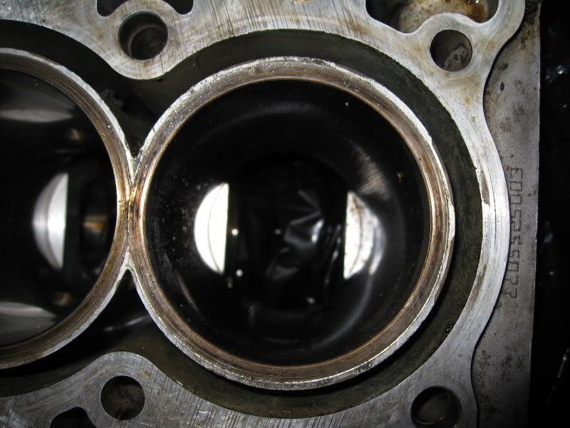

http://img.photobucket.com/albums/v4...407_153723.jpg
http://img.photobucket.com/albums/v4...407_153738.jpg
http://img.photobucket.com/albums/v4...407_153746.jpg
http://img.photobucket.com/albums/v4...407_153743.jpg
http://img.photobucket.com/albums/v4...407_153750.jpg
Shitty lighting, shitty phone. thats the best i could snap today. i Check the bearings, std acl, no scaring nicks nothing on them. surface rust like a bitchh though. everything else looked okay.

Stock sleeves with block guard(has been decked).

Once again, they are NOT stock sleeves. It looks like a dry liner. Please do more research of what stock sleeves look like.

Is that close-up pic the same block from the original post?
If so, definitely looks like dry sleeves/liners/inserts with a machined block guard.

so its aftermarket sleeves with a " machined block guard?" what the hell. lol
