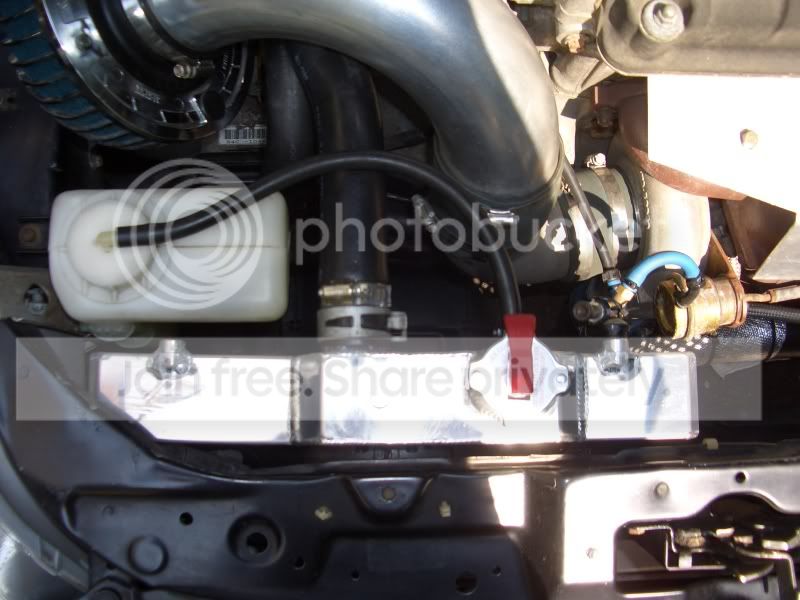

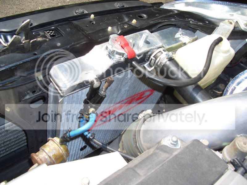

JDM_Risa's Avatar
Posts: 1,704
From: San Jose, CA, USA
Default Re: (DJ Gurgla GSR)
Koyo Half-core
FAL Fan well worth it investment...its designed similar to stock yet better with a foam suction and has a slim housing to force the air...thus cooling the entire
radiator... bolts on directly like a stock fan would...
Fan Switch Jumped to stay on all the time...it takes a bit longer to warm up
Prestone Kragen Radiator Cap
60% water
40% Prestone
