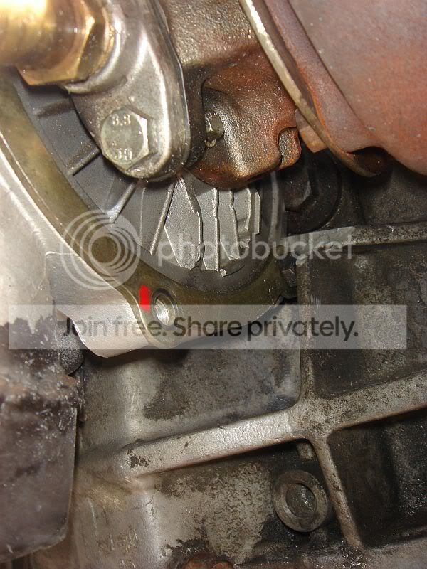

Let me guess, your problems look like this.
Basicly, you have a manifold designed for a 5 bolt T3 exhaust housing. The turbo will not fit unless turned around. Don't bother cutting the block..it doesn't help.
Time to find another mani or ditch your full width radiator... A good manifold will be money well spent!

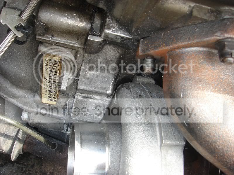

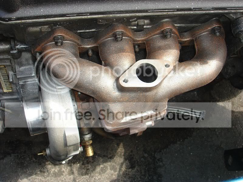

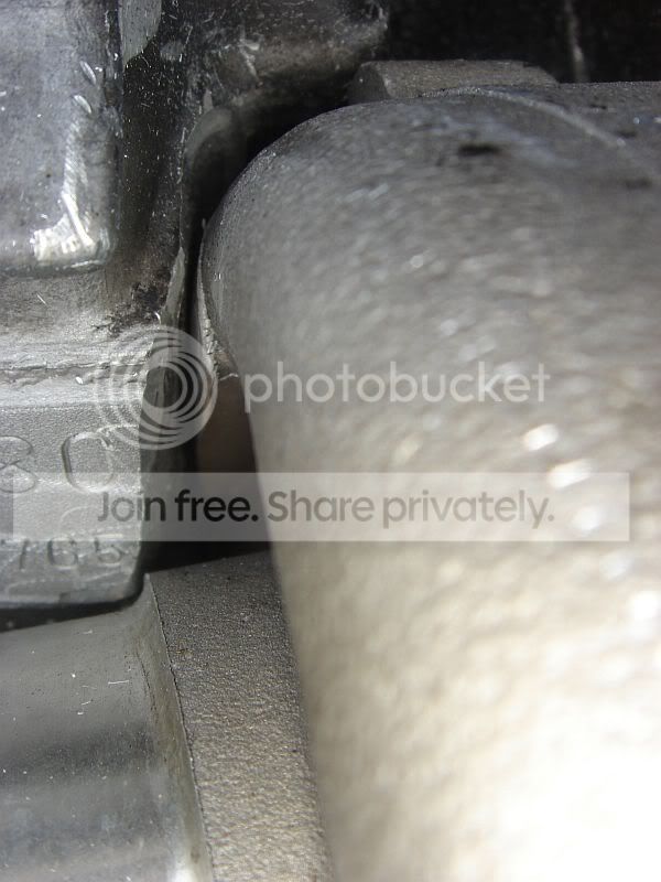

Here is a little write up for you.
The t3/t4 will not fit wit ha cast manifold. Pics provided
Look at all the shaving I did. Shaved the block AND the turbo housing.
