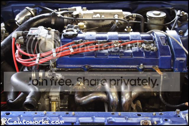

We just did one, we did NOT do the charge piping though or mount the intercooler. Pretty easy setup, nothing really hard about it. Blow off valve can really be placed where ever you would like it to be, near the throttle body or closer to the intercooler.
http://www.rcautoworks.com/Adils.htm
Did a 3 inch downpipe and did not have to cut the crossmember

Nice wastegate placement, that looks really cool

<TABLE WIDTH="90%" CELLSPACING=0 CELLPADDING=0 ALIGN=CENTER><TR><TD>Quote, originally posted by JoePSI &raquo;</TD></TR><TR><TD CLASS="quote">
Nice wastegate placement, that looks really cool </TD></TR></TABLE>
you know that is an ebay manifold right?

thanks for the pics that is really goin to help out. so as long as you have it close to the throlttle body it really doesnt matter the position? i was under the assumtion that if it was positioned wrong then you would get boost creep? also do you think it is possible to keep the original radiator? or do i have to get the half civic one?

<TABLE WIDTH="90%" CELLSPACING=0 CELLPADDING=0 ALIGN=CENTER><TR><TD>Quote, originally posted by SOHC_MShue &raquo;</TD></TR><TR><TD CLASS="quote">
you know that is an ebay manifold right?</TD></TR></TABLE>
The picture he quoted is, customer came in with the ssautochrome setup, let with out setup.

My integra is a 91 turbo and my SSautochrome header is in perfect shape, no cracks or anything.
BTW, I didn't buy all the turbo components so don't flame me. Although the eBay parts did get the car into the 13s.
