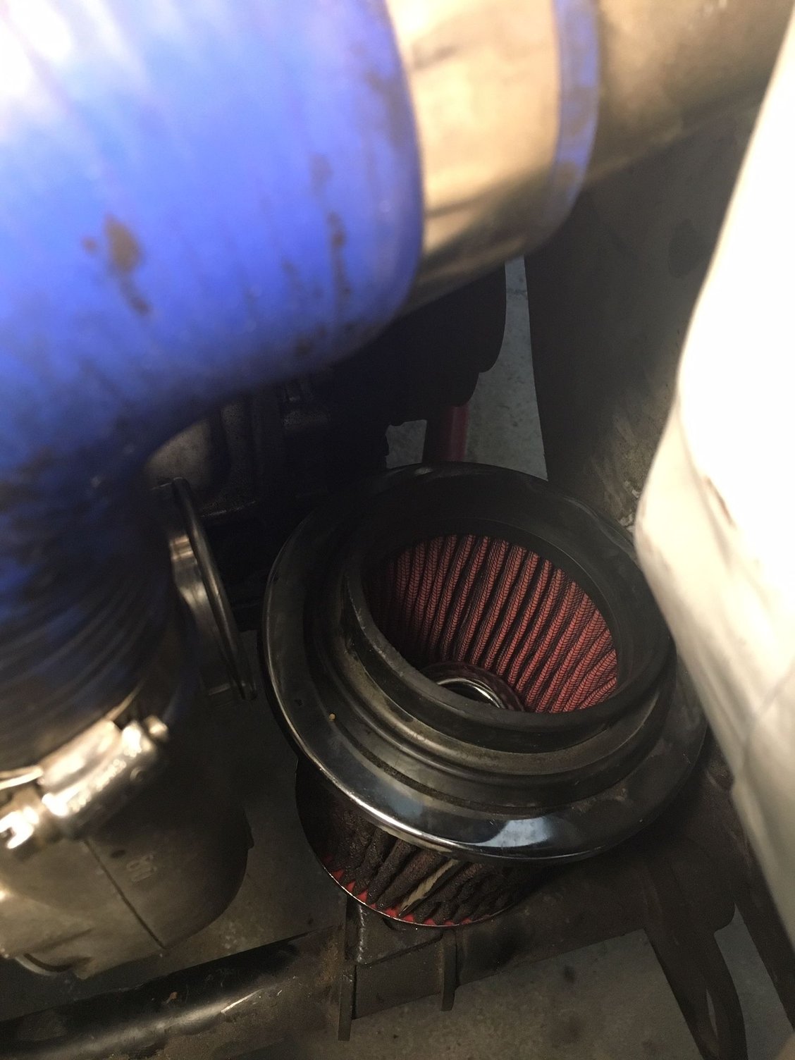

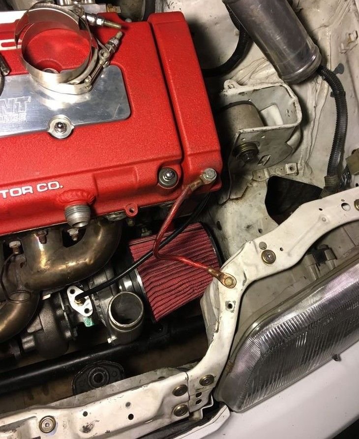

I have the universal K&N filter currently. It is pretty beat up because it does not fit well into it's location in the engine bay onto the side of the turbo.
Should I bother with cleaning, oiling and reusing this filter or is it too beat?
I've looked at some other filter options, for example K&N has a shorter cone filter, but I wonder if the reduction in air flow would hurt performance?
Then there is always the inlet mesh screen option....

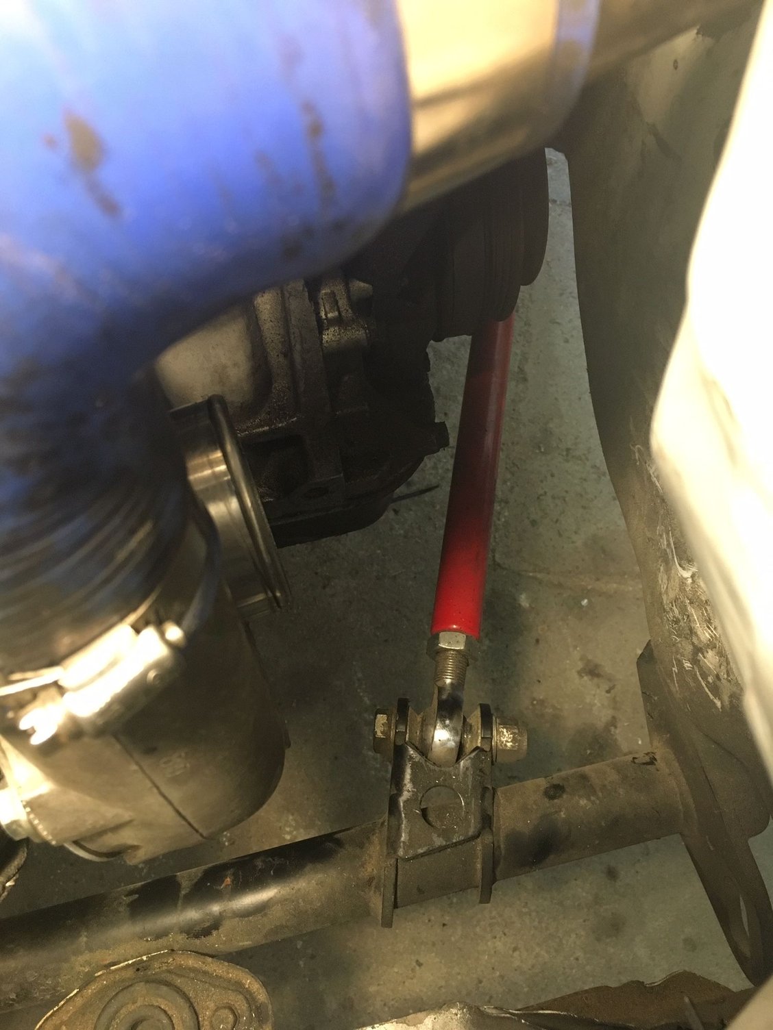

I figured the size probably wouldn't matter too much. But mostly wondering if the one I have, being crushed the way it is, is it a bad idea to continue using?
I have the 6" long one, going to measure and see if the 5" long one will fit better, if not will go with 4". Ideally I would route a pipe to get the filter into a more accessible area, but it is just not possible with how my bay is set up. The charge pipe goes right over the top of it, but was removed here so you can see the filter.

You can just clean the one you have. The cleaner/oil kit is about 20 bucks at most auto parts stores. With the price of that though, you could nab a new one. Up to you. For space, the one I have is perfect.
There is actually enough room now to add a bit of pipe to pull the filter off the compressor housing.

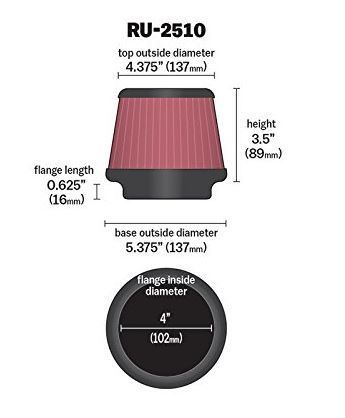

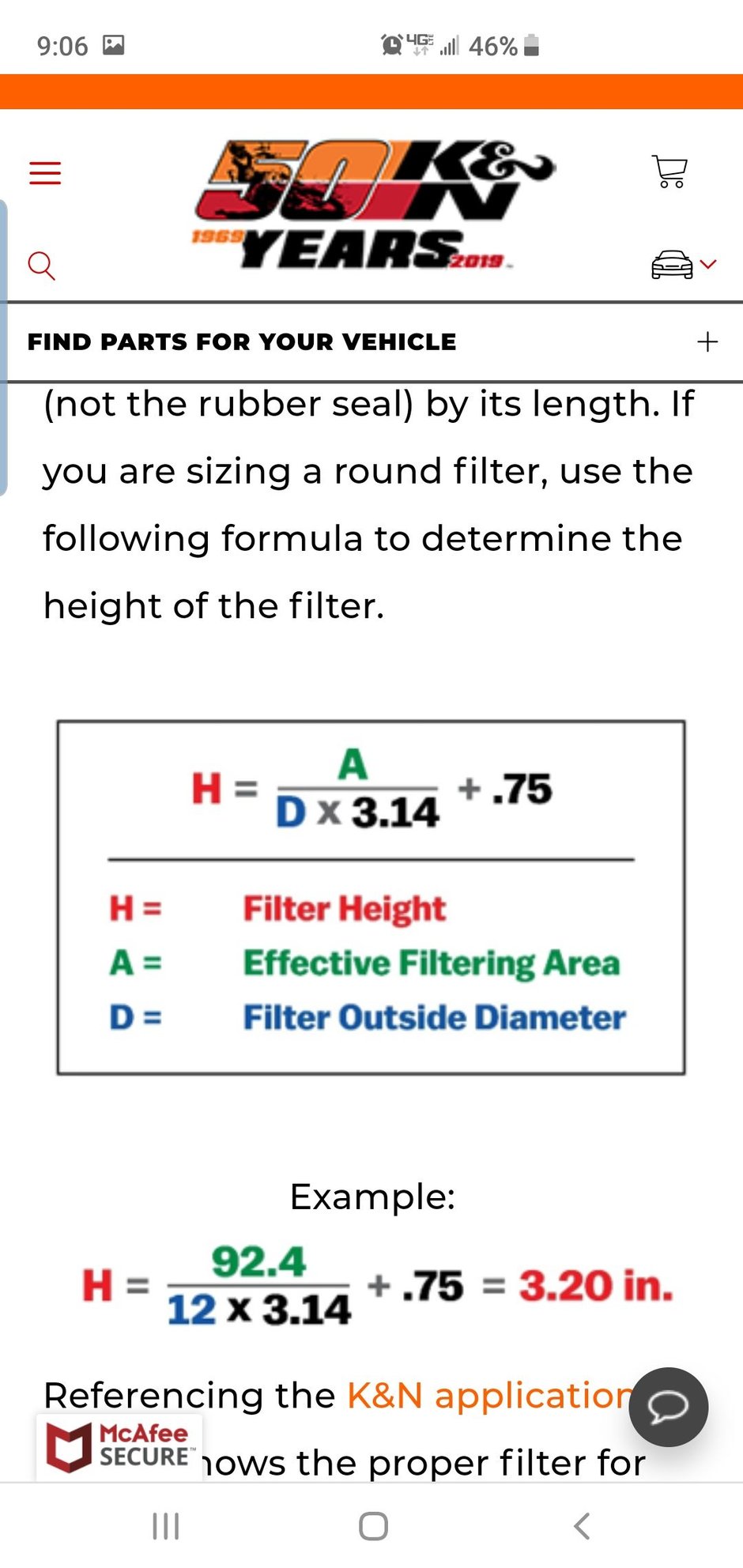

You probably wouldn't lose 7hp if you had a larger filter, these filters you are all running seem pretty tiny. Like others have said, run an intake pipe then a larger filter. I've used various sized filters over the years on non-turbo cars and the larger filters definitely help with response and power. The below should be helpful on K&Ns site.
There is a restriction no matter the size of the filter. On the dyno, with the filter, my car made 317. Once removed, it jumped up to 324. That should clear up your assumption.
Hey, you found the calculator I was referring to! Lol

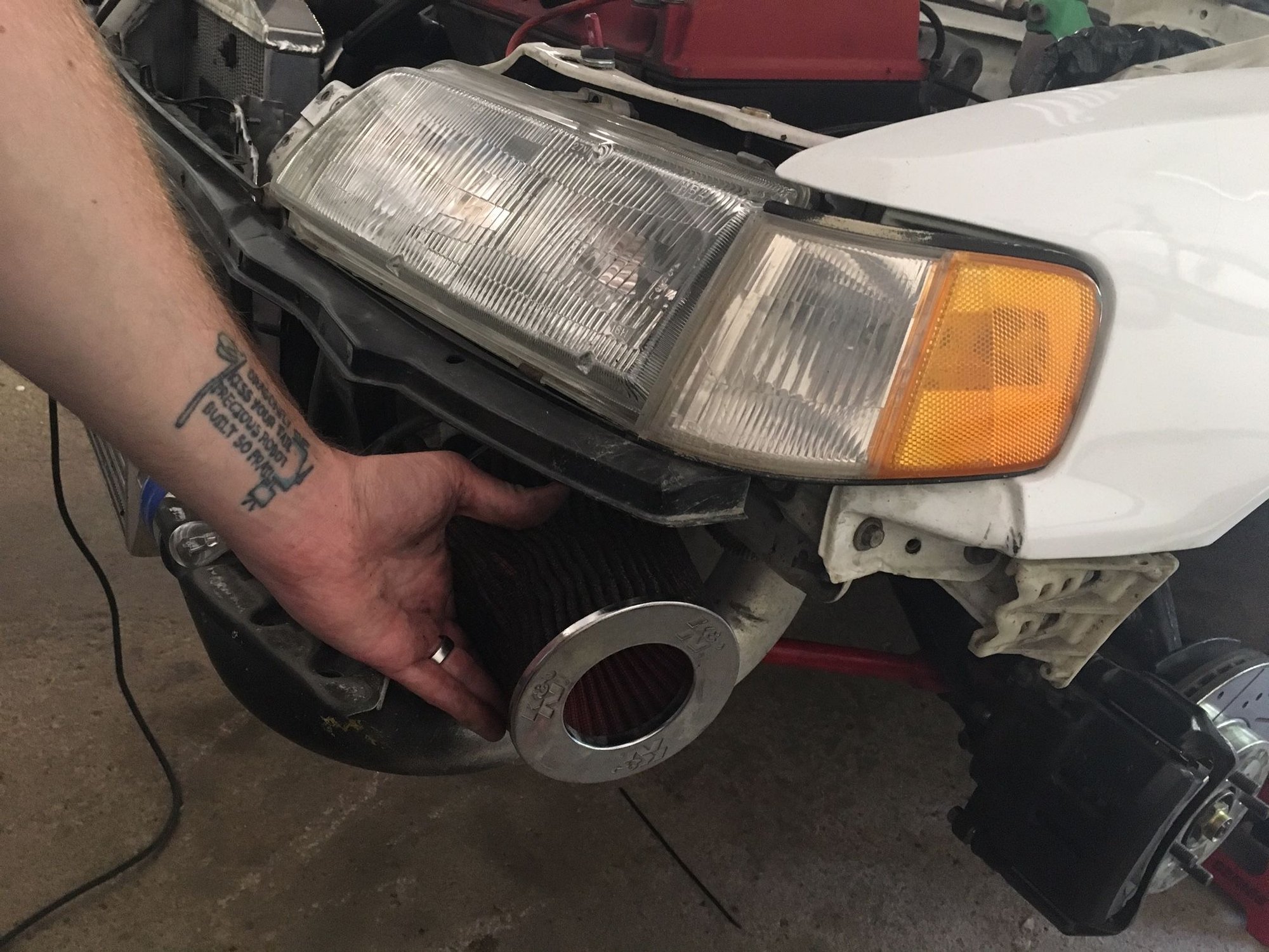

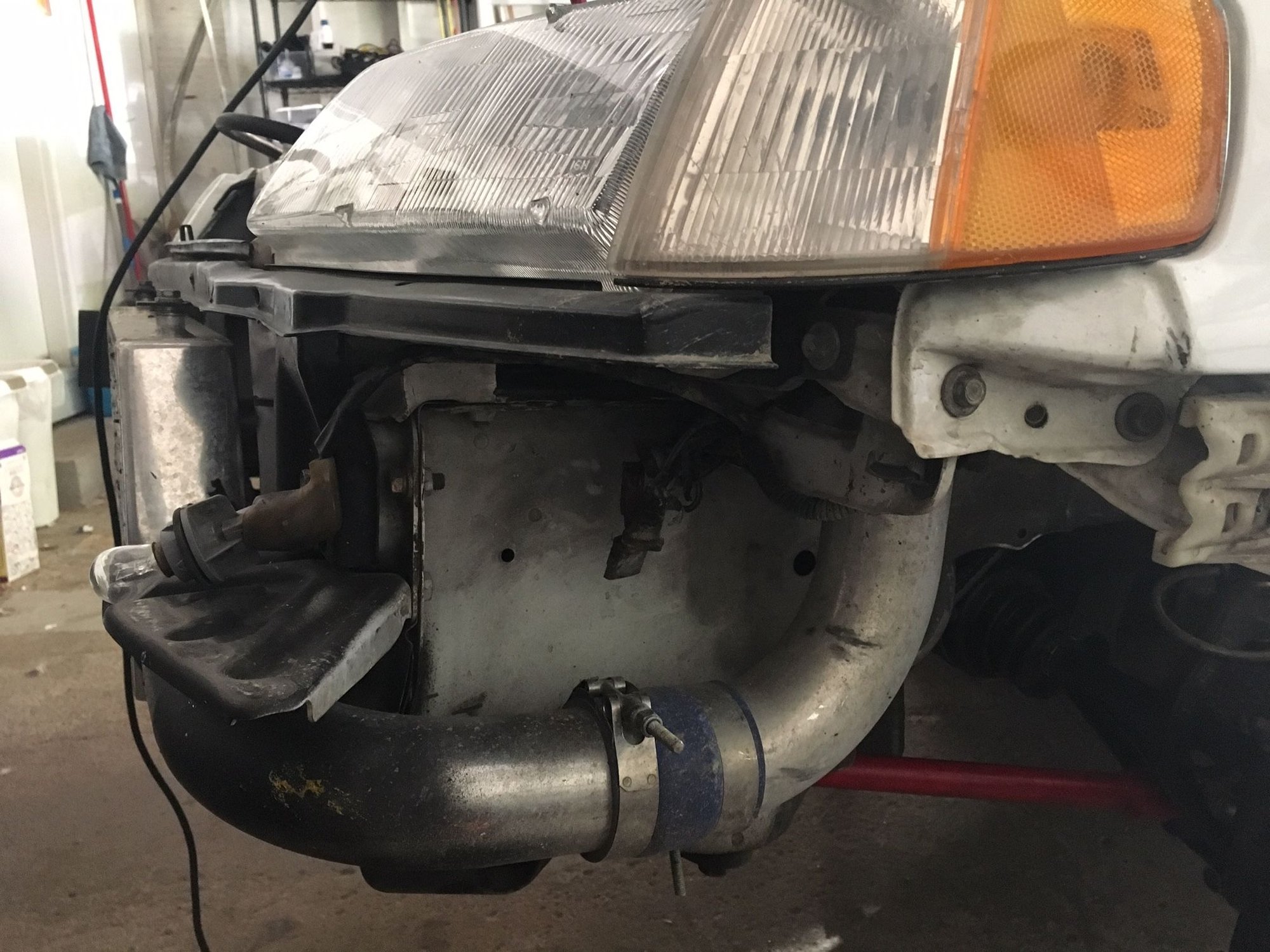

Because I have literally no space to run an intake pipe of any sort to my turbo inlet, nor anywhere to locate the filter other than directly on the side of the turbo.
The simplest way I have figured out how to do it would require me to buy a new intercooler with a single back-door setup, rotate the compressor housing so it blows directly into that, and redo all of my charge piping. Just so I can run a pipe to a filter behind the driver's side headlight. For now, no thanks. Maybe later on.
No. You can point it downwardlike a lot of us do, and use a K&N containment air filter wrap to keep water away from the filter since you have an open engine floor.
K&N Air filter wrap

Unfortunately, either because I have an EF or because of my turbo placement, I cannot. My trac bar is directly below the turbo inlet about 4", by the time I even get a 90° elbow on there I'll be running into it. There simply is no space to route any sort of pipe, and barely enough room to fit a filter alone.
One idea I have toyed with is putting the filter under the drivers side headlight behind the bumper cover. But, I would have to blow a 4" hole through the chassis frame and this is structural to where my trac bar mounts so I'm not sure it's a great idea. It also would require some funky piping to get over here.
For now I am looking at the smaller K&N options and trying to find one with a 2.75" inlet size to match my turbo. I've had some issues with the universal one because the smallest coupler size is meant for a 3" so it is hard to get it tight.

I used a 45* 4" diameter intake only going down about 6" due to a similar issue. It points it right past your traction bar towards your wheel well. You don't need a CAI, just something to help with spool characteristics, as you only need a couple of inches in length to be effective
