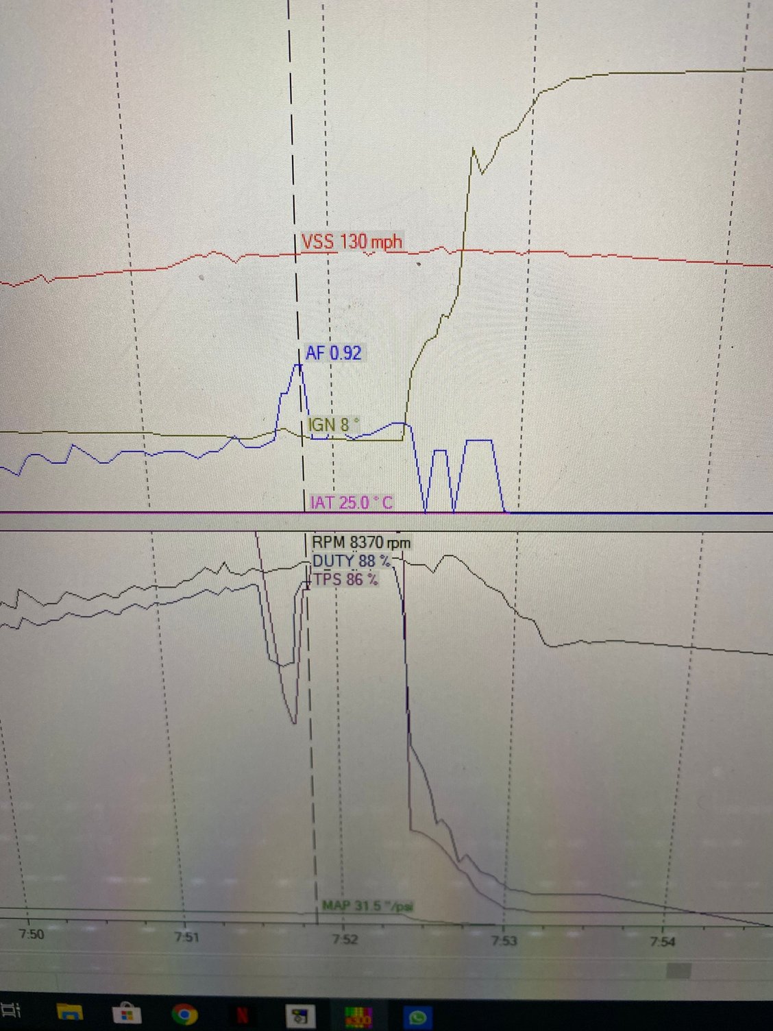

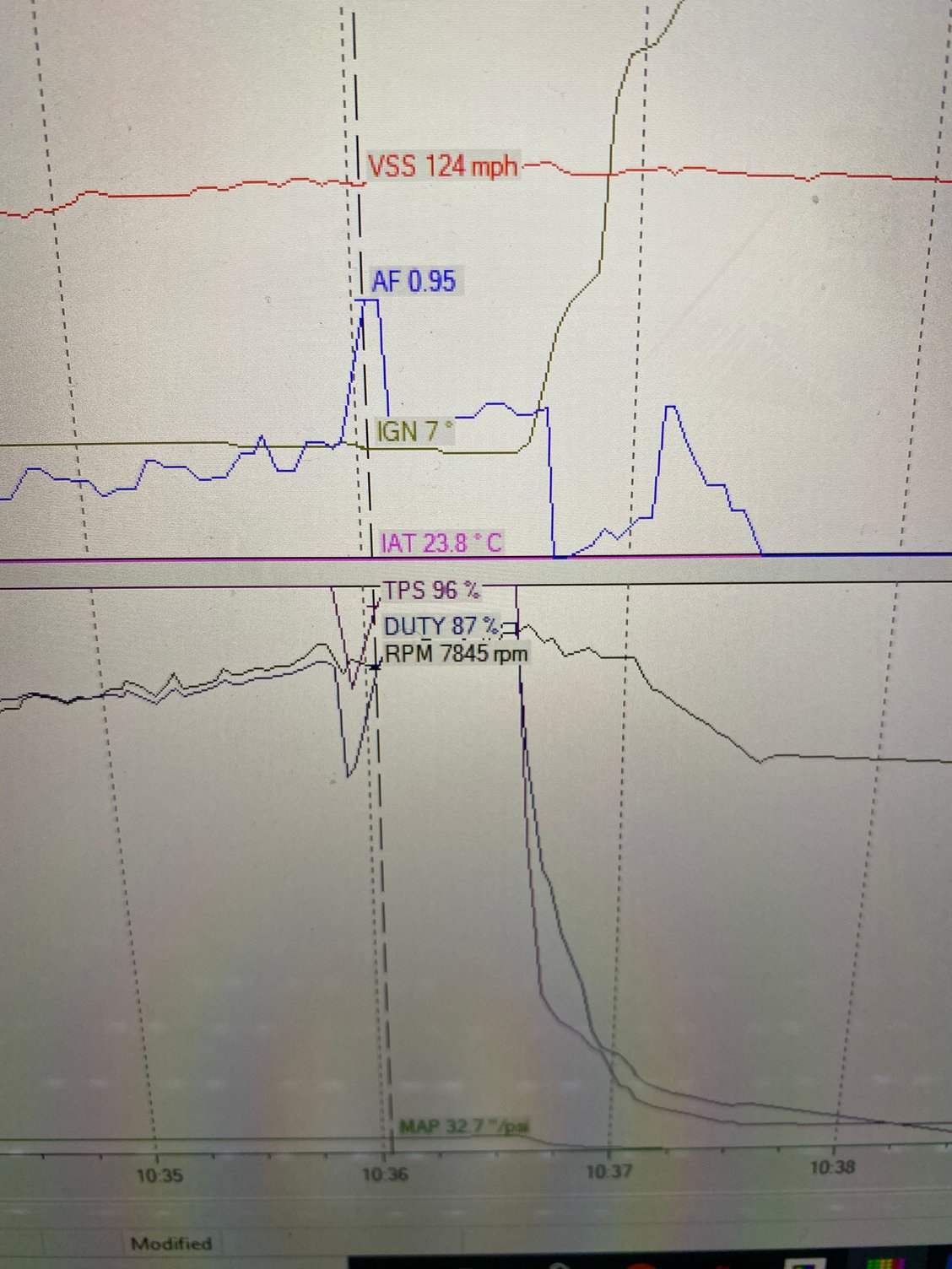

Old Apr 15, 2020 | 07:52 AM
vtisturbo's Avatar
Joined: Sep 2017
Posts: 47
Default Re: TPS Issue. Harmonic Issue? Voltage drop at WOT
Bumping this up. Car is back out again with slightly different setup. Circa 700hp. EXACT SAME ISSUE STILL.
Always seems to be 4th gear at around 7500-8000rpm drops from 101% to 60% sometimes 80%.
This is really ******* annoying tbh. Guess i'll have to try a new TB?
Pics attached.
