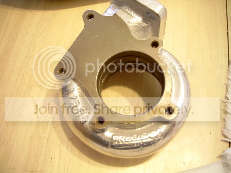

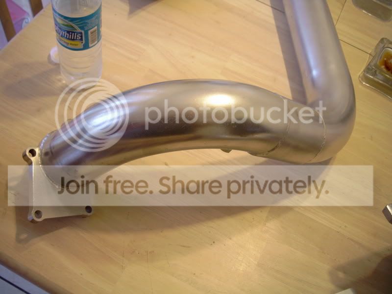

I dont know about that. I know the place I had mine done at does all the local racecars up and both the outside and inside get coated. ( you might be able to tell from my pics) While swain does good stuf I highly doubt they are the only company that can do a good coating. They just got better advertising skills than the rest.
