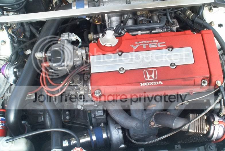

Bone stock B16a with peakboost kit.
The Full-Race kit is a bit overkill for only 6-8psi in my opinion. Like stated prior, you can't beat the price of the PeakBoosts
