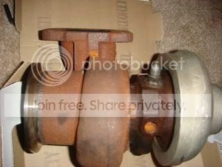

I currently have a t3/t4 50 trim .63 a/r. I put down 180whp 152wtq at 6 psi. However i hate the lag. I dont get full boost until 4.5-5k rpm. I have to down to 4th to past on the highway ops: Theres a local guy selling a t25 with a t3 flange and im thinking about getting it. I rarely drive over 3k so I feel that the t3/t4 is overated. For those that have a t25 turbo, what rpm are you getting full boost. Im looking for a fun turbo to drive with since its my dd.
my turbo
t25

If you only want around 180whp, I would absolutly go for a T25 on the sohc. It will be much more fun on the street for you 6psi is not even in the efficency range of that turbo anyway I dont believe

If you want in the 250ish range on a stock motor, or if you get a built A6 motor, you're going to want to keep the 50 trim.
