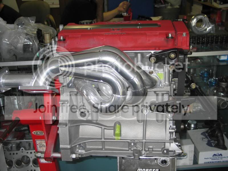

Default Re: Thinking about getting dart b series block??? (Soon_2b_evil)
Hey, not to thread jack, but what mani is that does anybody know, top mount is sweet, and looks like there is room for a/c there, anybody...

Default Re: Thinking about getting dart b series block??? (jayman322)
Looks like a Lovefab sidewinder.
IMO not worth it at all. So many cars are making such big power on sleeved stock blocks that I see no need to shell out so much more money for a dart block. If a sleeved stock block is good for the fastest street hondas in the world it's good enough for me.

definately not a v2 sidewinder, doesnt look love-fab at all, it usually had runners different than that, if so, the v2 is not an improvement, that one is compact, perfect why change

<TABLE WIDTH="90%" CELLSPACING=0 CELLPADDING=0 ALIGN=CENTER><TR><TD>Quote, originally posted by jayman322 &raquo;</TD></TR><TR><TD CLASS="quote">definately not a v2 sidewinder, doesnt look love-fab at all, it usually had runners different than that, if so, the v2 is not an improvement, that one is compact, perfect why change</TD></TR></TABLE>
V1, yo.
