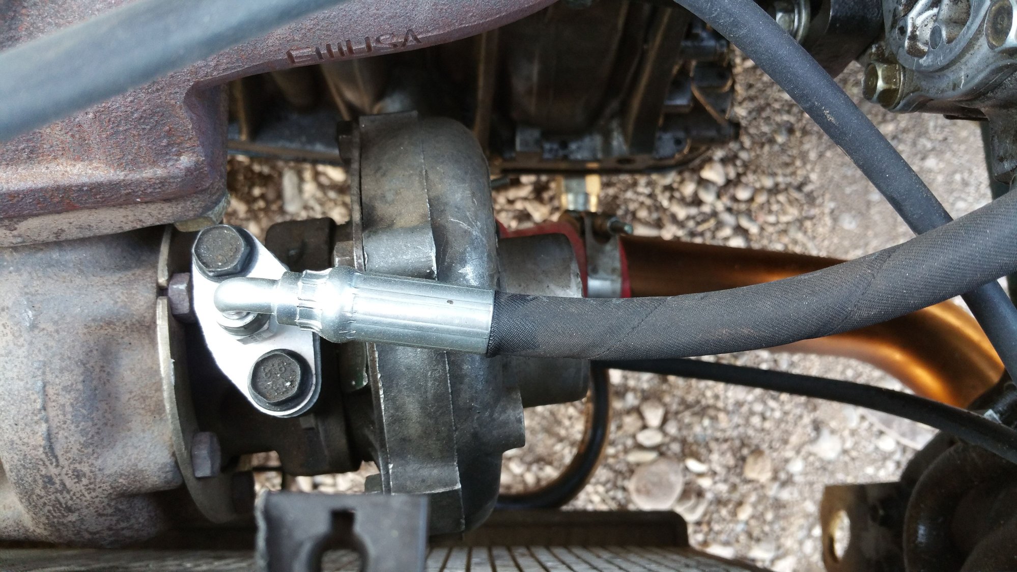

Default Re: Is there a downpipe with a dump pipe for the wastegate?
That 90° is expensive but makes it look clean.

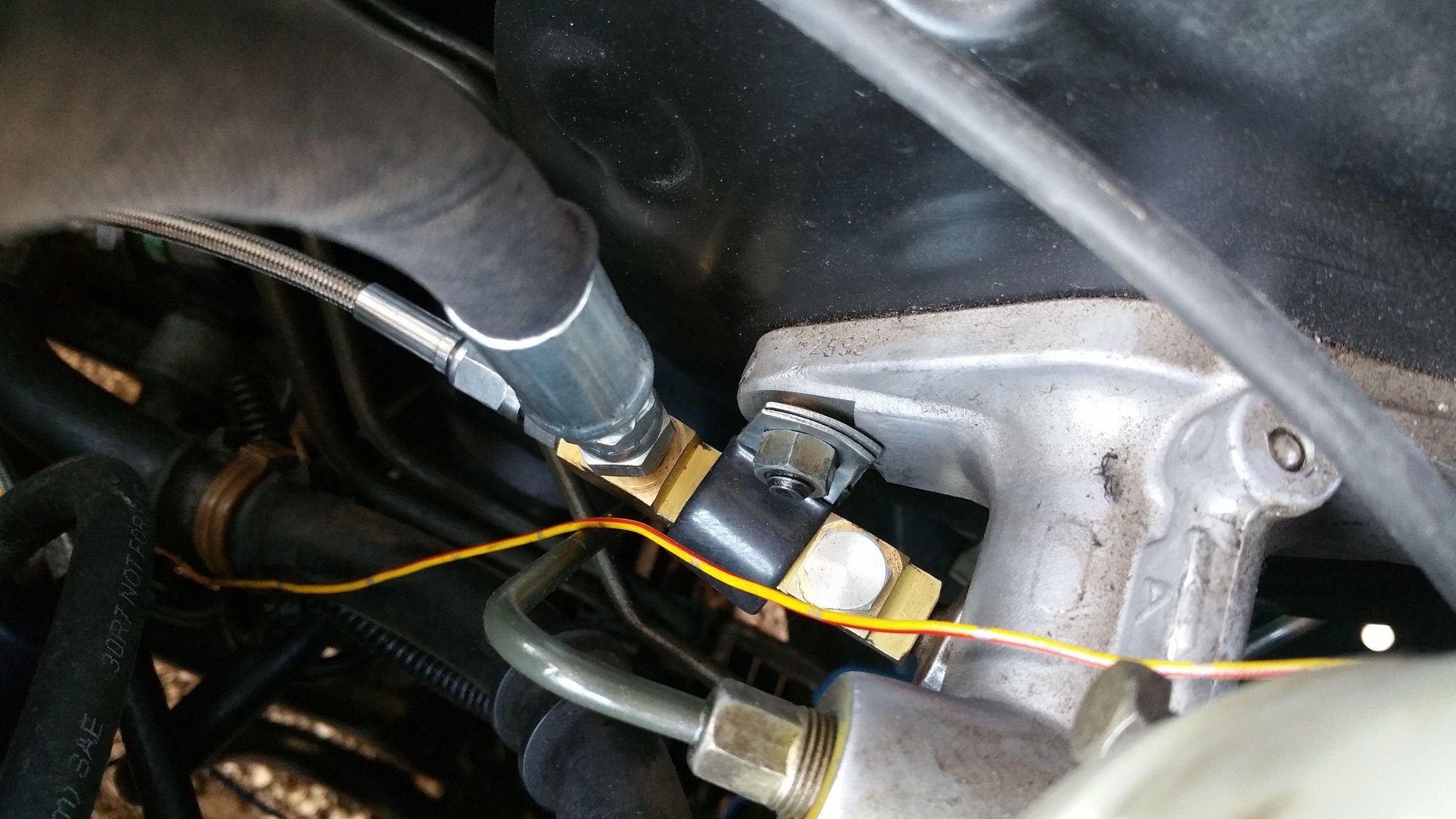

Best place I could find to mount the oil distribution block. Looks pretty nice I think.

From: montebello, ca, us
That oil line looks huge
Are you running a restrictor?
Old Mar 20, 2016 | 04:26 PM
teh_touch's Avatar
Joined: Mar 2013
Posts: 18
Yes. The flange fitting has just a pin hole in it. When I first took it off the turbo, I had to do research on why it was such a small hole. I had no idea a turbo could have too much oil. Haha.
Old Mar 21, 2016 | 02:55 AM
LightningTeg's Avatar
Community Builder
Posts: 5,325
Likes: 22
From: Indiana
Yeah you'll want to stay away from those style fittings. The oil will want to cling to the roof of the fitting and ultimately not provide the turbo with the proper oiling.
