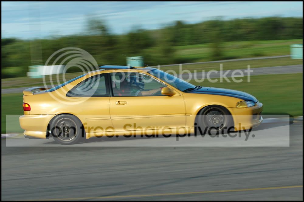

So I did two sessions last monday... it was a BLAST of fun to drive and I didnt have any mechanical issue. Of course it take a really good car in good shape and well prepared.
Here is what I learned.
Never start with only 1/8 of tank... in the last session I was beginning to suck air in the tank during cornering I had to stop.
Never stop without doing a few cooling lad... the temp of my engine raised really fast and my overflow bottle was full... but after letting the fan on... all beacame normal.
10 psi ( +- 250whp ) was more than enought to get in front of a STI with some mods. All the other cars were out of the game even if they were excellent driver for some of them.
A performance brake pads like my Cobalt GT sport are not enought for my power level... should be good for a Type R by exemple. I need some Hawk black for the track.
I need a rear sway bar. ( progress 24mm adj. on is way )
My Omni sport are really not bad at all !!
I need some alignement adjustement and adjustable camber kit on each corner.
Here is two pics :
Me during a pass in the braking zone after a small straight line

Looks like you had alot of fun! Glad it all went nice and smooth for you.

Looks like you had a lot of fun man! If I had the $$ i'd be out doing this in my turbo sohc as well. Is it fairly easy to stay in higher boost with that turbo on a road coarse or does it fall out of boost often?

Is this road racing? Without the cones, I mean.
If so you are my ******* hero. I've always wanted to do something like that, only in a F1 or supercar.

I like how the guys crowd around the hatch with the weird paint, gaytezzas, 19's, and I'm guessing a chrome'd out b16.
Sounds like a kickass motor, I'd hope cooling would be the only issue. I'm curious, how'd the other drivers react when they learned they got spanked by a SOHC? Same for those seeing it before you ran them?

anyone notice there is nothing but hondas in the parking lot
nice car btw, sounds fun

Even the truck...lol. Great pictures.
How were your brakes for fade? What fluid, SS lines? And how were the Hankook tires for wear (lots of laps?)...
IMO any street pad won't last for more than 20 hard laps on a big track... but real race pads can make you fill your shorts on the street, esp if you get any "real" winter weather or at the highway off-ramp if the brakes cooled off. Funny how my quickest corners at the track usually resemble long, sweeping right/left off-ramps, just like the one I get off every day at work... I try to pretend I don't notice my wife pulling down the grab handle a few seconds before I get there everyday...
